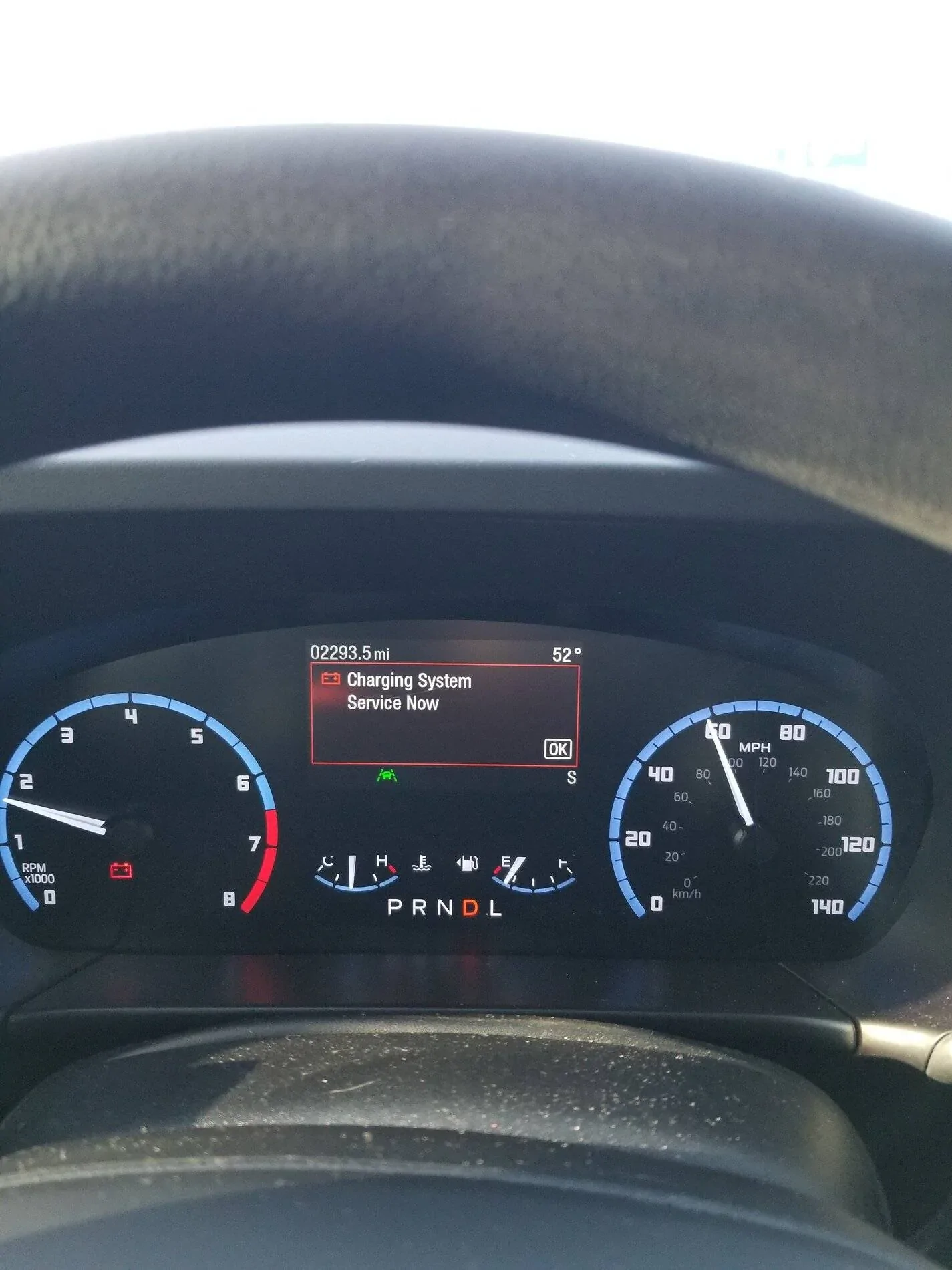

Battery Charging problem 2,293
BroncoJ
Mar 15, 2021
Ohio
Broncosport
2299 14s411 male and female water intrusion/corrosion confirmed customer complaint of charging system light on. scanned for codes found p06a0, u012d,u0284, u042e. checked oasis found SSM 49496. removed wheel wheel liner and pcm brack to gain access to connector c202. upon inspecting c202 found corrosion and water intrusion in both the male and female sides of the connector. necessary to replace both the male and females sides of the connector due to excessive corrosion in both. replaced both male and female sides of c202, part of wiring harness 14290 14305. re installed both everything removed to gain access to connector. cleared codes and re test pass
