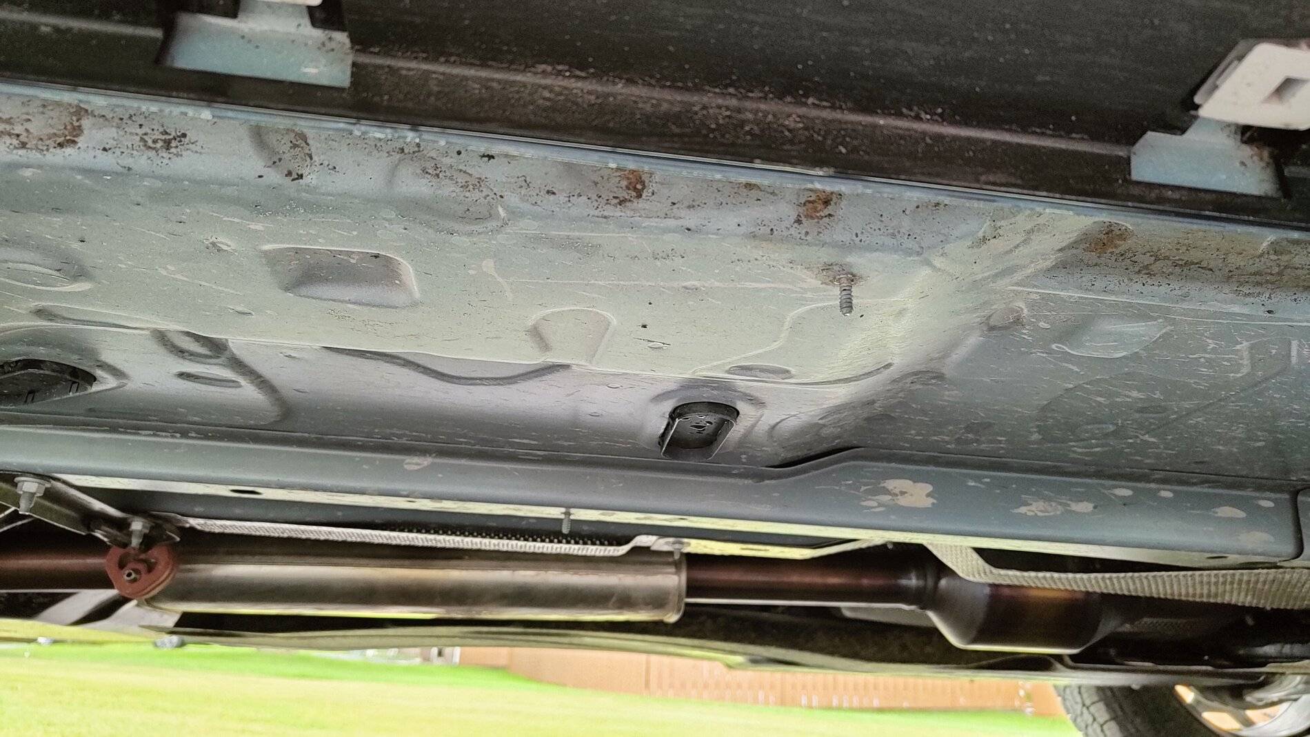

Please post if find any . I damaged the factory underbody liner, though I would crush a thin layer of ice over a puddle. Turns out it was 2”+ thick. I went thru it and had to get pulled out. I am new to driving off of pavement, you live and learn as I always say.

There will have to be a different mounting method for the Skid Plates also , I had the Engine compartment one off already & its held on with clip on fasteners . A skid plate worth its salt , would be bolted to the Frame rails or other hardened points . I would also like to see a photo of the under belly of the BS with Skid protection .
The after market I'm sure is gearing up on this stuff already , as some posts on different threads here have already discussed .I don't plan on taking my BS Rock climbing , but after looking at what is under there , I want something better . The covers may be good for wind tunnel air flow , but I see no protection from that material even from a lot of road use in the rain . Not exactly sure what that material is , its like pressed treated cloth .
