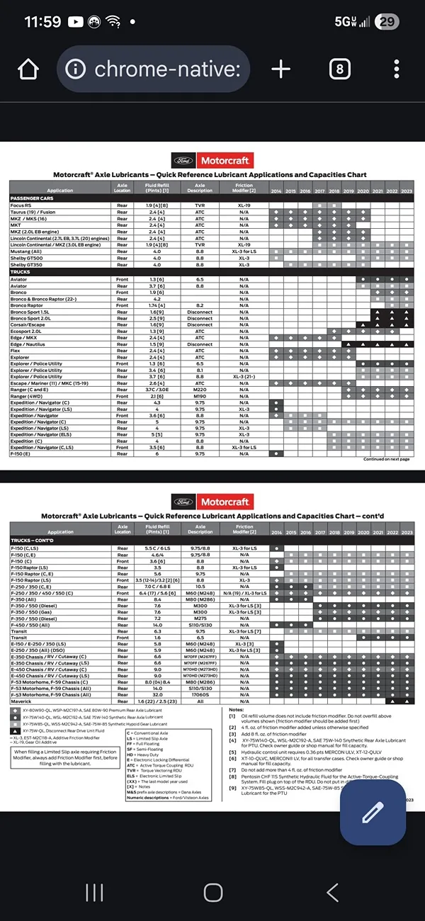

So here is a link to the axel.lube chart:
https://www.fcsdchemicalsandlubricants.com/resources/quickreferencecharts
Make sure and do the axle lubricants, quick reference..., link.
I also put a picture of the chart but you need to pay attention to the fine print in the corners to and I think an icon when I took the screenshot on my phone was blocking part of it.
It's not a hard process.It's just getting the fill plug back in After you're done, can be a little tricky as well as you have to have a pump to get the fluid in there kind of like when you do the p t u. But because you're not using this axle all the time, I don't know if you need to do it every thirty thousand I would just say, you know, at least every thirty thousand though you want to take a little bit out and check and see what it looks like.I don't know how accurate that will be because you know, debris and stuff could flow to the bottom.And you might think you have clear fluid, but you don't, but I would say, that's better than doing nothing, at least or you could always just drain it and if it's good, put it right back
