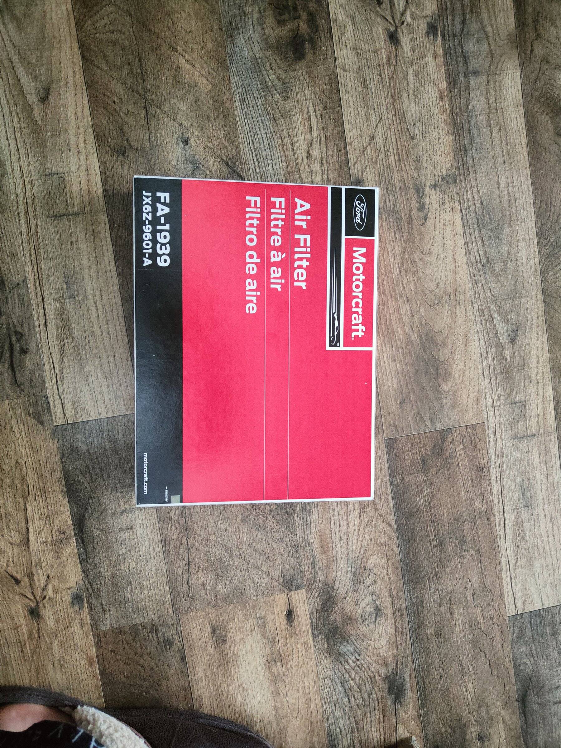

Time to change mine.
Ford Bronco Sport Badlands Air Filter IMG20220205152149
