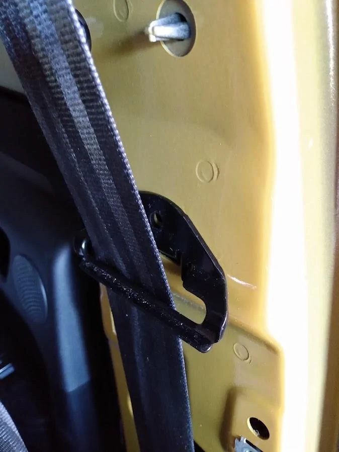

It wasn't always there. At some point the car developed a quiet clunk sound on the driver's side. Eliminated a bunch of things by trial and error. Loose trim. Speaker mounts. Door panel. Exterior plastic panel. Rain vents / wind combo. As the sound slowly drove me down to madness, I narrowed it down to something in the pillar by pressing my ear right to it while driving. Tensioning the belt and pressing on the panels had no effect so I had to do a deeper dive.
By removing all the panels, I thought at first it was the door harness where it contacted the inner panel. But it turns out it is this weird metal guide piece for the seat belt doing it. The way it was covered in dust and fuzz, I think it must also be part strop. When Ford built the thing, this metal tab was hung on the frame and then it is all held together with a plastic pin. You know, why use actual hardware when you can press in a plastic plug and send it? I'm guessing over time, the plastic pin lost a little bit of grip, allowing the piece to hit metal to metal and make the sound. Normally, one might insert some kind of dampener in there. But you know, Jim Farley can't possibly spend the $0.001 for a shim, times are tough!
Ford Bronco Sport B Pillar rattle sound FIXED IMG_20240718_093805169

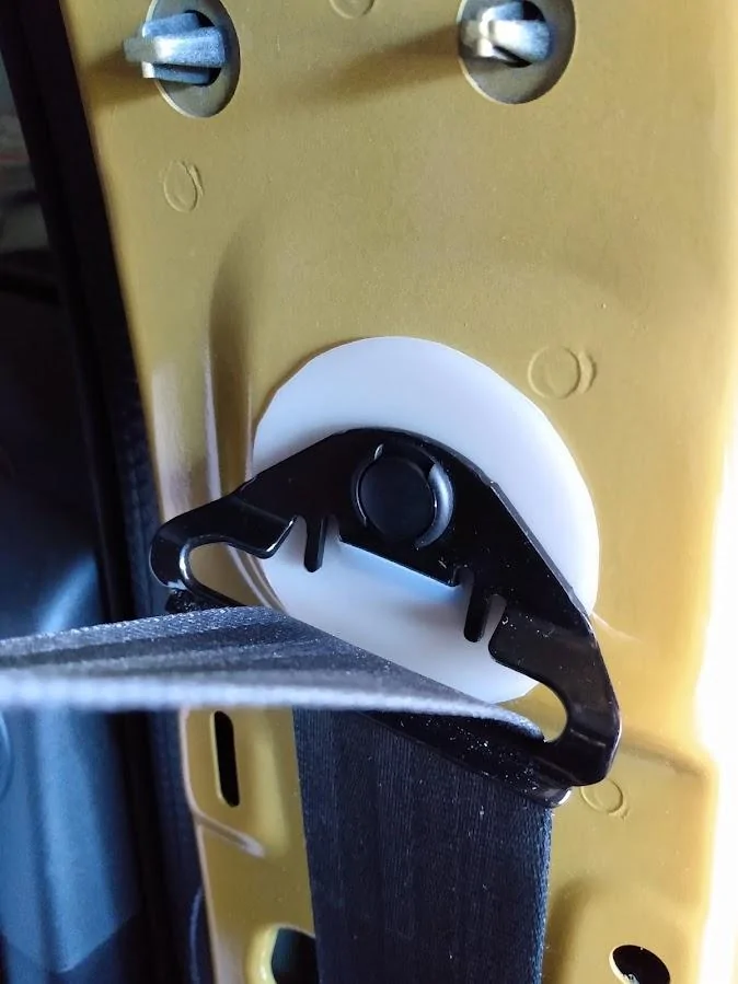

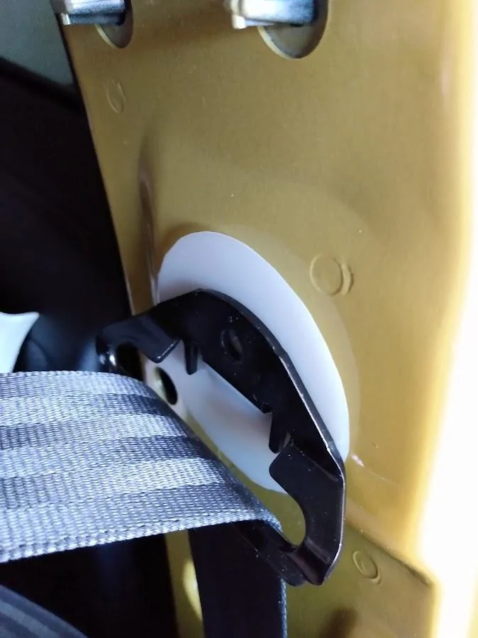

Now comes the technical part. I needed something to put between the guide and the body. Something that would let it move slightly and not deteriorate. I looked at foam and cork and then plastic to get it thinner and "slipperier". I settled on a 1 gallon milk jug in the recycle. (Sorry Canadians, you'll have to find something else.) It's that sort of slick PET type plastic. I used the boxcutter and scissors to cut out that pre-drawn circle spot on the side. One jug is enough material to do both pillars if you want to. I lined it up and eyeballed a spot to cut a slit for the tab. I put it all back on the pillar and used the awl to make a hole for the body pin.
Ford Bronco Sport B Pillar rattle sound FIXED IMG_20240718_093841813
First tap the base all the way in, then get the center in. I used a small finishing nail hammer. Here it is before I put all the trim back.

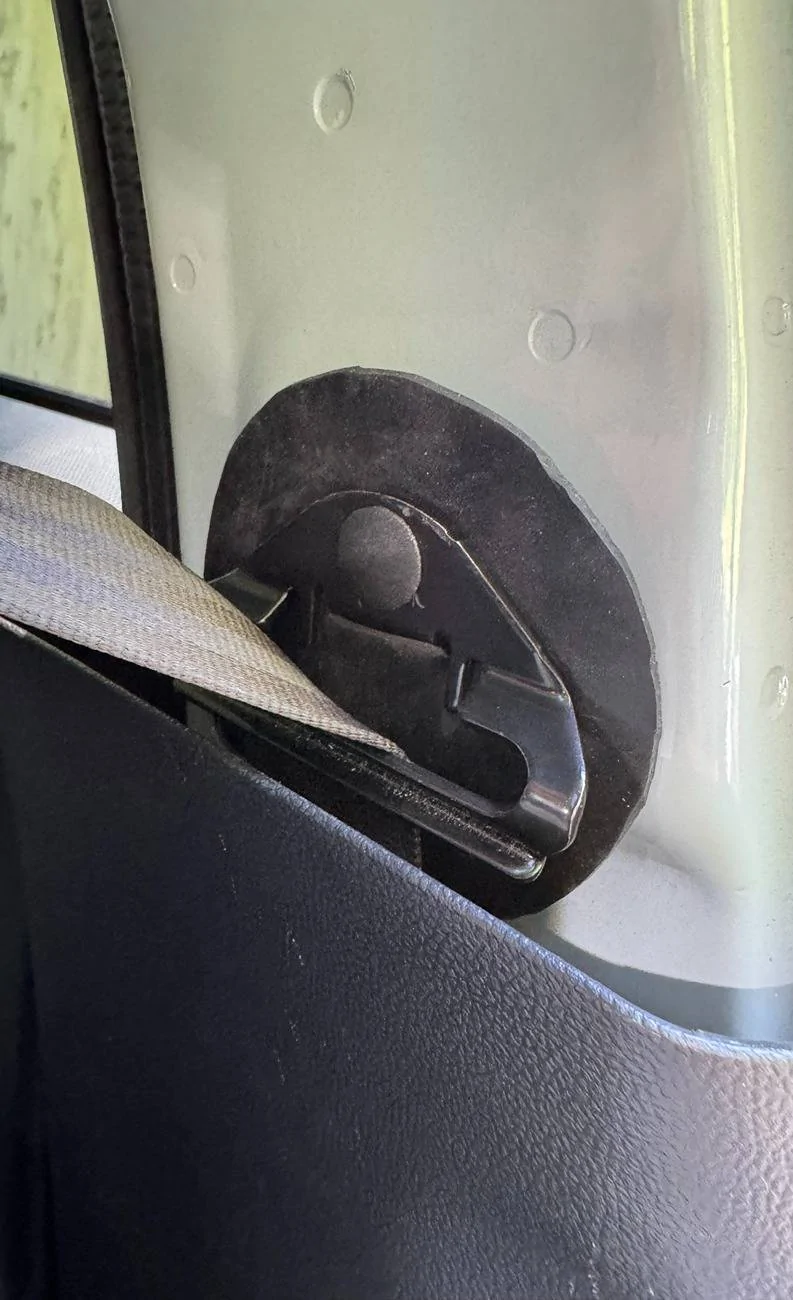

Well, after two headliners, three seatbelt adjuster replacements, several weeks of cumulative out-of-service time, countless test drives, a visit from a Field Service Engineer (FSE), and being told at least a dozen times that "it's fixed"—only to hear the rattle come back 100 feet off the dealership lot—@Glamdring70 , your solution did the trick.
Total cost? Less than $20.
  • $12 for a set of 240 clips (wish I could’ve just bought one),
  • $7 for a 12" x 12", 1/16" thick sheet of closed-cell neoprene (used instead of a milk jug),
  • Plus about an hour of my time (priceless).
Problem solved.
As a side note: to save time, you don’t actually need to remove the rocker panels and lower B-pillar trim if you don’t want to. You can simply—and carefully—pull back the upper right corner of the lower B-pillar trim to reveal the 8mm bolt securing the upper trim. Remove that, then carefully remove the upper trim.
I’m astonished that after nearly three years of trying to isolate a clearly metal-on-metal rattle from the B-pillar—one both my service manager and I agreed was real—not a single person from Ford or the dealership thought to look at or mention the obviously loose metal tab sitting directly on the metal frame of the B-pillar, just below the seatbelt adjuster. I even mentioned it after reading this post and the response? “We didn’t look there because Ford doesn’t make a part to shim that up, so it wouldn’t be covered under warranty.”
This, despite the fact they stuffed my moonroof and headliner full of felt and padding (not Ford-spec) during one failed attempt to fix it. Why they didn’t at least mention this as a possible DIY workaround is beyond me. That they didn’t, even after all that, blows my mind.
Anyway, like you said—now on to the half-dozen other rattles that are extra audible now that this monstrosity next to my ear is gone...
