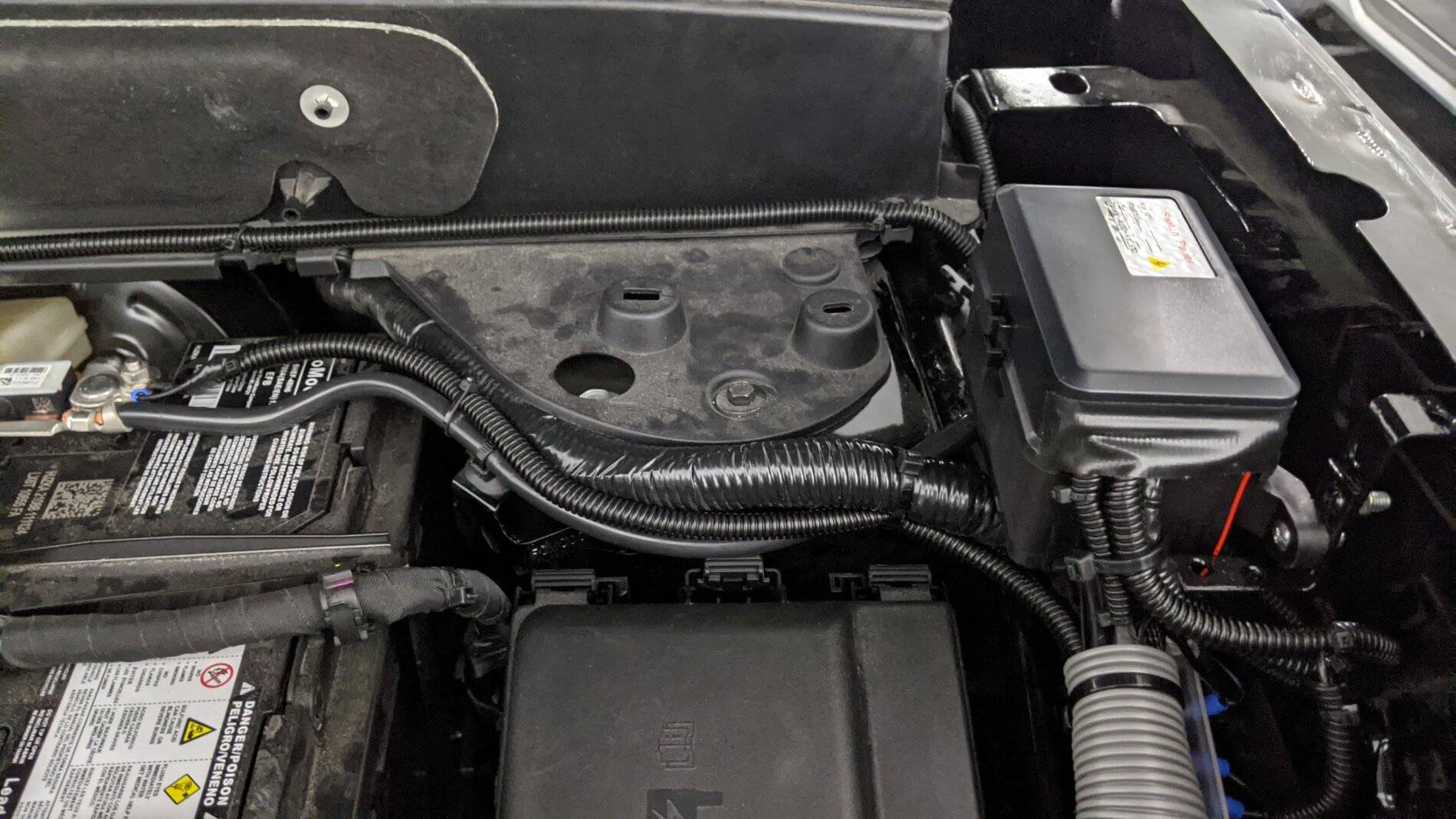

Acc wire goes in passenger fuse area #3
That what I did
I installed mine awhile ago with everything hidden and working, fairly easy with no removing of panels other than the fuse panel
Ford Bronco Sport Auxbeam 6 gang switch panel - where to hook up the base unit ACC connection? PXL_20210913_041542474.NIGHT
