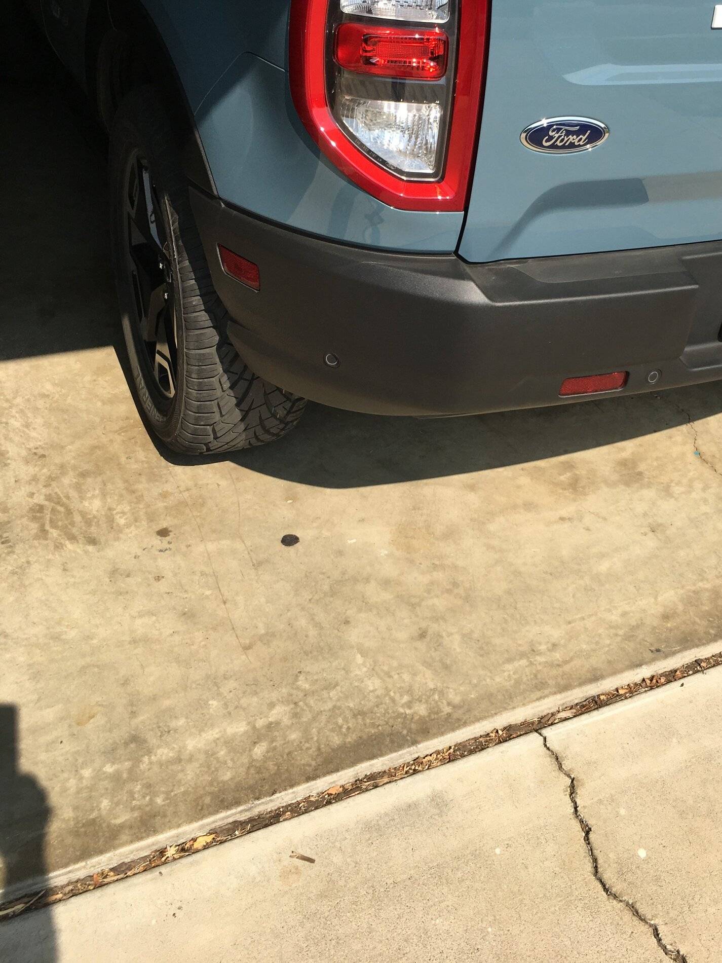

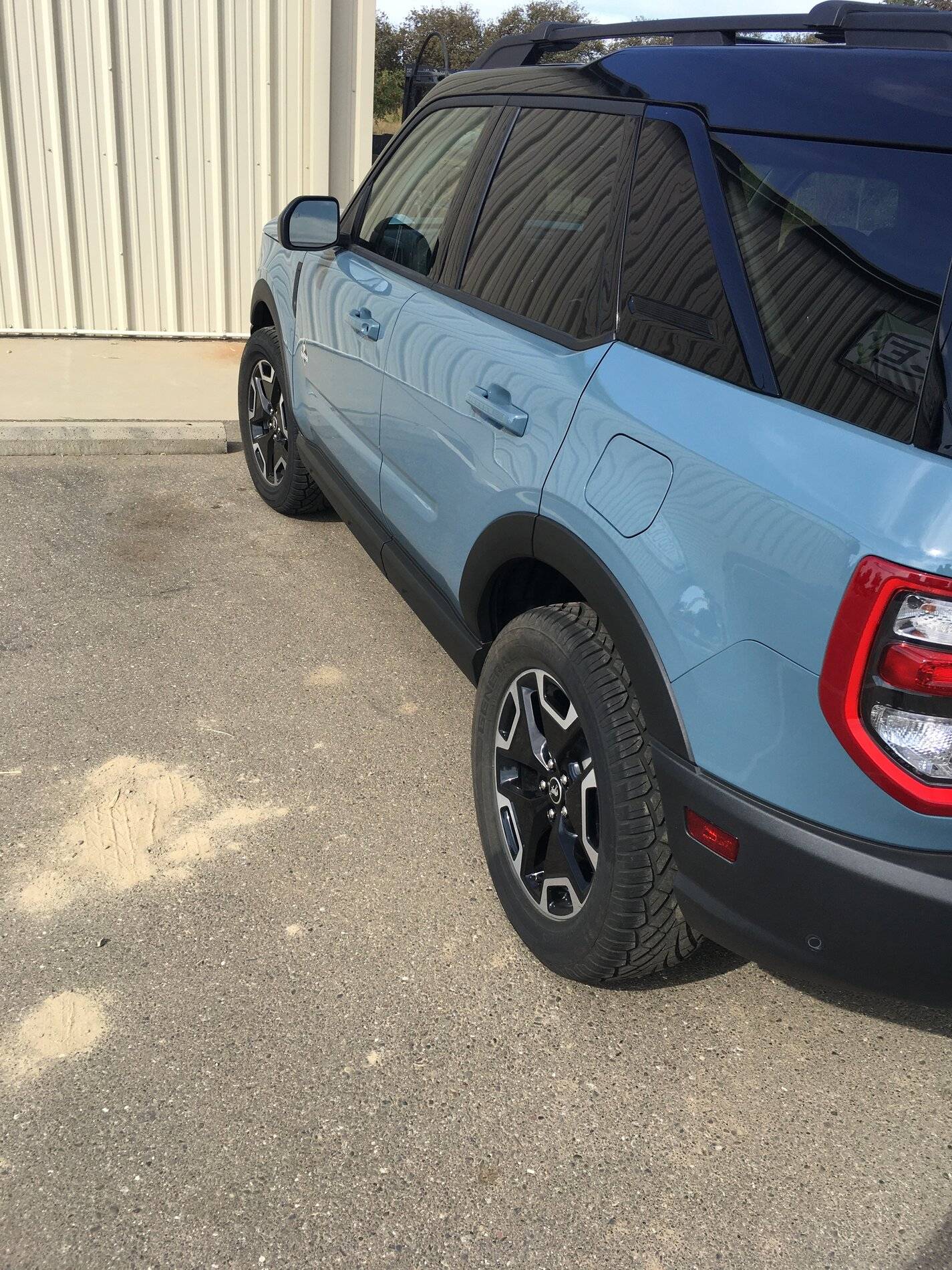

I put General Grabber UHP 255/55/17 on my Outer Banks, I have no lift kit. No rubbing issues even when making full turn. Close, but no rubbing. Anything wider would probably require a wheel spacer or wheels with a different offset.
