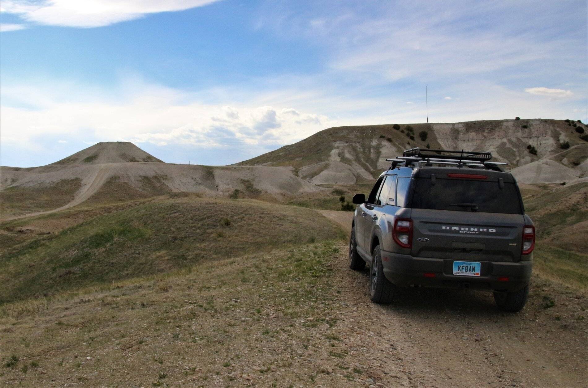

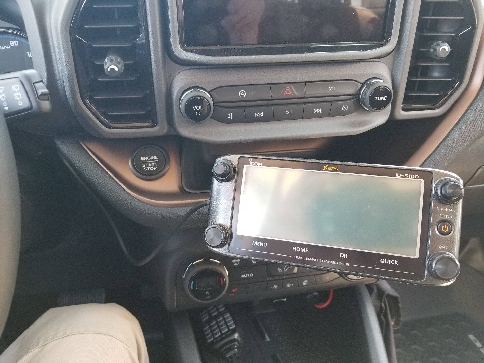

Installed an Icom ID-5100 2m/70cm radio. Radio body is tucked under drivers seat. Control head uses an A-tach mount with magnetic holder. (see pics) the antenna is mag mounted until I get a SUV lip mount for the rear hatch. Power comes from the 12 lighter jack up front.
