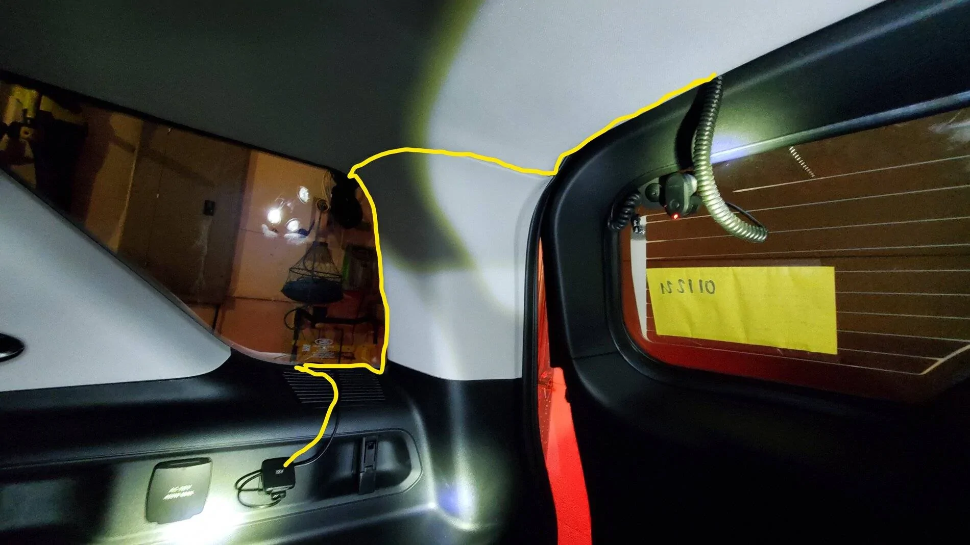

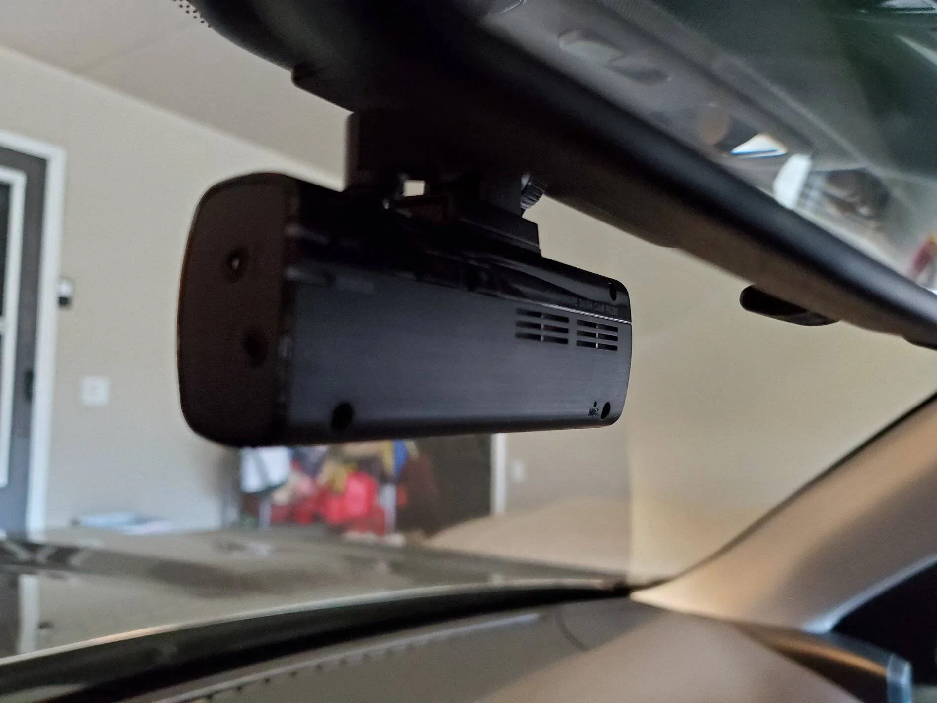

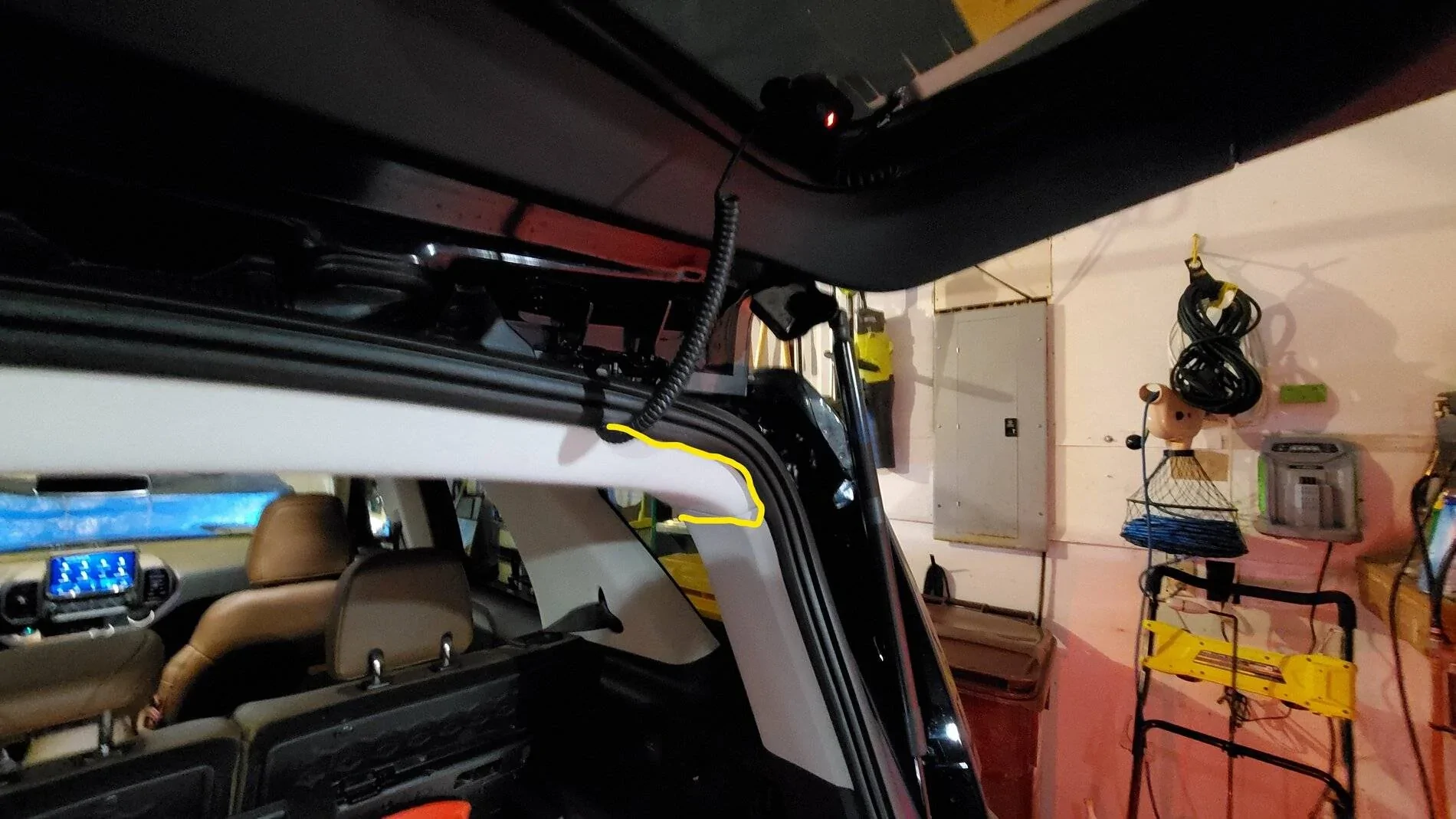

I have a ThinkWare U1000. I really didn't want a block that sticks to my windshield. I wanted something small. But after much deliberation, I decided to go for that. It's not obtrusive to my view or anything, so I'm pleased with it. I stuck the rear camera to the plastic trim instead of the glass because it made wire routing cleaner and easier, plus moved it more out of the way visually.
