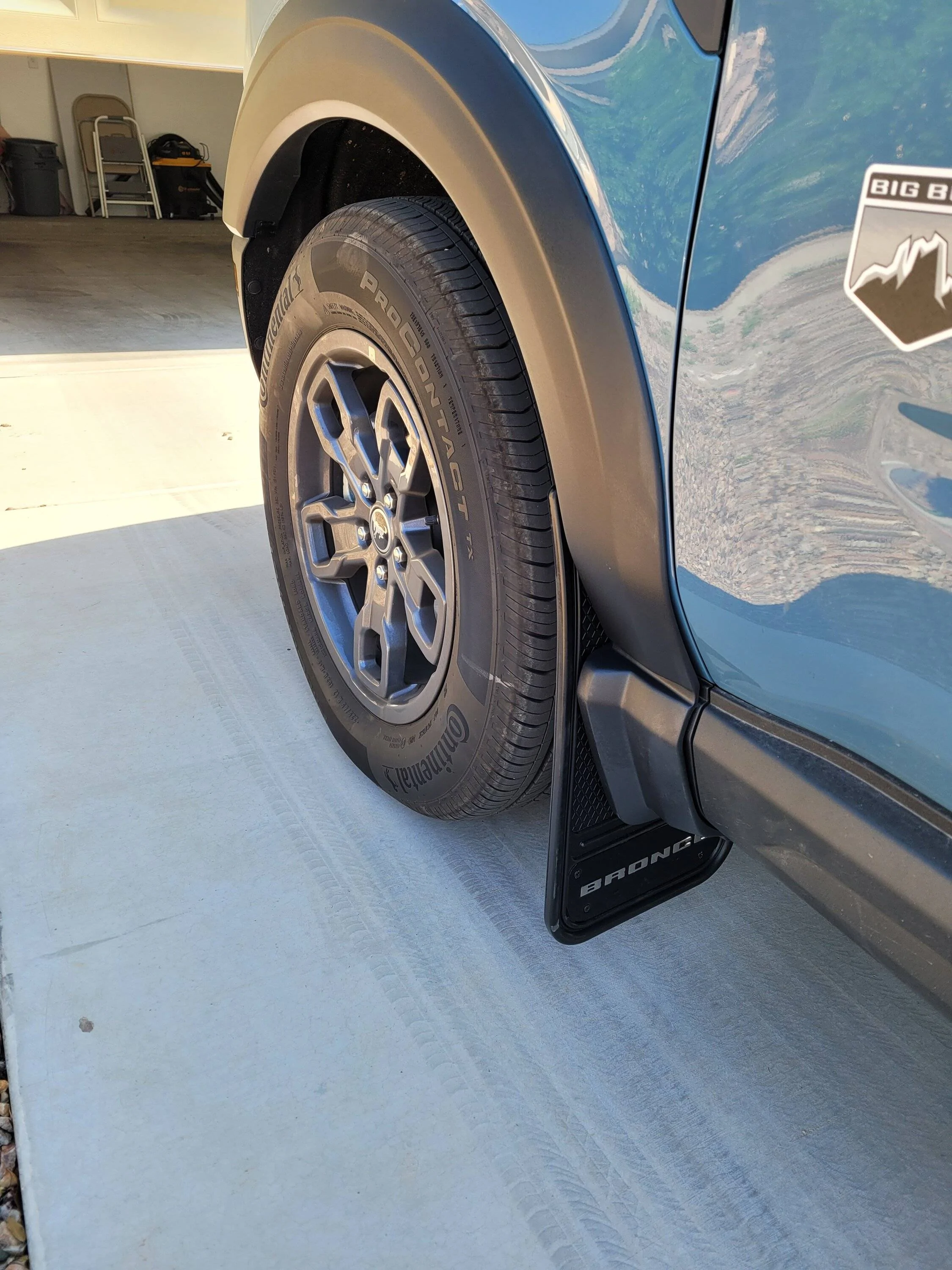

I installed the Air Design flares on my old Big Bend. Didn't have to remove anything from the vehicle before install. They got a healthy coating of adhesive on the surfaces that touched the body. The lip underneath used the same fastener positions that hold our felt liners in place (plus a few extra that were already pre-drilled). It was held on with screws and retaining clips.

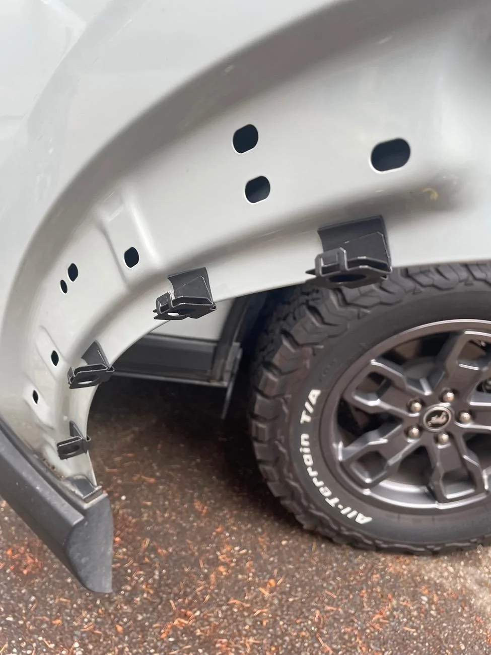

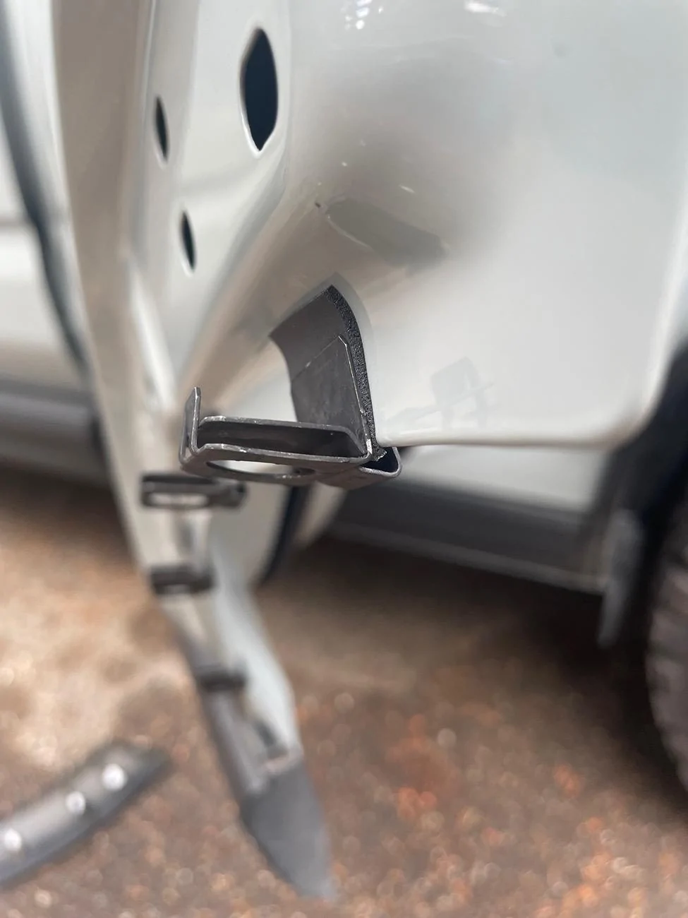

@Mark S. I found the solution to all of this today! Just received my bushwackers and was able to find UPDATED installation instructions and spent a good 2 hours figuring out how they go on! You do have to remove the rear fenders! These puppies are just simply not going to come off with how they have you install. Here is a link with the install instructions and a few photos and clips of my install. If any future member sees this feel free to ask me any questions I’d love to help cause it was a doozy to install compared to the rough country flares blue trim tool is what I found works best to remove oem flares
https://static.thiecommerce.com/assets/production/10-rt-bwr/VM1PZ-16268-AC_r0_Complete.pdf
I didn’t get a photo of each and every step cause I was racing day light but the instructions I linked have EVERYTHING
