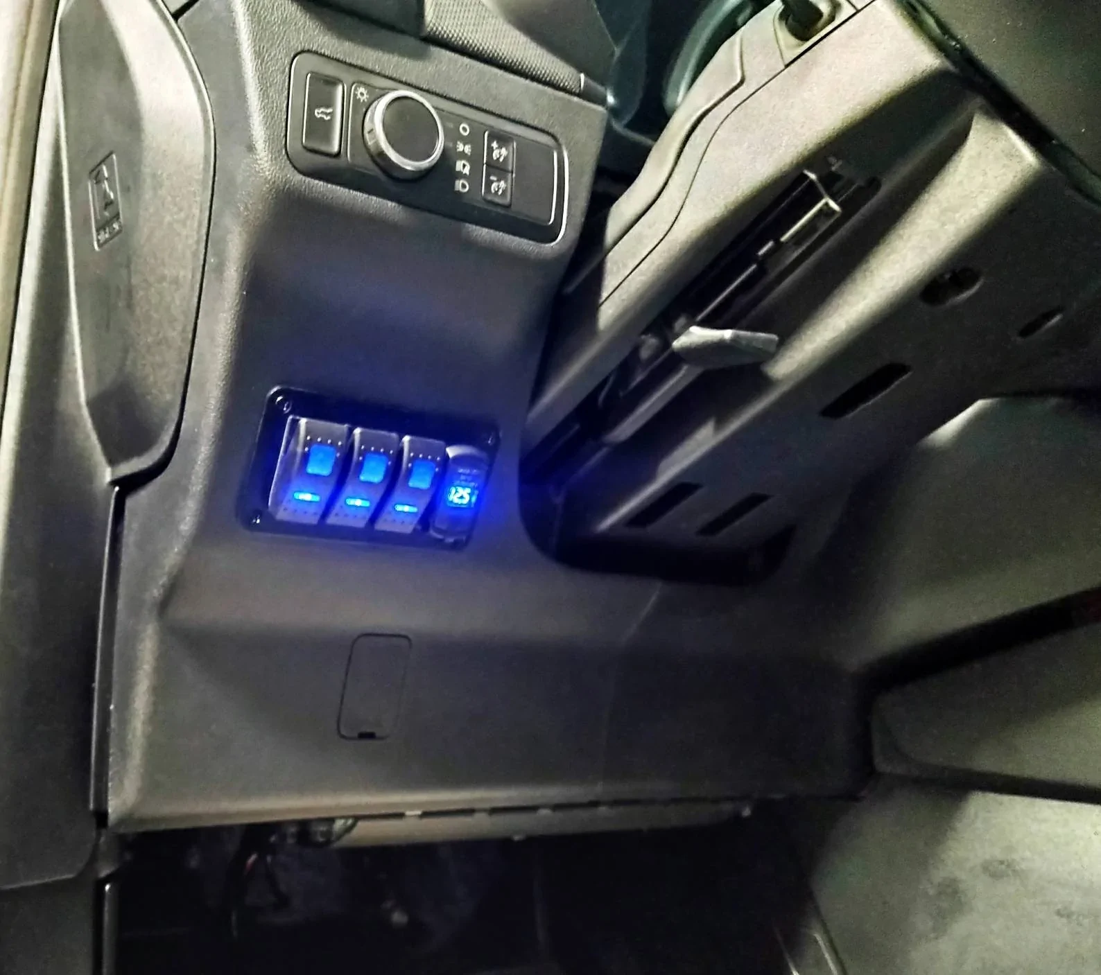

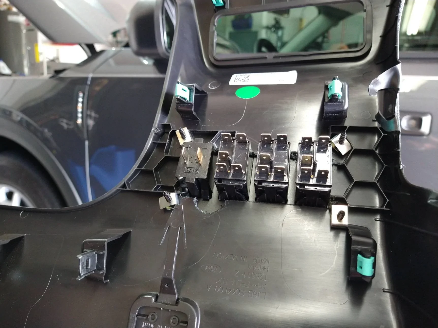

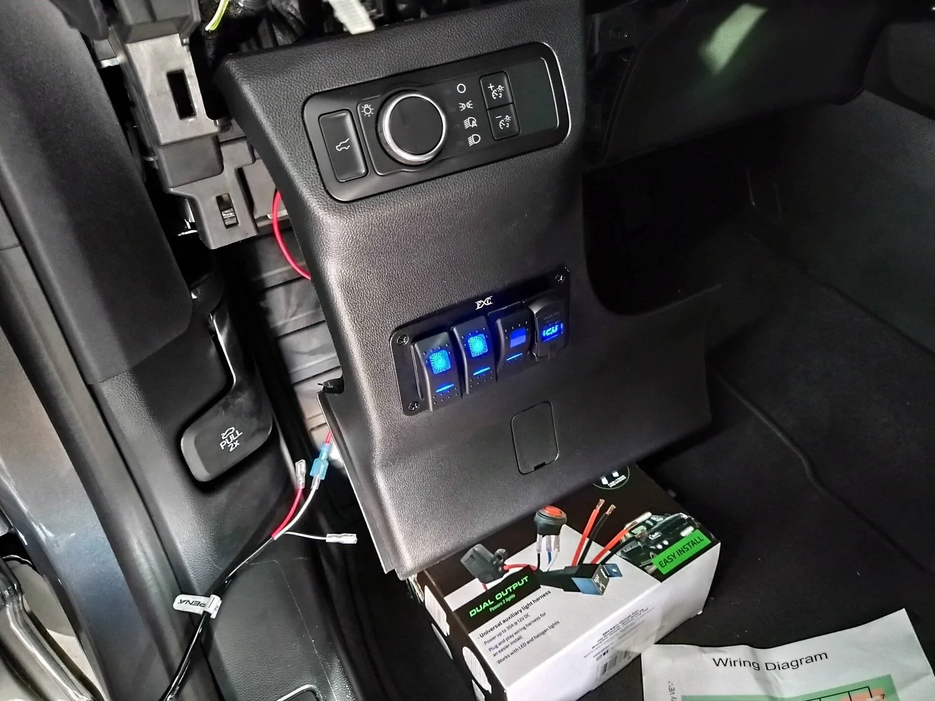

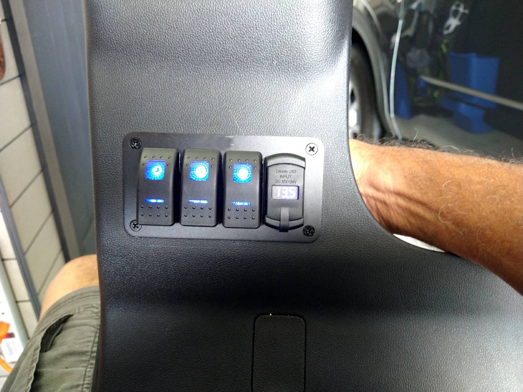

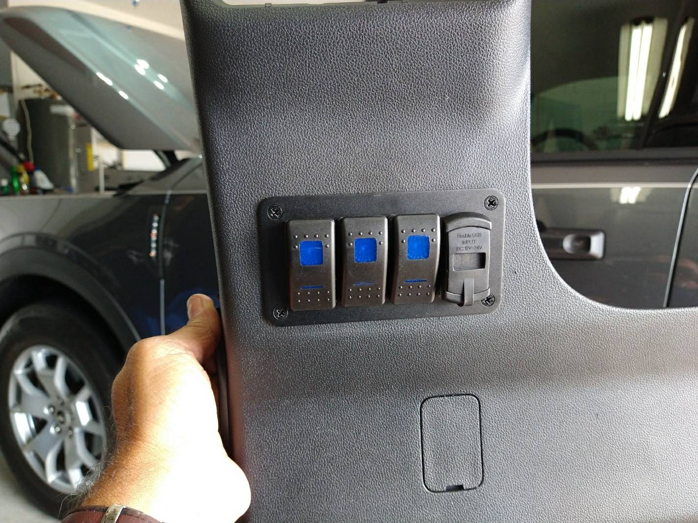

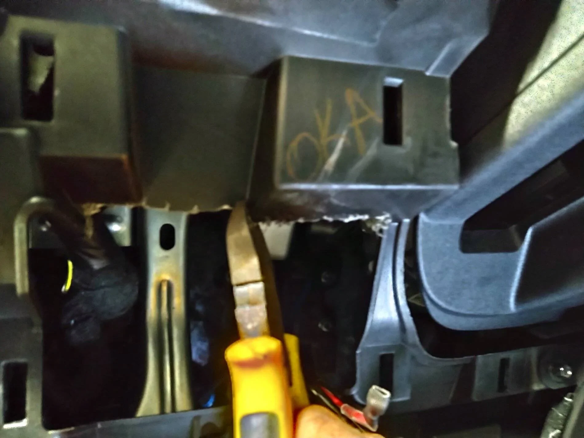

I have already done the installation, the picture of the switch assembly mounted is mine, I was wondering if anybody else had as much trouble as I did with this particular switch assembly. Switch 1 operates my front fog lights, switch 2 operates the lights around the cargo basket, switch 3 is not used at the moment.

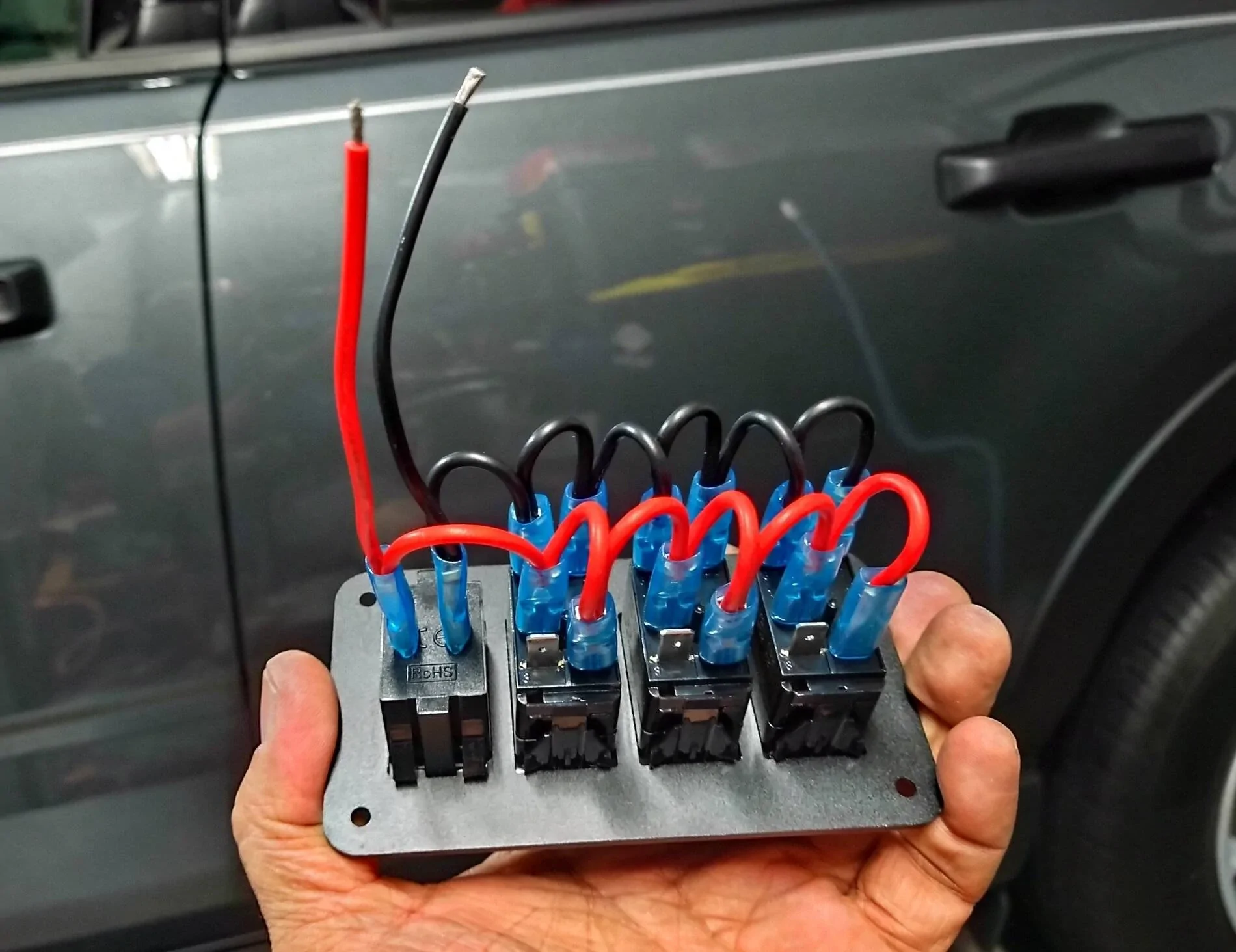

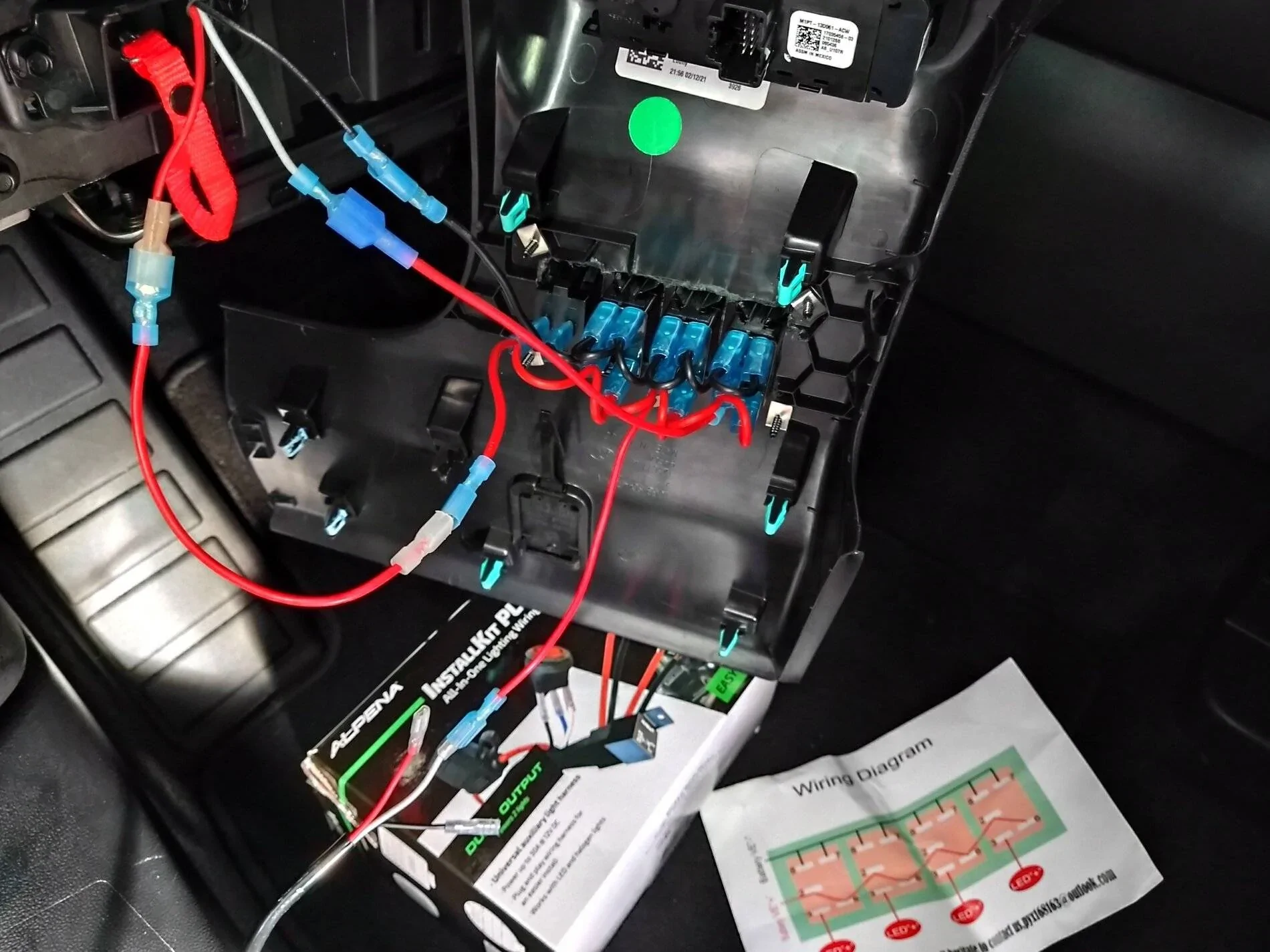

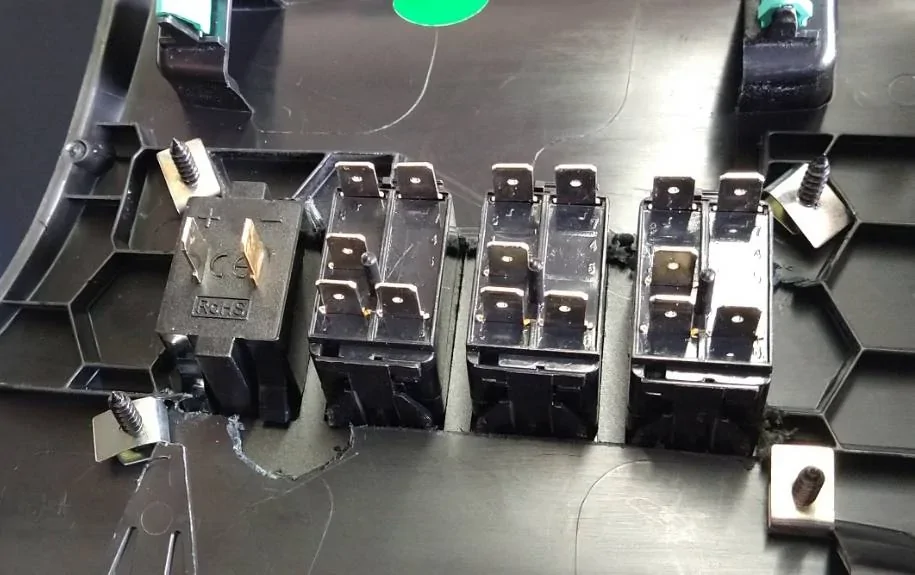

I considered that location too, it is a very nice location for a gang switch assembly however, the assembly I had did not fit there at all. The terminals of the switches and the wiring between them, requires at least two inches of clearance in the back. A mini switch assembly if there's such a thing might fit. The current location was the only place with enough clearance behind it to fit, and still had to trim away part of the dash support to make it fit.

A very good point. I have not wired in stuff in decades, so am rusty. That switch box you have is one I was thinking of. I would prefer it mounted where I can see it properly though. Hmmmm. Perhaps a bolt on box? Will have to think on it. Thanks for showing it wired. I have a much better idea of how bulky it is now!

Ok ... dumb question maybe, but what about that rectangular cover plate near the bottom of the dash panel? It looks like it's a punch-out to add a single rocker switch? Will one of them snap perfectly into that opening if you only want to add one switch?
If I remember correctly, that location has an emergency hood opener behind that tab. it's red and you can see it in photos 6 and 8. there is also metal frame support parts that are in the way.
