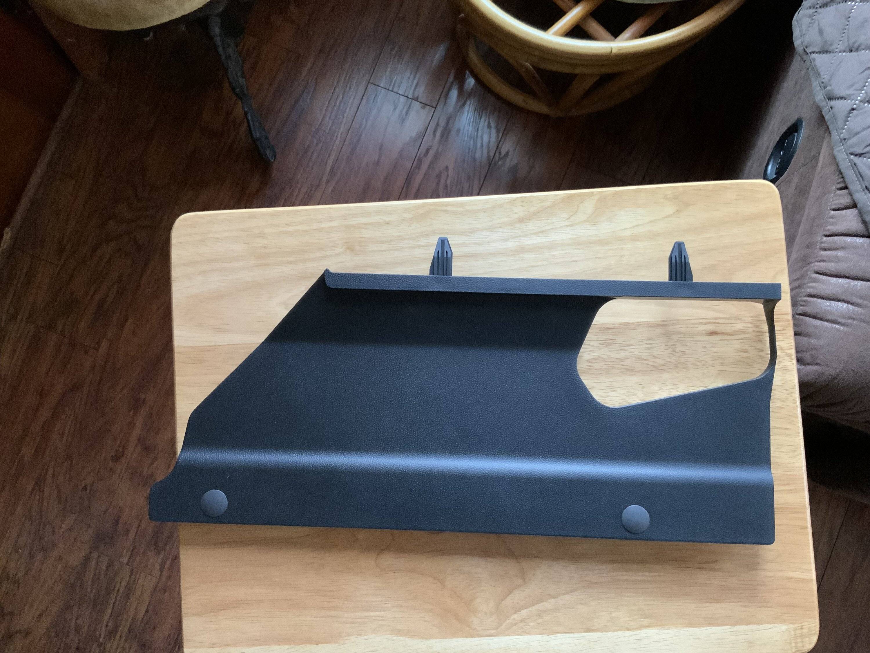

Anyone else missing the panel under the dash above the passenger side fuse box where the floor air ducts are.

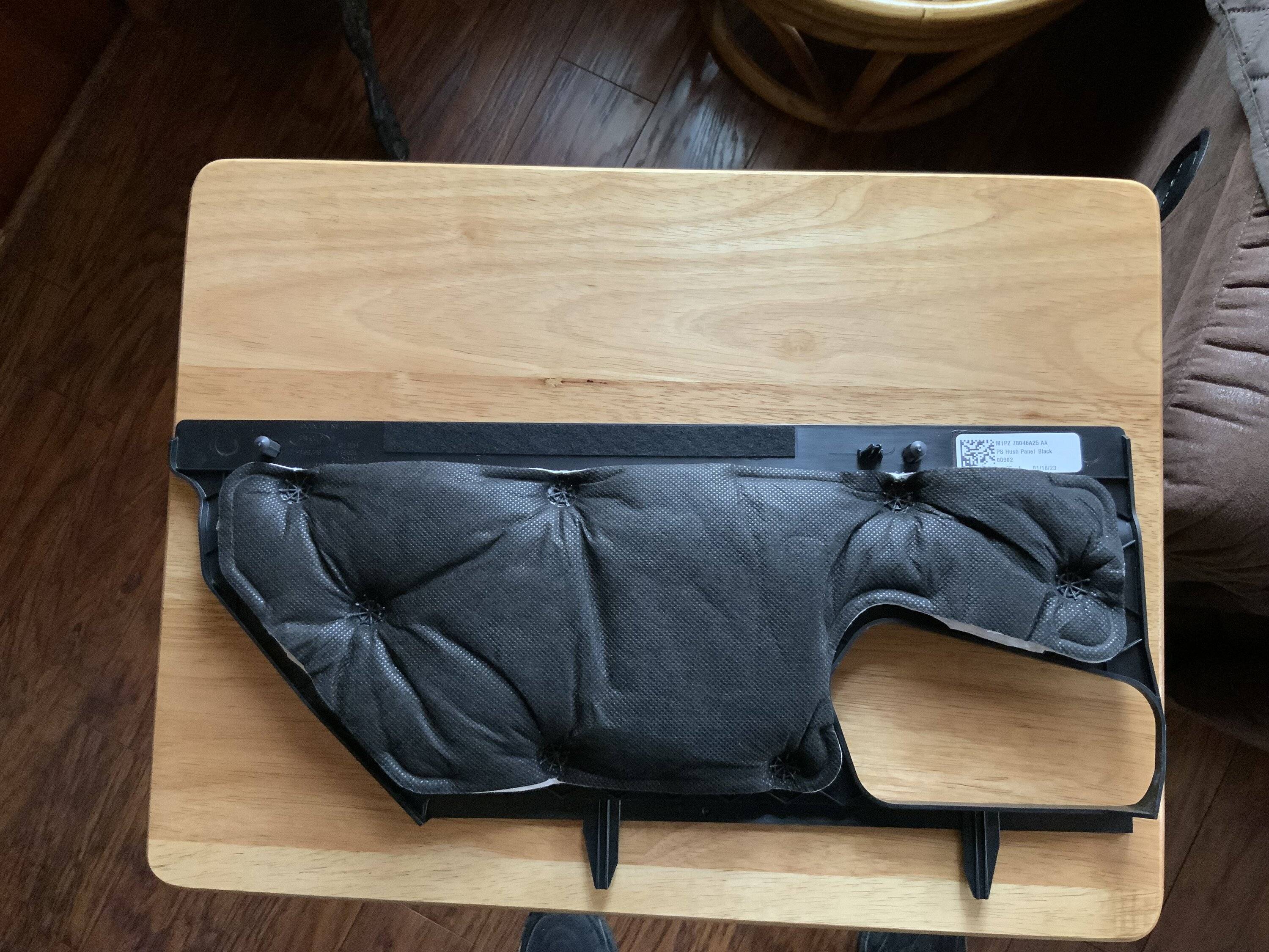

I wasn't interested in this piece until I saw it is sound insulated. May not do much but it has to do something.

Yes. You will see when you get the part how simple it attaches.

Covers the fan motor housing. Definitely muffles the sound. Only Ford didn't think it was important or was it they didn't think anyone would notice it missing?

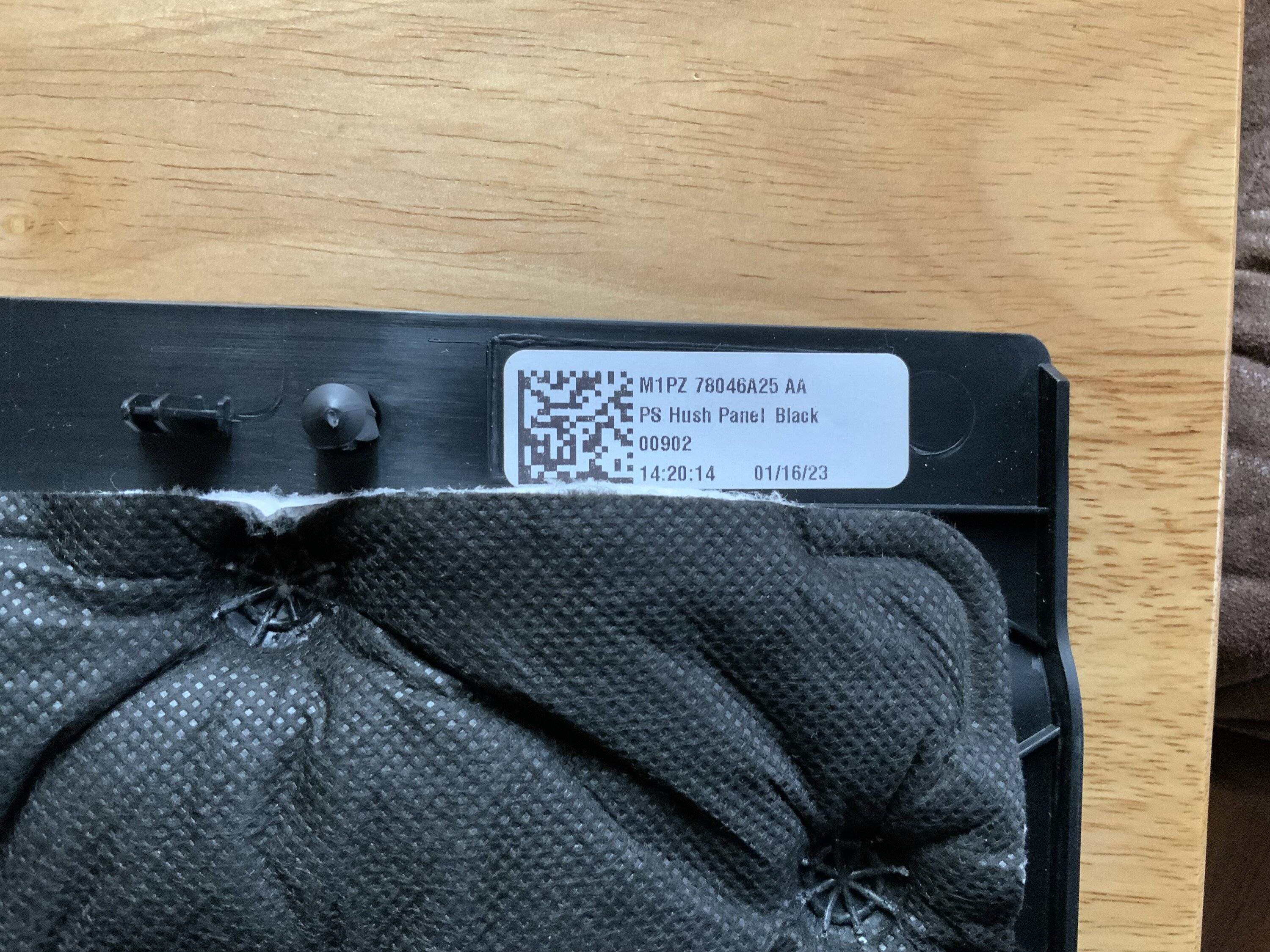

M1PZ-78046A25-AA

M1PZ-78046A25-AA
That’s the passenger-side dash plate—I’m talking about the engine bay dash panel nuts. I ordered the dash panel, but just assumed the nuts required for installation would be included. Colonel Angus indicates they are a separate purchase in his post.

You might be referring to this:
Dash Panel Insulator (under hood on firewall) M1PZ-7801588-A (40.63" L x 4.13" W x 0.5" H), 4X NUT-W709793-S439, Nut U Spring M6 Push On, 10/26/2020, BRONCO SPORT (C430N), EEC 70/157 AND ECE R901 PKG
