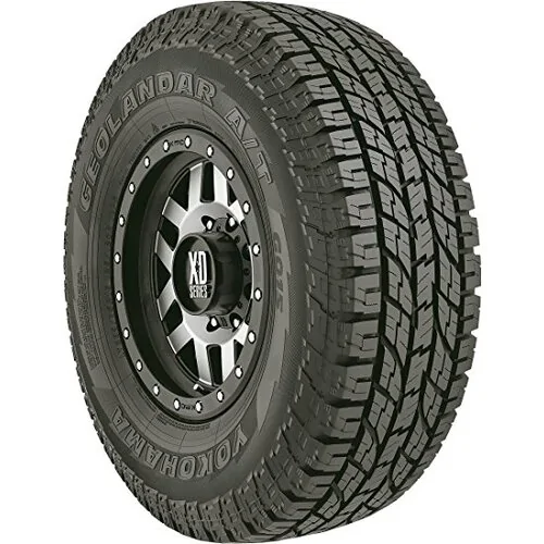

If I go bigger it will be with these. More of a road tire with a softer compound for better road manners and the sidewall look of an off road tire. I don't do offroading.
The Yokohama Geolandar A/T G015 is a well-regarded all-terrain tire known for its versatility and performance in both on-road and off-road conditions. Reviewers frequently praise its strong dry and wet traction, confident handling, and comfortable ride. While it's not designed for extreme off-roading, it provides capable performance on light trails and in various weather conditions.
