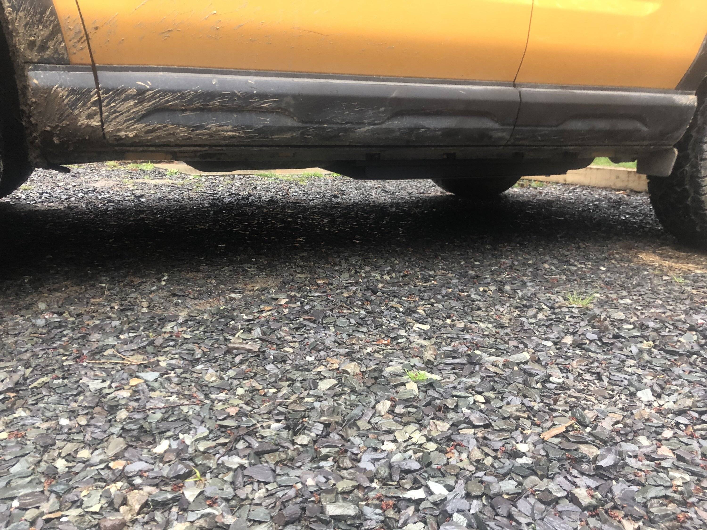

It’s a boron alloy steel. Very strong, very hard rocker panel. Every wrecked BS I’ve seen pictures of it didn’t budge.

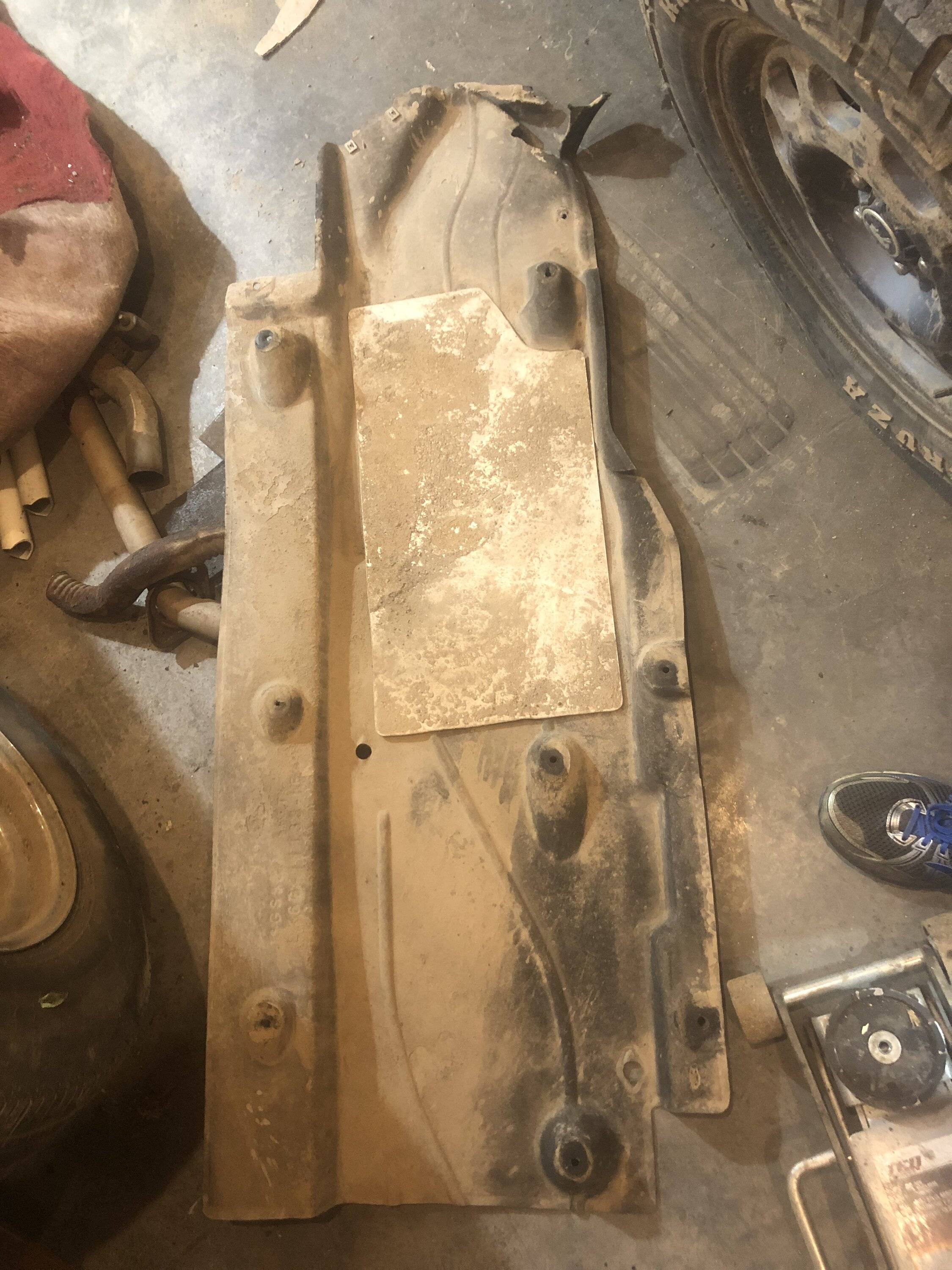

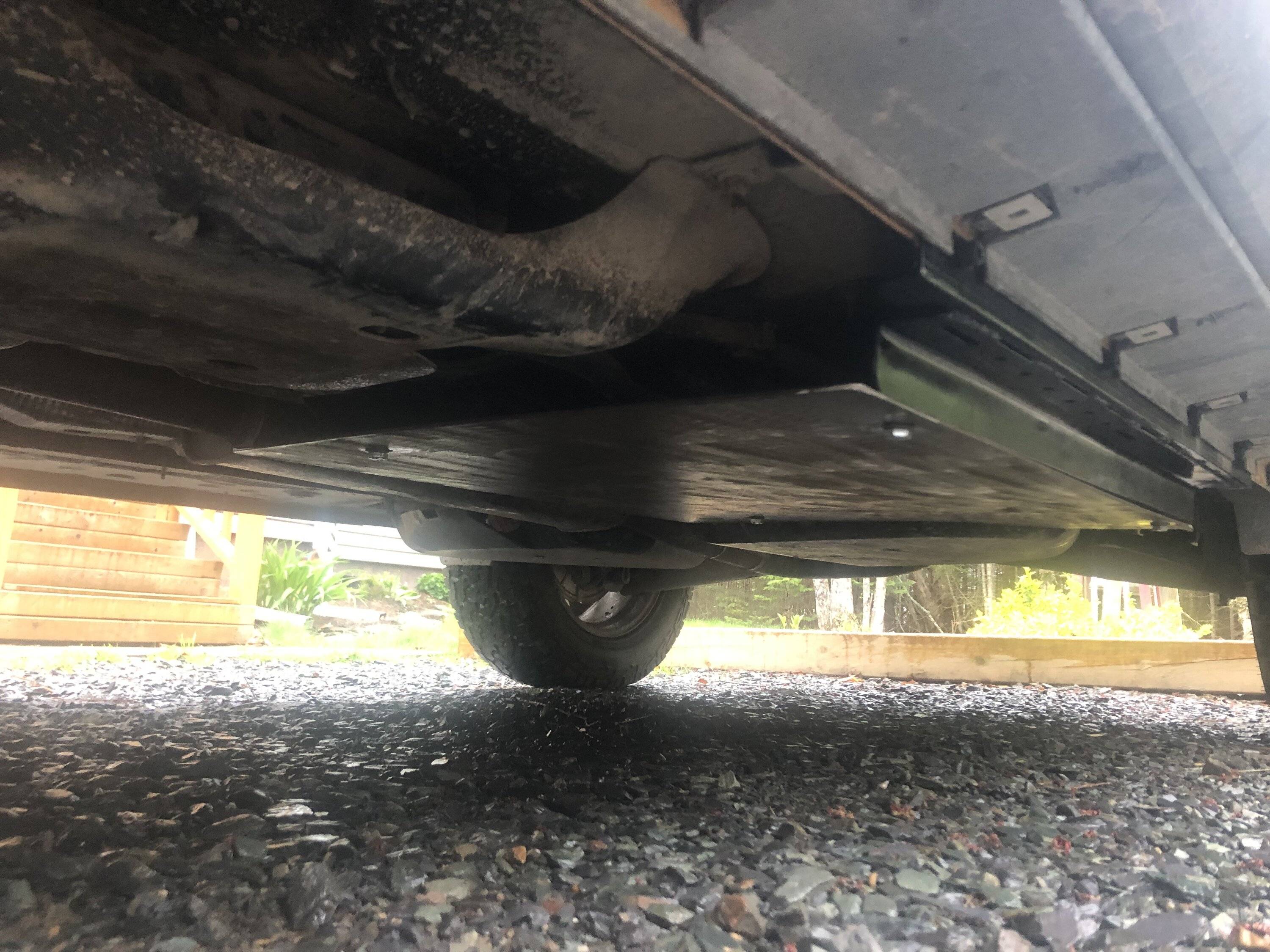

Well doing the videos now, but in one spot she bellied it out on a rock face and had all four tires off the ground spinning! Got it off and all it did is put a bend in the plate I made.
more to follow

It is indeed a boron steel alloy.
You have to drill into it slow and make sure it doesn't heat up too much or it hardens even more

Really?? Wow, they were thinking there, wonder if they have done that on other vehicles too? Would explain setting the rocker on a rock accidentally and it not crushing in..🧐
Thanks for the info!

Ford Bronco Sport Any full length under body armour? IMG_0592
Ford Bronco Sport Any full length under body armour? IMG_0593
Not sure if you can see the dents in the skid plate I made, but she bellied out, all four wheels spinning on a rock ledge and no damage to vehicle!👍🏻
