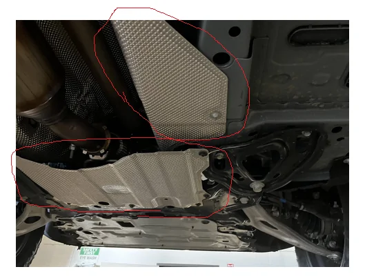

I had a similar sort of rattle going on about a year ago. It was driving me crazy. Anytime I got up to highway speeds it would start.
-I took everything out of the vehicle, out of the glove box, pockets, spare tire, everything and drove it around and it was still there.
-Around the front wheel wells I found a lot of dirt and some gravel stuck behind the trim. I cleaned all that out and the rattle was still there.
-I removed the skid plate, got rid of some junk that was in there, even replaced the little screw-bracket things that attach the plate to the front end (I really thought this was going to be it), made sure all the bolts were tight, but the rattle was still there.
Here's what it was:
-I had been doing a lot of driving on gravel roads in the mountains (heading to trailheads, or just off-roading for off-roading's sake). Gravel, and a pretty good amount of it was living on the various protective covers under the vehicle. I'm not talking about the hard skid-plate, but those flimsier protective covers down there.. there are like 3 or 4 of them, I can't remember. Just by slapping the bottom of them, I could tell there was a lot of gravel up there and I finally was able to duplicate the sound that I was hearing while driving.
-The fix ended up being, removing what shields I could and shaking the gravel out, and/or just using a blower to blow the gravel out (one of the shields really didn't want to come off easily all the way, so I just used a small leaf blower).
-Put everything back together, tightened it all up, went for a drive and RATTLE FINALLY GONE and sanity partially restored.
Pic attached so you know what sort of shield I'm talking about.
Final note: It might have been possible to get all the gravel out with a blower alone, but it's just awkward getting it angled right, so I just decided to take what shields I could off.
Here's what it was:
Ford Bronco Sport Annoying as hell rattle Screenshot 2026-03-18 164853
Here's what it was:
Thanks for the advice. I will check it out.

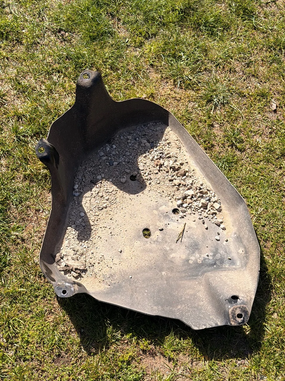

I’ve got a rattle I can’t locate in the rear interior. I understand your frustration. Mine sounds like plastic rubbing against other plastic.
I’ve taken my door panels apart, it could possibly be one of the plastic clips isn’t fully inserted into the corresponding metal on the door.
I was finally able to locate this rattle. This whole time, I thought it was an interior rattling sound, because it sounded like plastic rattling.
I took my skid plates off to undercoat the bronco, and both of the fuel tank skid plate were completely covered in rocks. The factory fuel tank is plastic… got rid of the rocks… got rid of the noise.
Ford Bronco Sport Annoying as hell rattle IMG_6230
