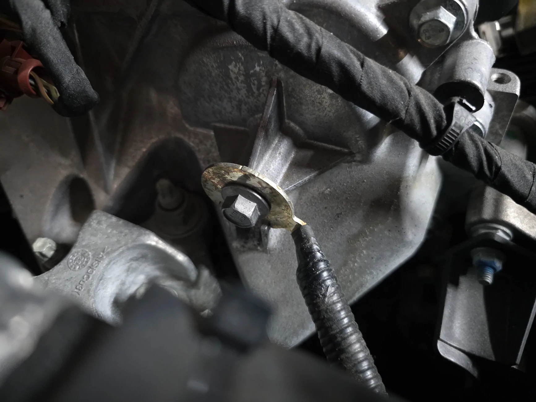

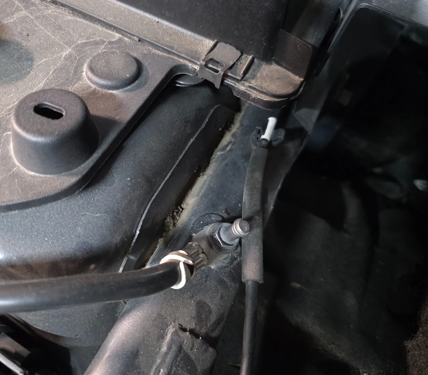

I gave the SA that information and they said they would pass it to the tech. Not sure if it ever was or not. I know where G107 is (strut tower) and I cleaned it up, gonna look for G109 tonight (pretty sure its on the cylinder head).
It's not for your exact year, so they probably round filed it. But just because yours is a year newer doesn't mean that can't be the culprit. Same symptoms and an easy check. GLWR.

G107 near the strut tower and G109 on the cylinder head. Had already cleaned the paint off the bung on G107 as well as the eyelet. I just removed G109 and it was maybe torqued to 15ft-lbs and needed major cleaning. Some 320 grit made quick work of the surfaces and I got it snugged down much tighter. The SSM of installing the eyelet wrong would not apply as its a circle with a big flat notch in it, kind of hard to mess up. Regardless both grounds are now clean.
