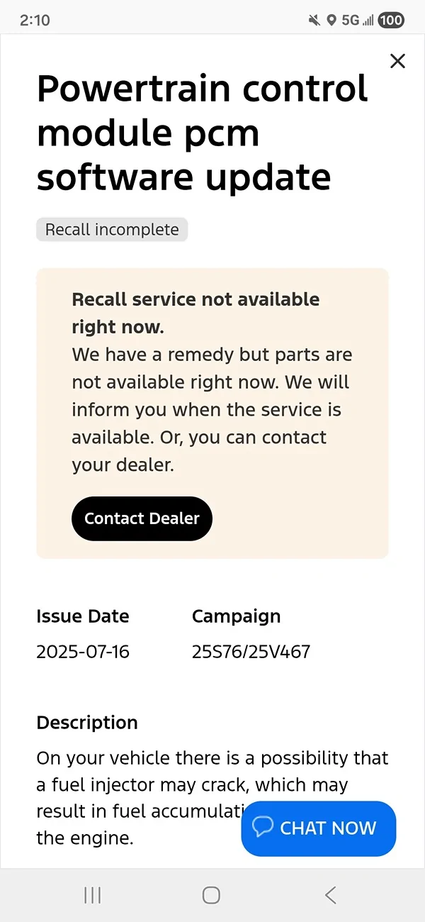

The Motorcraft branded injectors are readily available from online parts sites such as Rock Auto. Not sure why Ford dealers wouldn't be able to get the injectors.
You tell me, lol. This is straight from Fords website for recalls when entering my VIN:
Ford Bronco Sport Amber wrench indicator light on instrument panel 1000024939

If the light is coming on due to one or more leaking fuel injectors the dealership would replace but you might not have a fuel leak and have another issue for that code:
“Ford DTC P130D indicates "Knock Control Combustion Performance Forced Limited Power," commonly affecting 1.5L/2.0L EcoBoost engines in vehicles like the Ford Escape and Bronco Sport. It signifies the PCM detects excessive spark knock, causing a "wrench" light and limp mode. The primary fix is often a PCM software calibration update, though it can also stem from loose grounds (G109/G107) or fuel issues.”
No guarantee that info is accurate

Yep, thats part of the injector recall, a PCM software update. My wife has put BP 89 octane in it the last 2 fill ups, so I doubt its bad fuel, maybe a faulty knock sensor. It's going to Ford Wednesday and I'll gladly pay my $100 deductible and hopefully its a warranty item and its at no cost. This ESP may be worth it already.
