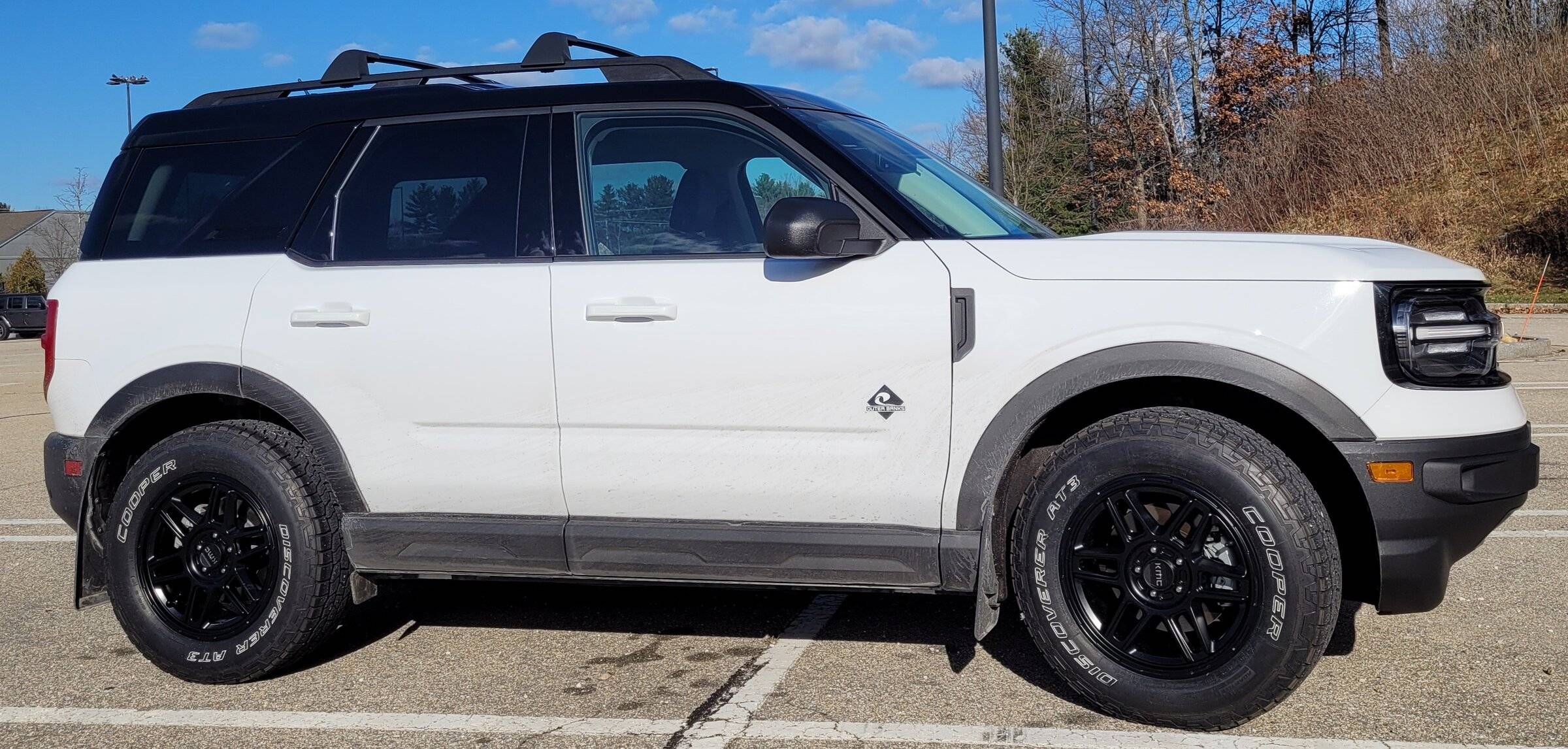

Going out to anyone running A/T 3 tires.
Since we are putting light truck tires on a compact SUV, What is everyone running for PSI?
I just had 245's mounted and they set them at 37 psi. There is almost no compression in the rear so I am considering taking thoes down a bit.
