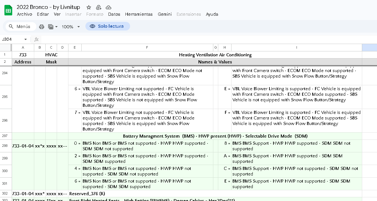

From what I’ve been able to gather, switching to an AGM battery can definitely help, but more as a mitigation than a direct fix.
The “auto shut down” or battery saver behavior (I think you are talking about that) is usually triggered by low voltage or the system estimating that the battery is weak. AGM batteries tend to hold voltage better under load and handle cycling more efficiently, so they reduce the chances of those conditions happening.
Regarding the replacement: yes, it’s recommended to perform a BMS (Battery Monitoring System) reset. The vehicle keeps track of battery condition over time, and if you don’t reset it, it will still “think” the old battery is installed and may not manage charging correctly. (At least in most new vehicles is likie that)
With FORScan, there’s a specific function for this (Battery Monitoring Reset), which is the proper way to do it.
Additionally, it’s worth checking how the vehicle is configured from the factory in terms of battery management. Through FORScan, you can access the configuration parameters in modules like the BCM/BMS, where the system defines whether Battery Management System (BMS) is active and how it handles charging strategy. These parameters indicate if the vehicle is set up to properly manage different battery types. Even if you install an AGM battery, the system will still work, but if the configuration is not aligned, it may not be fully optimized in terms of charging behavior and battery life.
That said, everything I’m sharing here is based on information I’ve been gathering from different posts and forums as I learn more about the system. I’m not an expert on the subject, so I’m also trying to better understand how it all works in practice.

What @Timon.Arg mentioned about checking if the vehicle is configured to have an AGM battery not has been discused in a few forums and some people feel it is not necessary and report having no issues without chaning the configurration to reflect it now has an AGM battery in it. IMO, if that setting is there, it is for a reason. Personally, I would change it.
