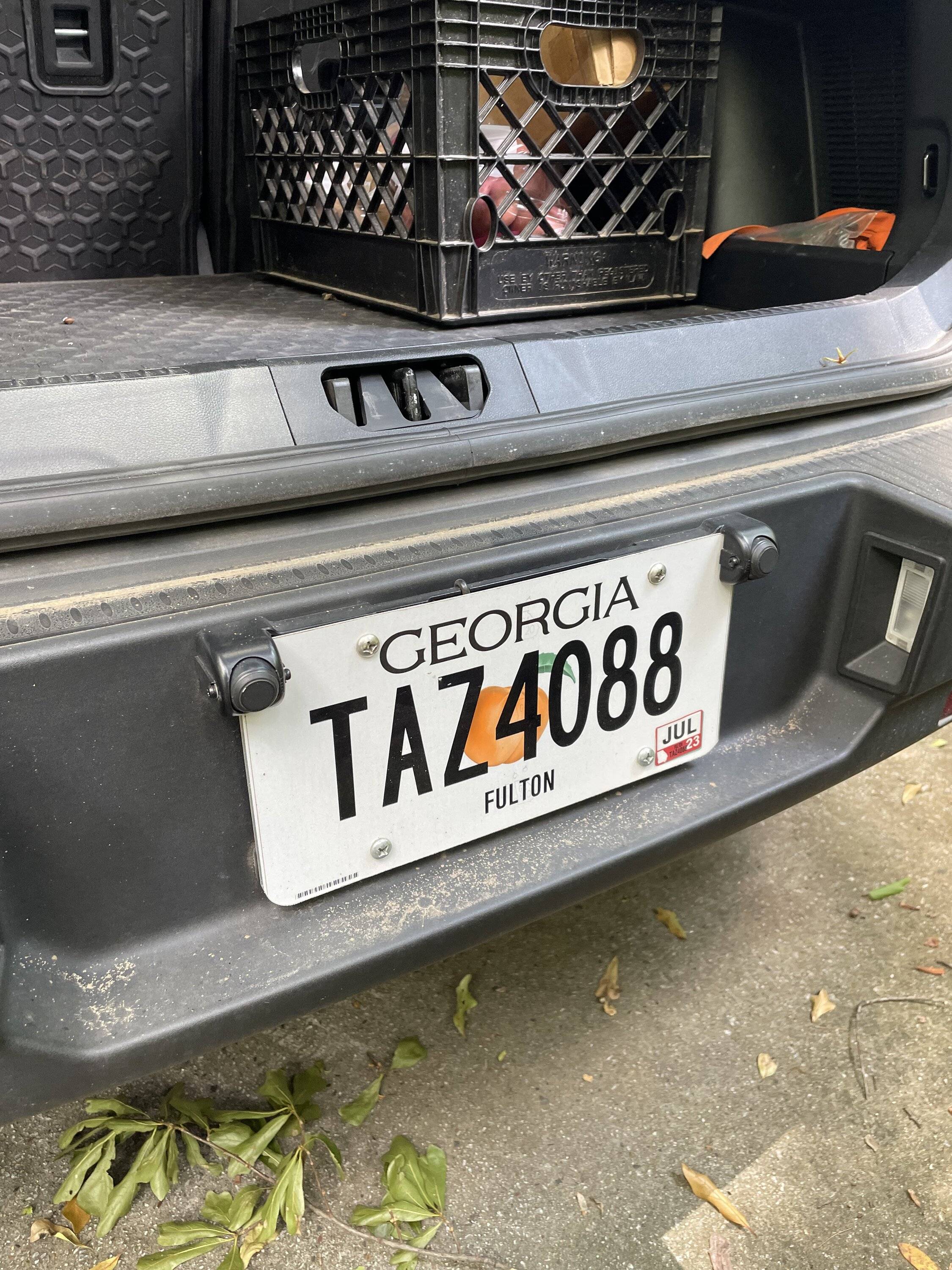

As an alternative, bought this for both 21 BB and 04 Solara. Very happy with results for 2 and 3 years. Connects to reverse light in tail light and U-haul video on BS hitch install is very handy to see how to route wires.
https://www.amazon.com/gp/product/B002XUXUTS/ref=ppx_yo_dt_b_asin_title_o01_s00?ie=UTF8&psc=1
Do you have any pics you can show of your install on your BS? Did you have to drill through the rear bumper in order tu pass the wire from the sensor to the wiring harness behind the bumper?
Yes, but drilling was very simple and I could be wrong but I believe it was only through plastic, not metal. The real key is the Uhaul video so you see how to disassemble the interior trim to feed the wire to the tail light.
