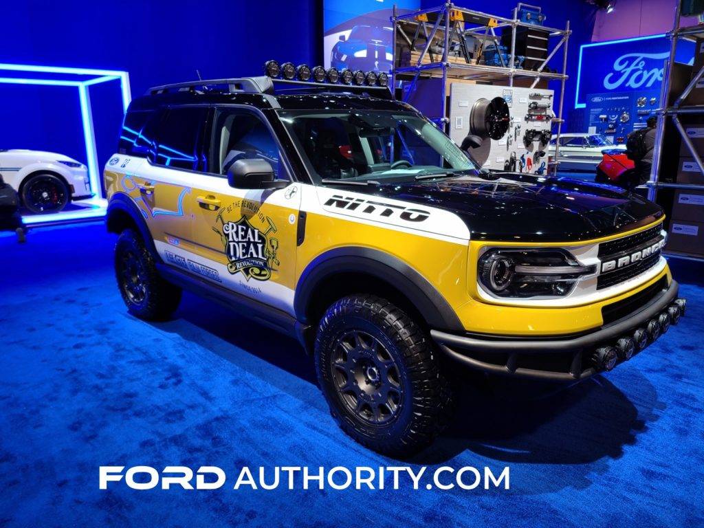

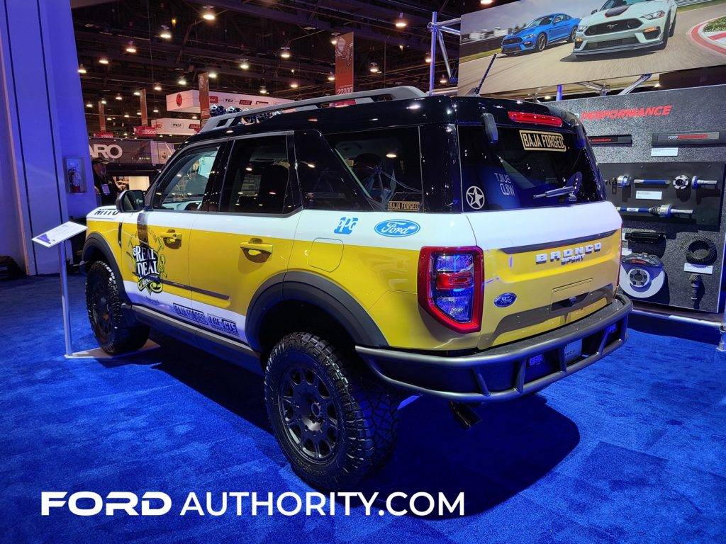

This front bumper style with the integrated plate and mounts for winch and lights. Functional and looks great. But I'm not sure if this is possible with the unibody construction nor do I know if it's safe in a collision.
Ford Bronco Sport Aftermarket parts wish list? Let us hear it! JcrOffroad TacomaHybridFrontBumper1
I think a safe bet would be skid plates and rock rails. I think we have enough choices for roof racks. And I wonder what the actual market is for steel bumpers in the non-Badlands segment.

Safety???? Doesn’t coolness and function trump safety? LOL

Done for a show car is different than being ready for production.
Exactly. So far, there have been a few notable car show builds that immediately abandoned their "plans". Would love to hear why they chose to do this. I figure it's mainly to do with the limitations of a unibody construction.
2,030
2,812
I’ve been thinking the same thing.

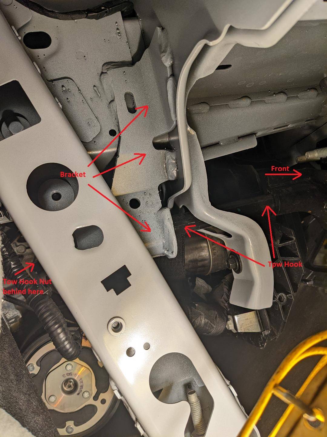

Engineered recovery points for non-badlands models. I recall reading the non-badlands you can’t install the front tow hooks or they are missing reinforcements that the badlands has or something
Yes the lower trims are missing a steel bracket that is welded to the Badlands frame that the threaded end of the factory front tow hook connects to. A lot of ppl would like to add functional front tow hooks to lower trims....
