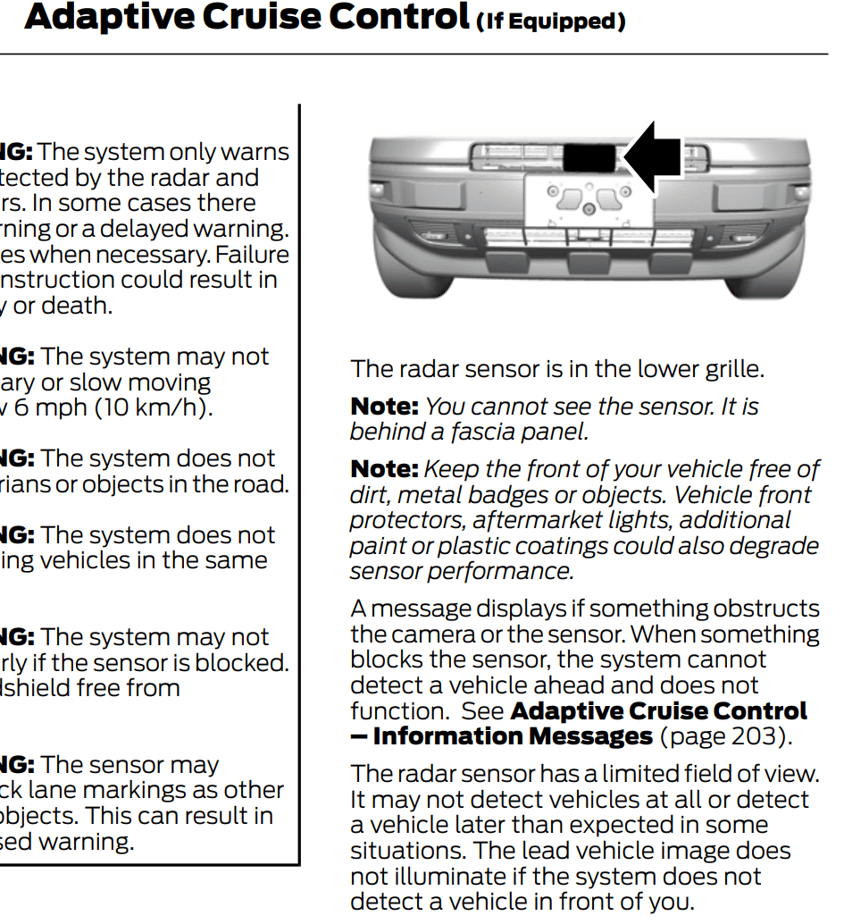

Snow disables the whole thing. It was snowing this afternoon as I was driving and the buildup on the front bumper and grill caused the sensors to become blocked. I can only assume that is where the sensors are located, I'll have to check the manual for specifcs. The first thing that happened was the adaptive cruise control did not slow as I approached a slower vehicle from behind. Once I changed lanes and the senors could not detect the lane edges, a warning popped up saying the systems were not available and to check the manual. The snow wasn't very heavy, the roads were wet, but not becoming covered, and traffic was light. It wasn't a huge issue to drive the remaining 30 mins without cruise.

Normally the camera for those things would be in the windshield. Did they use the trail cam for the adaptive cruise control also? That's the kind of design flaw that will get fixed in the next gen.
EDIT:. Are you sure there isn't a second camera up in the windshield?
Do you mean that the adaptive cruise control stopped working without any warning? That's an accident and lawsuit waiting to happen.

The adaptive cruise uses a radar sensor mounted beneath the front bumper to detect a vehicle ahead. The camera behind the rearview mirror watches lane markings for lane centering and lane keeping functions.

Yeah, it definately stopped working while it was still "on". It had the car infront of me on the radar/in the center display, but it kept same speed, stayed green. I braked then changed lanes. Once I changed lanes it turned off.

Once I got to my house, I took a pic of the front for reference. The windshield was clear, but the entire front bumper was covered in slushy snow. Without much investigation, I assume that is the location of the adaptive cruise control's sensors.
Ford Bronco Sport After a good 250 mile drive today, some thoughts. IMG_2603
Adding the page from the user's manual. So that little rectangle part of the fascia that is snow coated, the radar is behind it. Doesn't work with about 1/4" of slushy snow on it!
Ford Bronco Sport After a good 250 mile drive today, some thoughts. ACC_UserManual

There is a software update waiting to happen.

My Escape as ACC, and has the exact same issue. I get a warning message when the slush builds up on the sensor that "sensor blocked, auto-braking disabled".
Studies have shown that cruise control is actually dangerous in poor weather conditions because a loss of traction (pooled water or ice) can result in sudden acceleration and unpredictable behavior.
Being on the "wet coast" I sometimes even will get a message that the camera is blocked, usually from condensation from the excess moisture and temperature difference inside/outside and in the camera module itself.
