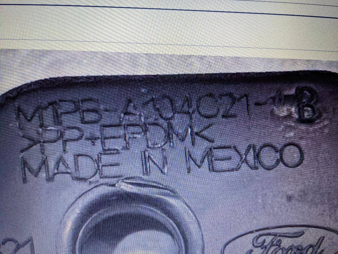

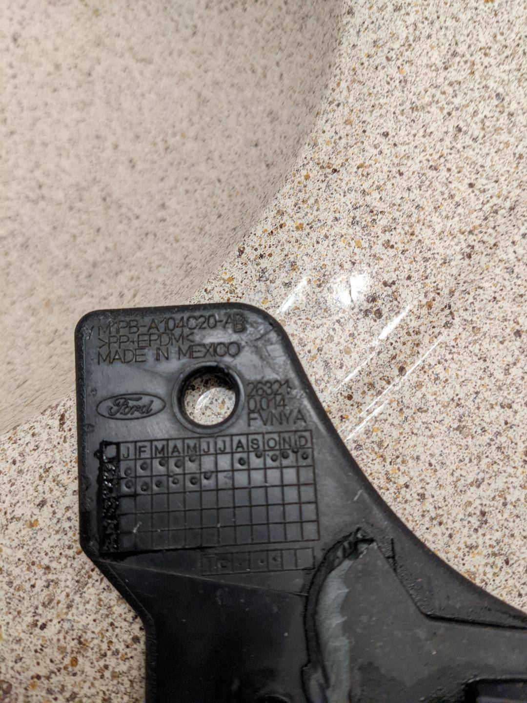

I hit a dead racoon while driving in hard rain and it broke my right side air deflector off. I called local Ford dealer who said they could get one in two days. But since part of the plastic rocker panel also broke off I went back to where I hit racoon and was able to find my original with the broken rocker panel attached to it. So I glued rocker panel piece back on with black 3M Weatherstrip Adhesive let dry overnight and reinstalled air deflector. Air deflator attaches with one screw and two push pins. One of the push pins was lost but an identical one was found at AutoZone an exact match.
The part numbers molded into the rear air deflectors are:
M1PB-A104C20-AB for the right rear
M1PB-A104C21-AB for the left rear
You can find them for sale on ebay too.
Ford Bronco Sport 6 piece Badlands OEM mud flaps - where to buy? Air Defector Right Rear
Ford Bronco Sport 6 piece Badlands OEM mud flaps - where to buy? Air Defector Left Rear
