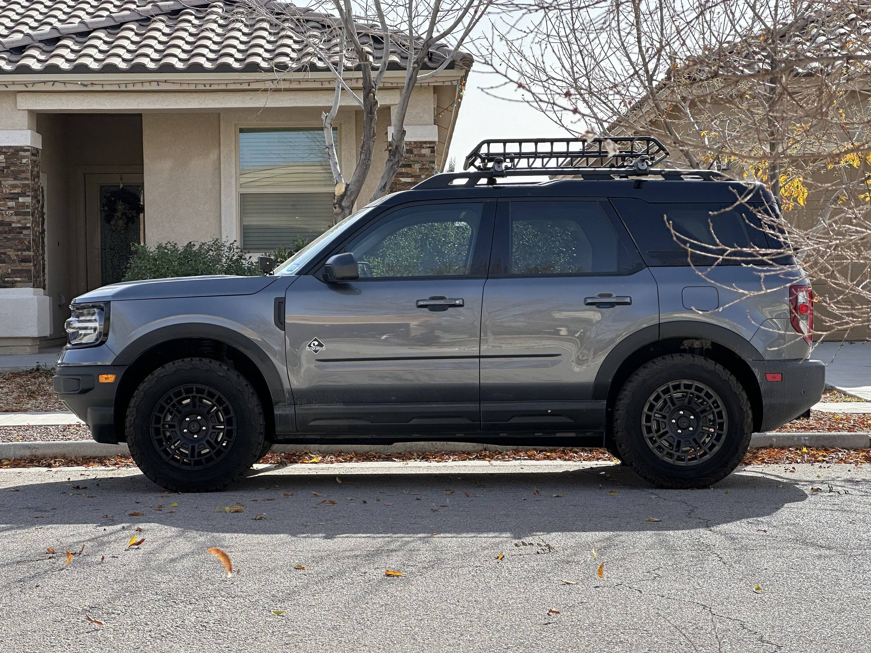

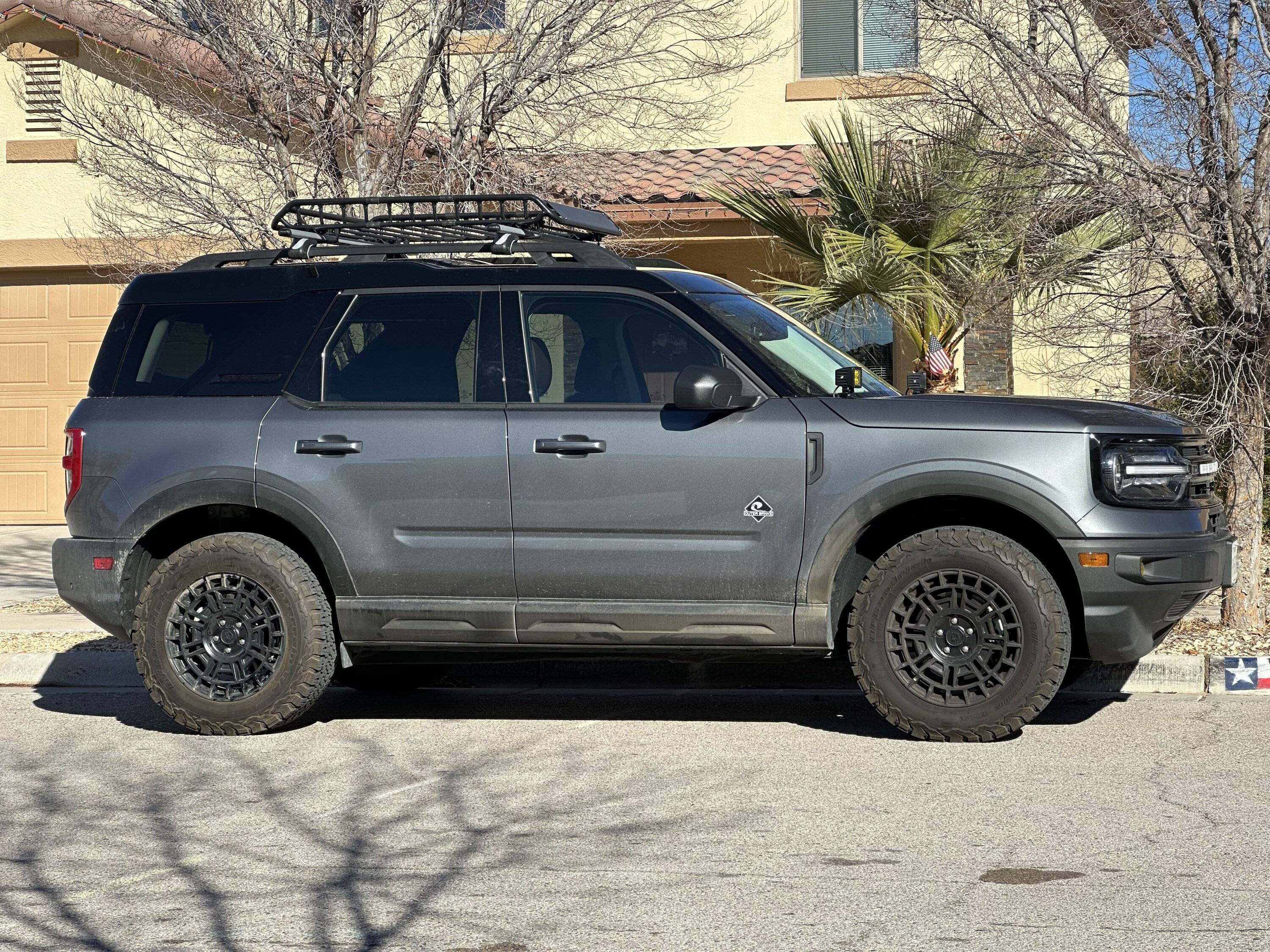

I installed the 4 Wheel Parts kit that I got on sale for $199 during cyber Monday to my OB.
I really wanted to wait for the Eibach springs but they still don’t have an ETA for non badlands models.
This kit is listed as a 1” Front and .75” rear which for me is perfect as I didn’t want to mess with sway bar end links or rear subframe drops.
This kit does include a front spring pre load spacer and a strut spacer which I do like as it doesn’t mess with front droop too much. The ride did firm up a tad bit due to the preload spacer but I honestly still think it rides awesome!
First picture is front and rear done.
Second Picture is with just the front done as a “level” kit. It was .5” higher upfront than the rear.
Overall I’m super happy with the ride and price.
Paired with 17” Gear Alloy Pangea on 245/65 KO2s

Thanks! Got an alignment done and couldn’t be happier with the overall ride and look!
