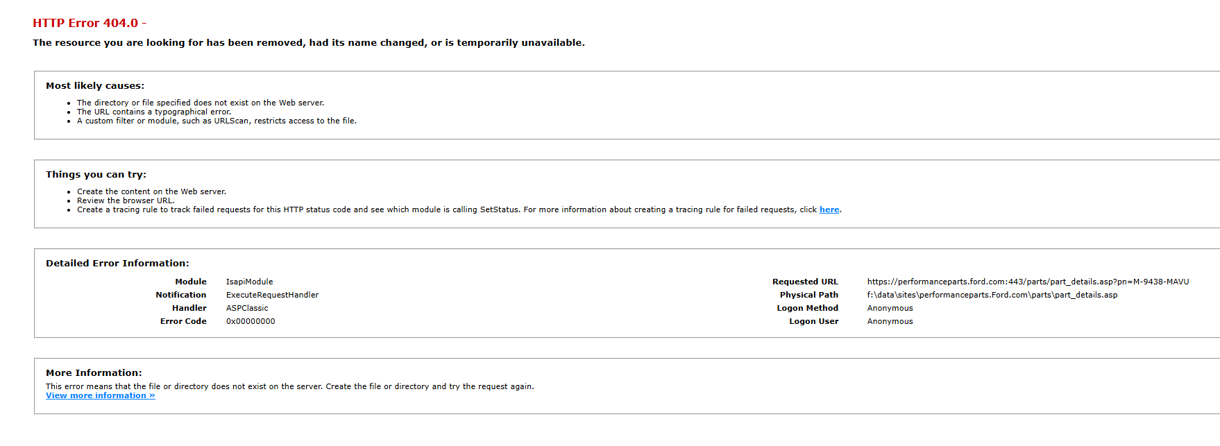

Well, that went quick...
Ford Bronco Sport 300hp Maverick SV300T - Hopefully some of this will be available for Badlands also! 1785264251835-il
