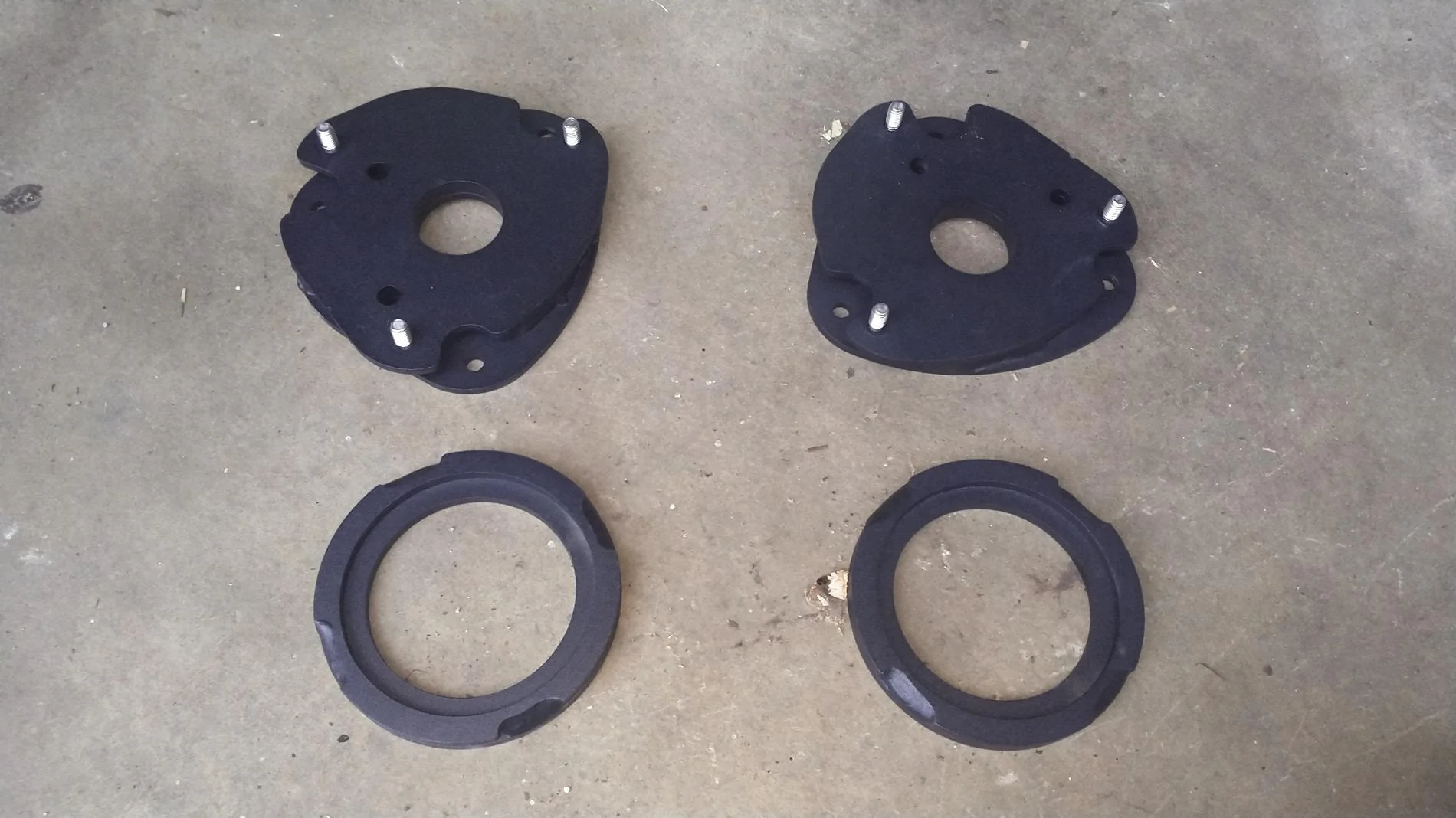

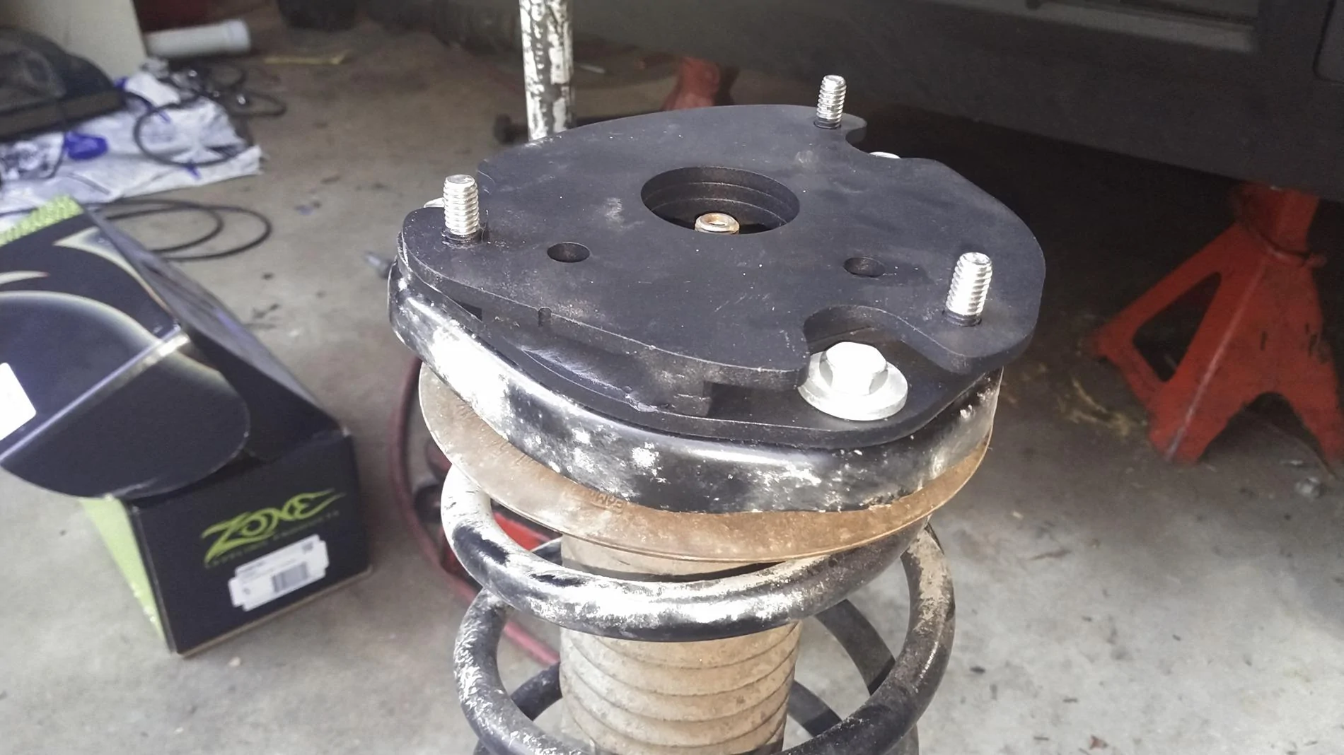

I have been considering doing a leveling kit on my Bronco Sport Badlands for a while. It does great off road, but could use a little more clearance. Also , appearance wise, the front end looks too low for an off-roader. On the other hand I don't go off road that often and I tow a lot that lifts the front end up with my gear and trailer connected. I discovered that ZONE makes a 1" kit for the Maverick. It consists of a 1/4" preload ring for the strut spring and a 3/4" strut spacer. I installed just the strut spacer to give me 3/4" additional lift from stock. No strut grinding required. I think the results look great! The spacer is made of steel as opposed to some that are plastic, very sturdy. It is very easy to install, took two hours total.

Looks like it would make noise with that small of hole.

I have driven it, no noise or noticable difference in the way it drives. If your talking about the center hole. It's the same size as the hole in the strut tower.
