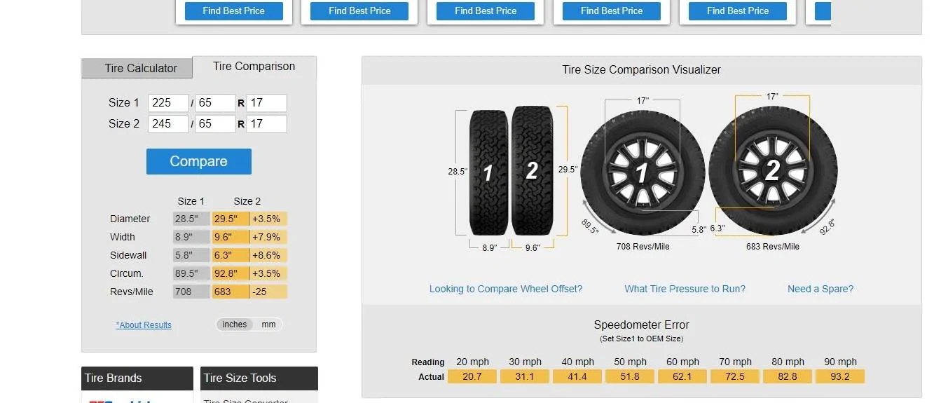

How much will the 245 offset the speedo ??
Negligible. If I use Waze it shows maybe 2mph, but I’ve also driven by speed signs and in speed zones where the signs tell me exactly what the car says. It’s not enough to matter IMO.

Any online tire size calculator will tell you.
That is my experience with AT3's in the same size. Cruise on 75, WAZE reads 77.

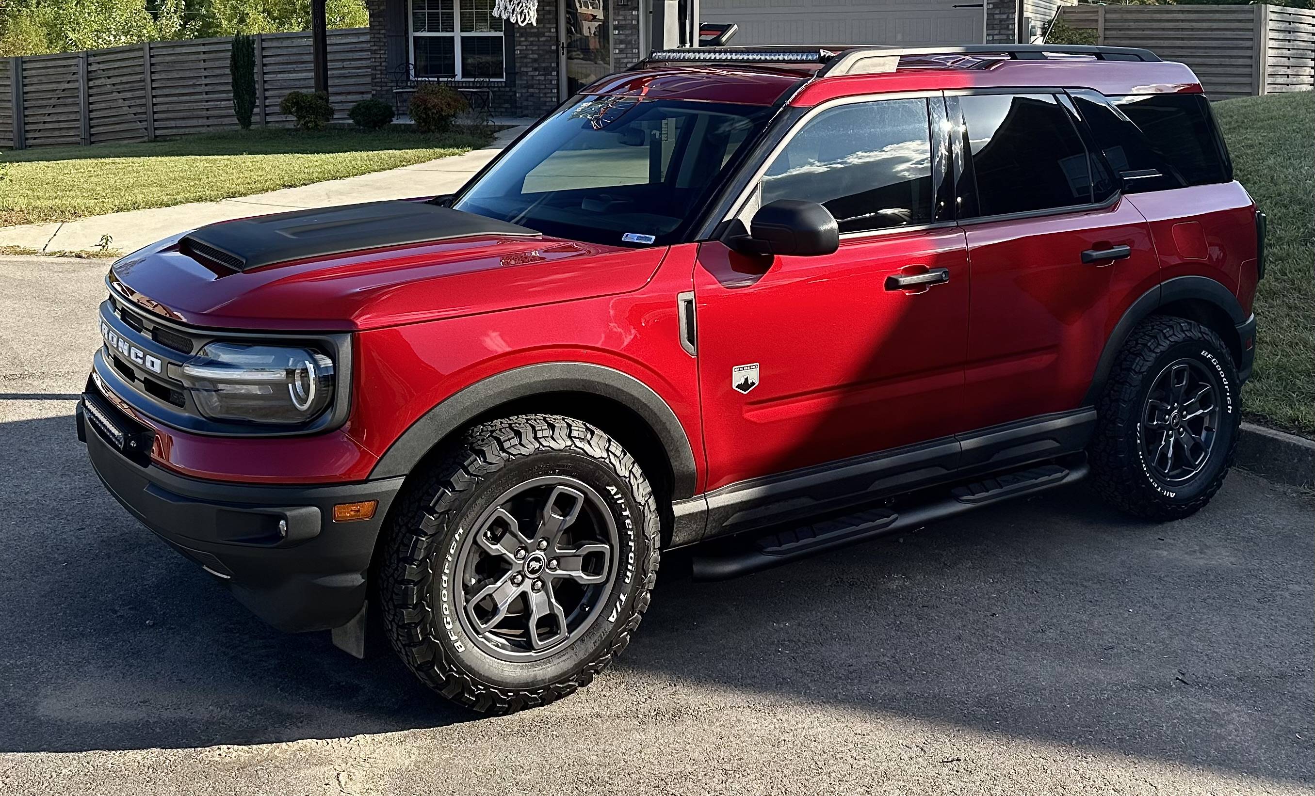

Congratulations on the new Bronco Sport!
I know you've received some answers to the tire issue but I think we'd need to see some pics to make sure everything looks good. ?
