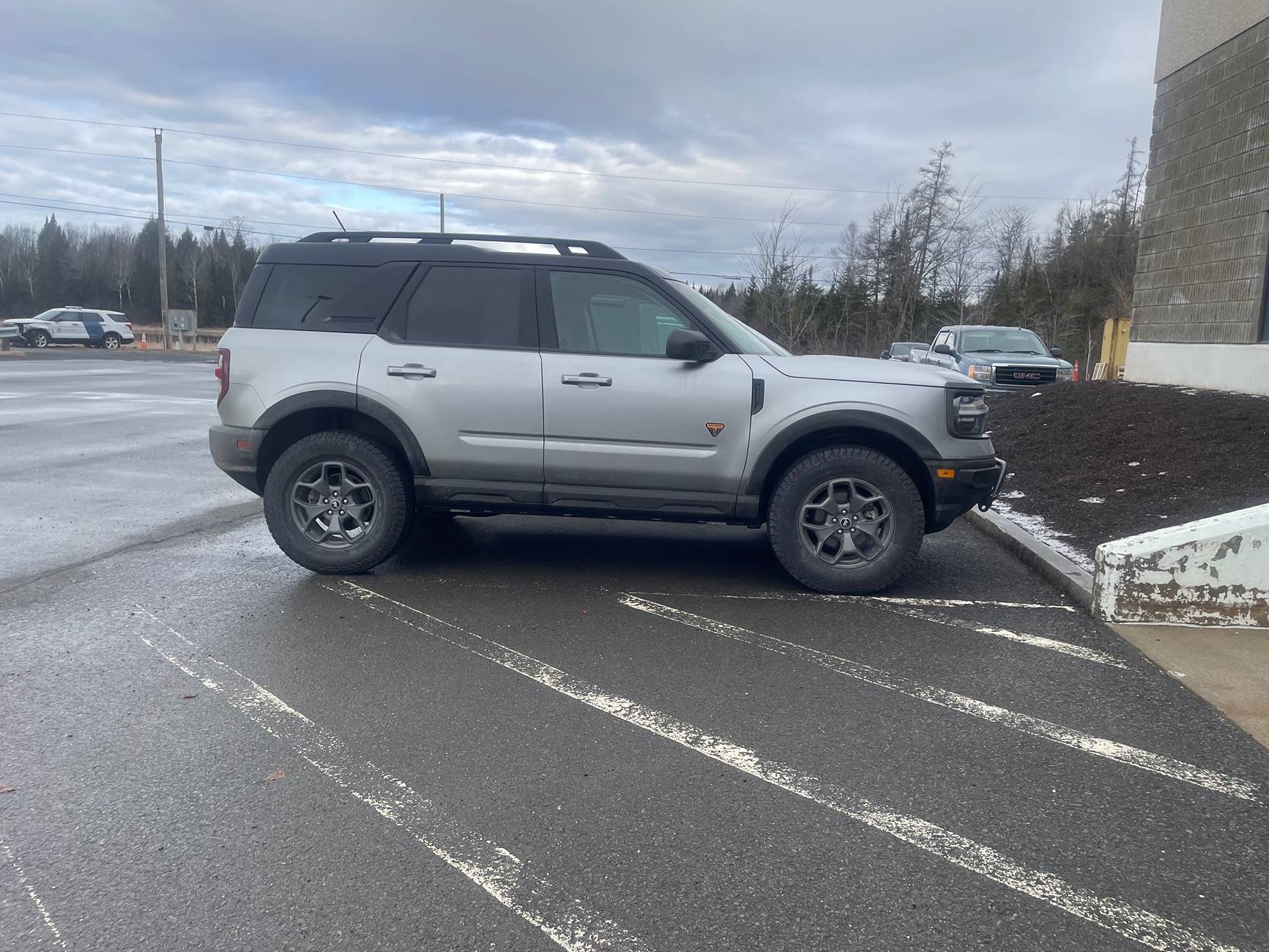

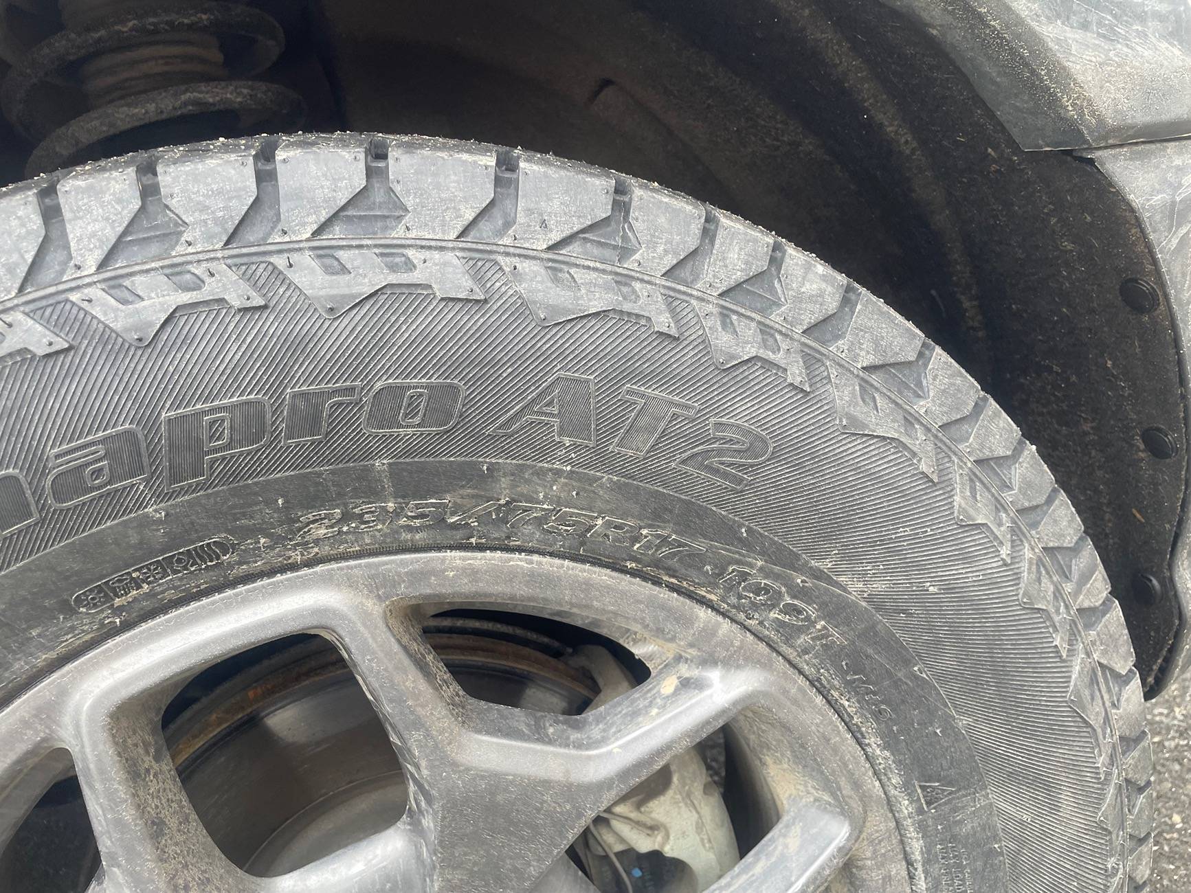

So I hang out with the local jeep camping club locally and some trips require 30+ inch tires to participate. So I went with 235/75r17s on my 22 badlands (lifted 1.5 , though lifting won’t effect max tire size). There is very slight rubbing at full lock (and I don’t like to drive there) so I’m not concerned. The factory 235’s were at 3/32’s and I got a great deal on the hankook
The AWD system is quite capable particularly when I lock it in so im not terribly concerned about my lack of true 4x4. I also am more comfortable being the only body on frame vehicle in the bunch. Plus im also the only person who can get 25MPG on the trips.
Photos for how well.
Photos for evidence.

The felt fender liner is being brushed by the inside treads at full lock And about 1/16th turn before.ill gwt a photo later today . The liner has no dirt on It There is how I know.

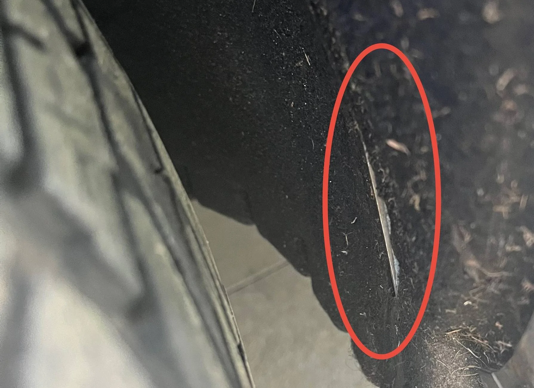

Careful. The pinch weld is right against the felt liner. Could cut your tires.

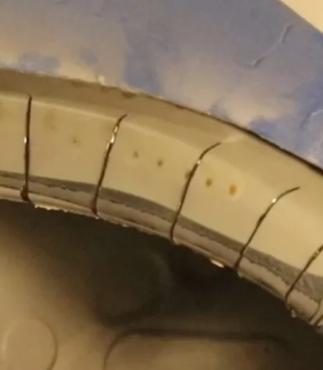

I plan on cutting slits like this and hammering it over flat. Then have the area sprayed with line-x bed liner.

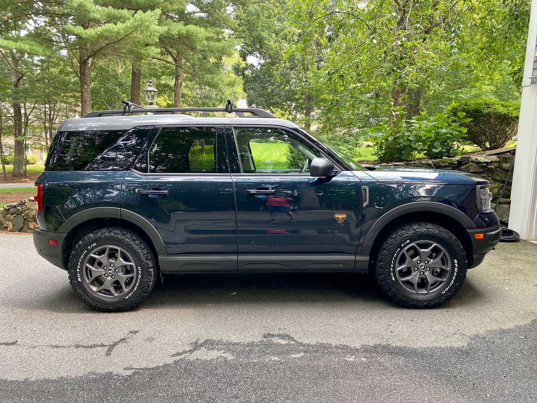

235/70R17 or 245/65R17 won't rub on a stock BS BL or FE
235/75 is way too big
