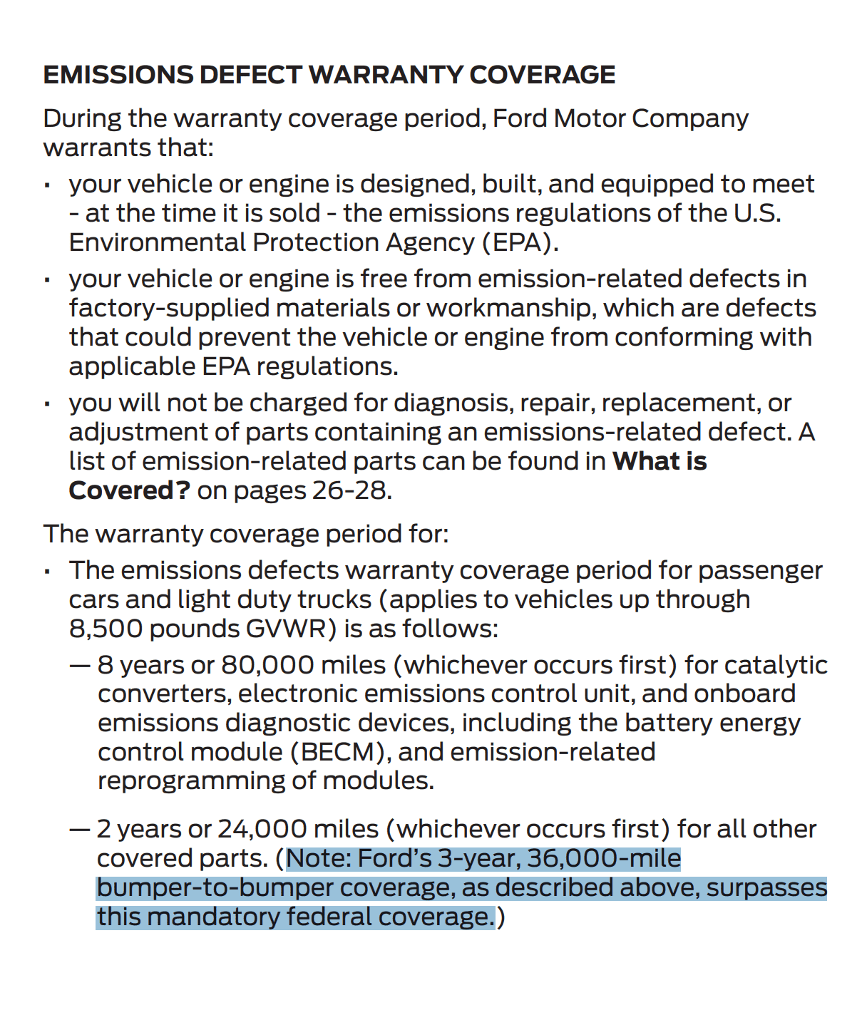

Which is why I specifically responded with a question to him on that same post you are highlighting. Thanks for the link. See page 23.👇
The warranty coverage period for: • The emissions defects warranty coverage period for passenger cars and light duty trucks (applies to vehicles up through 8,500 pounds GVWR) is as follows: — 8 years or 80,000 miles (whichever occurs first) for catalytic converters, electronic emissions control unit, and onboard emissions diagnostic devices, including the battery energy control module (BECM), and emission-related reprogramming of modules. — 2 years or 24,000 miles (whichever occurs first) for all other covered parts. (Note: Ford’s 3-year, 36,000-mile bumper-to-bumper coverage, as described above, surpasses this mandatory federal coverage).
.I read this as the EVAP valve being covered for 3 years.

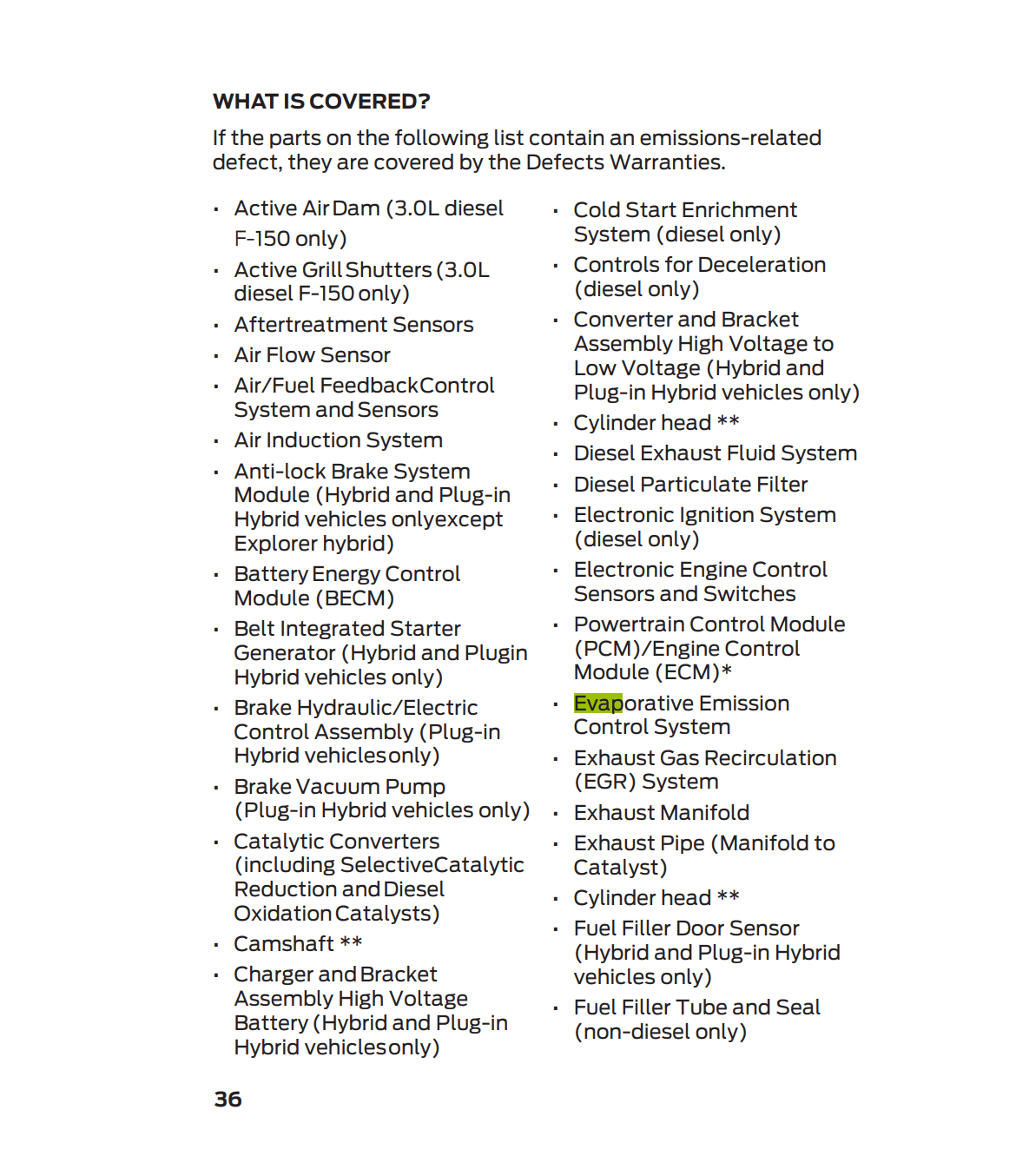

The EVAP valve I suppose is considered a DEFECT warranty, which has the superceding disclaimer. The PERFORMANCE warranty does not have the same superceding disclaimer about the factory bumper to bumper
Have to look at the table later on in the warranty which lists the parts specifically covered and the others fall into that 2yr/24 months that mark stated
he has owned fords forever and maybe is stating from experience 😉
lol. I didn't know you were Mark's 'hype-man'. I posted the table in my previous post. I've owned Ford's too. If you've been following along to the rest of this thread, you should also know that I've replaced my EVAP purge valve TWICE on m Mustang. The first time it was on Ford's dime. Now, I can't say with absolute certainty that it was outside of 24K miles, but I feel like it was. So this is where "my experience" may have conflicted with "his experience" and I was asking him to clarify.
But again, I do appreciate the link and also the insight that Mark knows his stuff. 👍 I agree on that.
