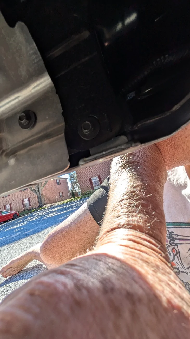

So it's a little more complicated than the front bumper. The bolts on the bottom, below the shackles, go through a collar that is reverse threaded into the metal bumper. The bronco bolt is pushed through this collar before going into the threaded hole. When you unscrew, you reach a point where it is unscrewed from the thread, but still pressed in the collar. You can pull the screw out at that point.

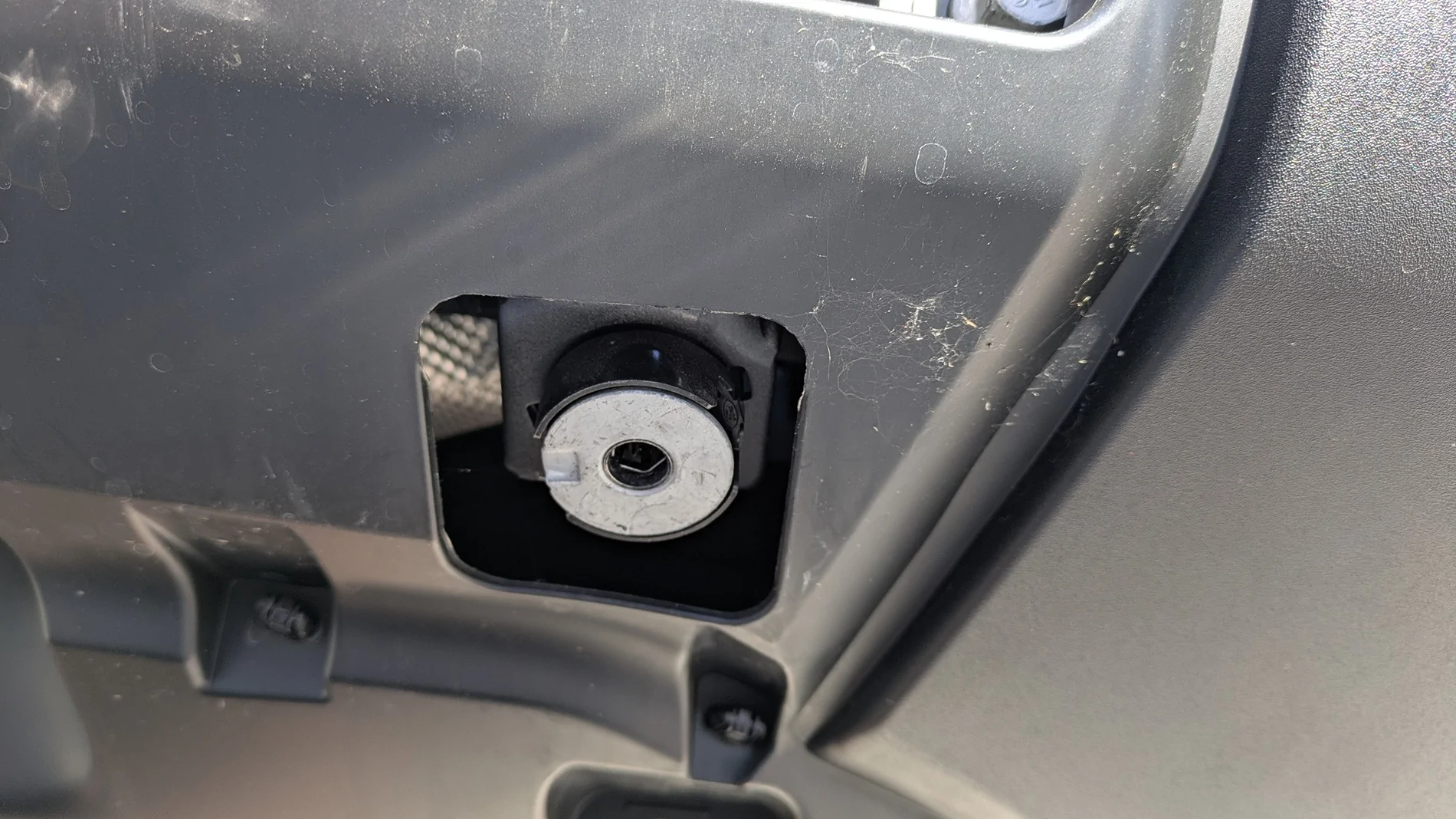

Here is where the small screws are in the back of the bumper insert. It's the black hex head screw in the black tab to the right of the silver piece. There is a u-shaped metal clip that the screw threads into on each tab on the bumper insert. Be sure you don't lose them, they are just held on with pressure.

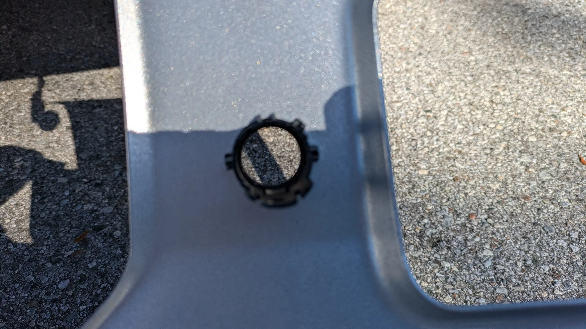

And here is the sensor holder. There are two little tabs, on top and one bottom. Be careful, they are soft plastic and you can easily push them up too much.
