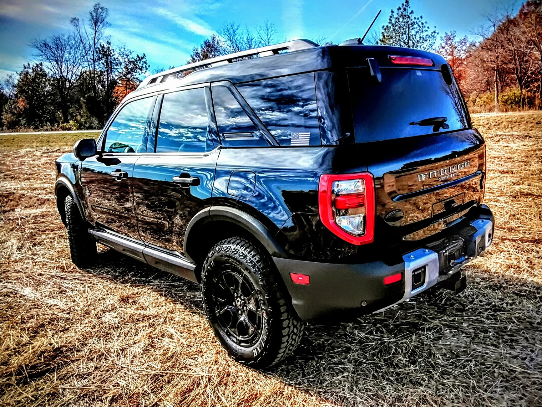

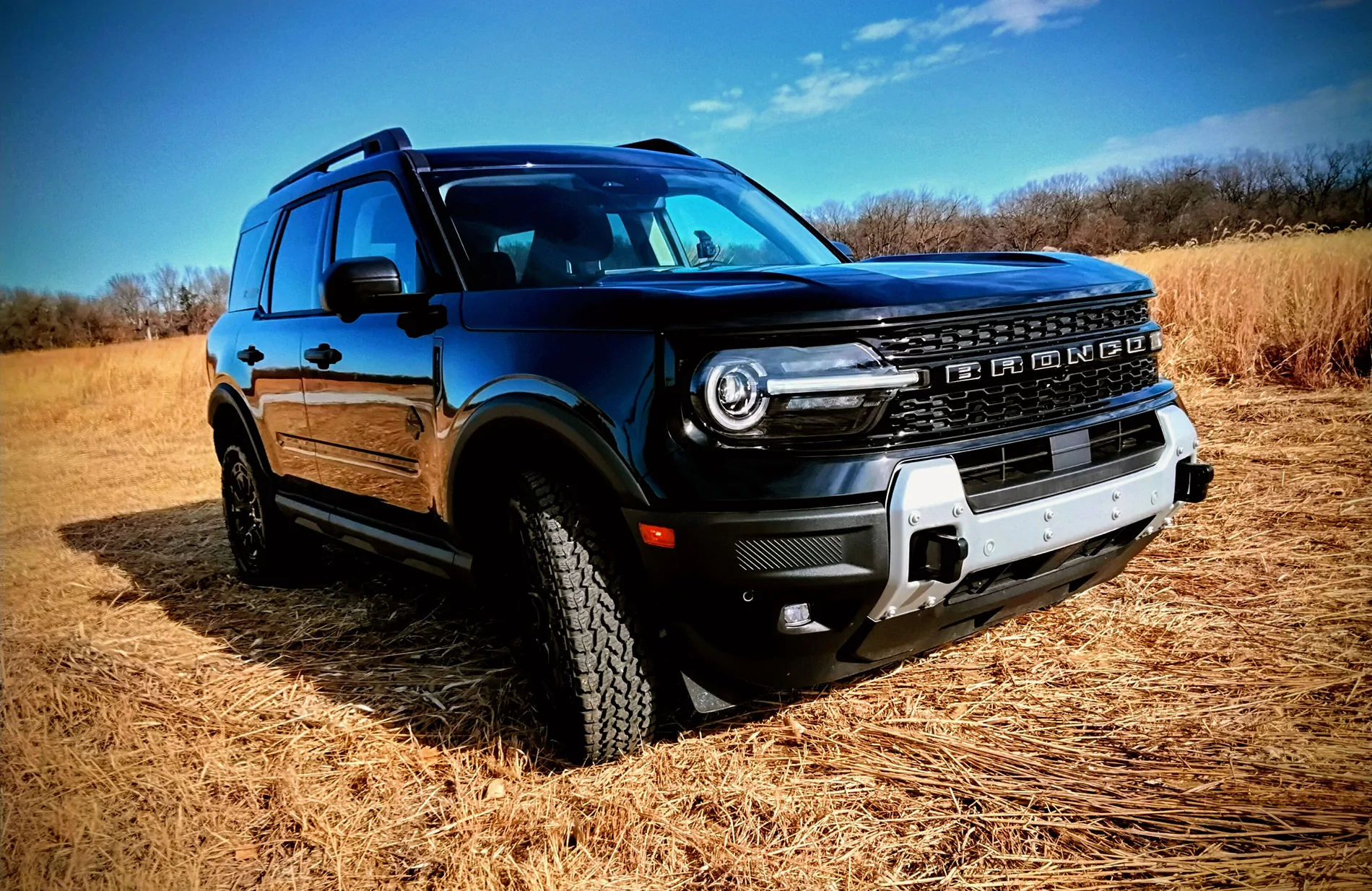

My 25 OB with SAS has the bar and the silver steel overlay bumpers. I took the bar off the first day - 4 bolts to the tow hooks (one member said that bar saved them when they hit a deer). But getting the steel bumpers off to paint them black is a problem. On the back bumper two of the bolts come half way off then spin. But to detach the sensors in the bumpers
Ford Bronco Sport 2026 BSBL on its way, new front bumper look? 20251111_130058~3
Ford Bronco Sport 2026 BSBL on its way, new front bumper look? 20251111_130516~4
the entire front and rear have to come off to unplug them. Had a quote of $1200 at a paint shop to do it but for that price I can live with silver.
I'm thinking about Plasti Dipping them in place but not sure how well that would hold up.

Plastidip will hold up well enough for daily use.
You’ll just need a handful of cans to spray it thick enough to handle the road wear, and allow for removal later on, should you choose to remove it. Bonus is, if you do get a “chip” in it, just spray that area again.
Downfall to plastidip is that it fades. I had my original grille on my fusion dipped for 2 years, and it still looked decently acceptable. It faded, but there were no chips. I had my wheels dipped for 3 years, and they still looked good.
You will want at least four layers with the spray cans to make a thick enough coating, I did two layers on my wheels and spent 6 hours removing it when my lease was up. 🤣 an absolute nightmare.

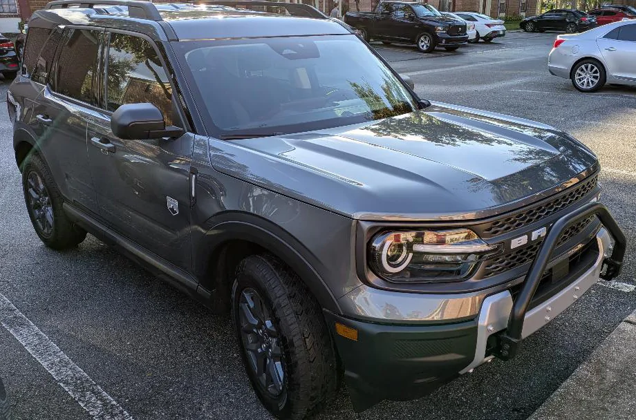

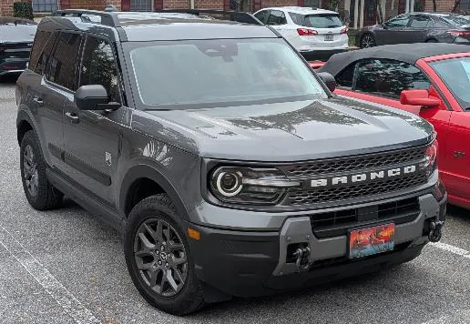

I got rid of nudge bar and painted the shiny silver stuff a charcoal gray. I think the bumper inserts and tiedowns look a lot better toned down.
Original:
Ford Bronco Sport 2026 BSBL on its way, new front bumper look? OriginalVehicl
Painted:
Ford Bronco Sport 2026 BSBL on its way, new front bumper look? Bumper
Looks like you don't have sensors in your bumpers. Were you able just to unbolt and remove the steel inserts or did you paint them while still on?

This is a big bend with black diamond package, without sensors. I was able to totally remove and prime and paint. Eventually I will have everything stripped and powder coated. I have not done the rear yet, been sick. There are sensors in the rear insert. If you want, I’l let you know how it goes. It will probably be a week or two though.

looks good what paint did you use?
I washed it down and scuffed it up with the maroon scotchbrite pad, about 200-400 grit, I believe. Then I washed it again and wiped it down with rubbing alcohol. Then I primed it with two coats of Rust-Oleum Universal Bonding Primer. I let it dry for a about a week, then lightly hit it with the scothbrite pad again, and wiped it down with a damp cloth, then rubbing alcohol again until it was clean. Then I gave it two coats of 2X Ultra Cover Charcoal Gray Satin.

Yeah, let me know. I couldn't get a couple of bolts in the rear off, they just spun in place. Body shop told me the biggest cost in their bid is how much they needed to take off and put back on just to get to the sensor plugs.
