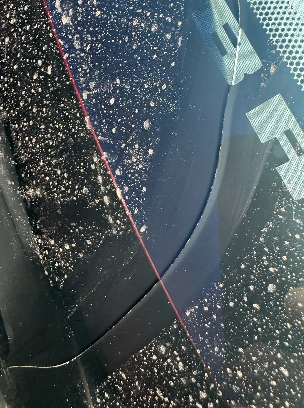

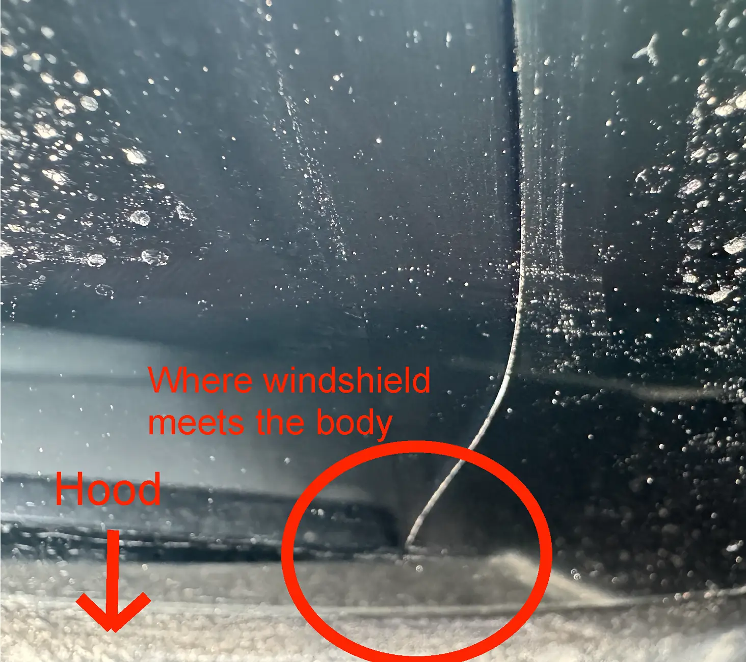

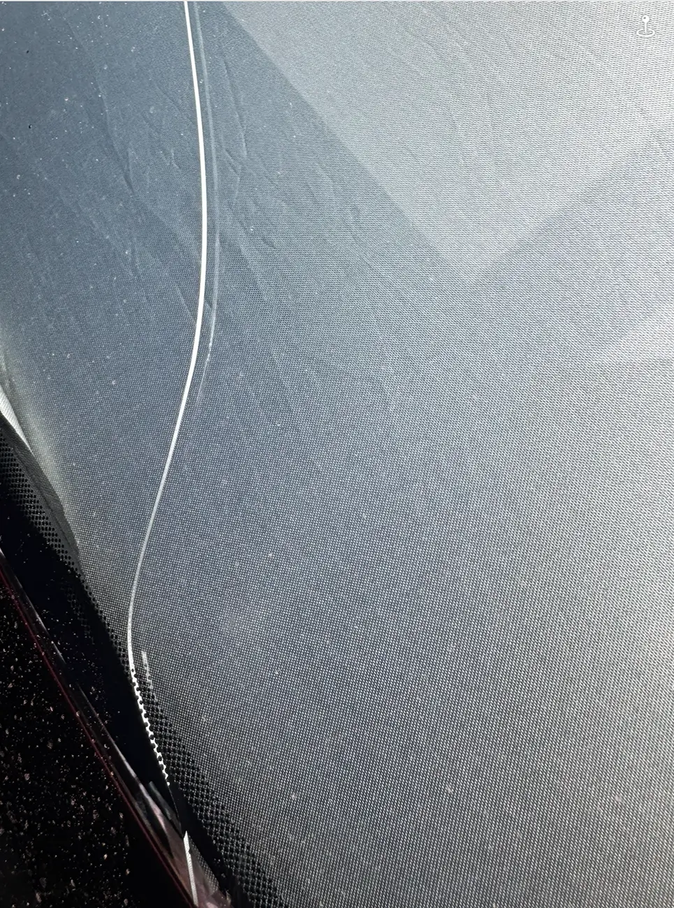

2026 Bronco Sport Badlands. Purchased new March 2026.
The car had not been driven since Saturday. There had been no weather (hail, etc.). Temperatures were 70s overnight to low 90s during the day. Came out yesterday morning (Monday) and found an 18 inch crack on the driver's side starting from the bottom and up vertical about 18 inches. Appears to be a spontaneous windshield crack.
Anyone else?
We're trying to make a warranty claim, not a damage claim. There's precedent for new car windshield stress fractures.
UPDATE: Dealer did pin test, took photos and submitted to Ford for warranty claim. Ford responded within hours and approved the windshield replacement under factory warranty. 10 to 14 days to get the replacement windshield to the dealer for replacement.
