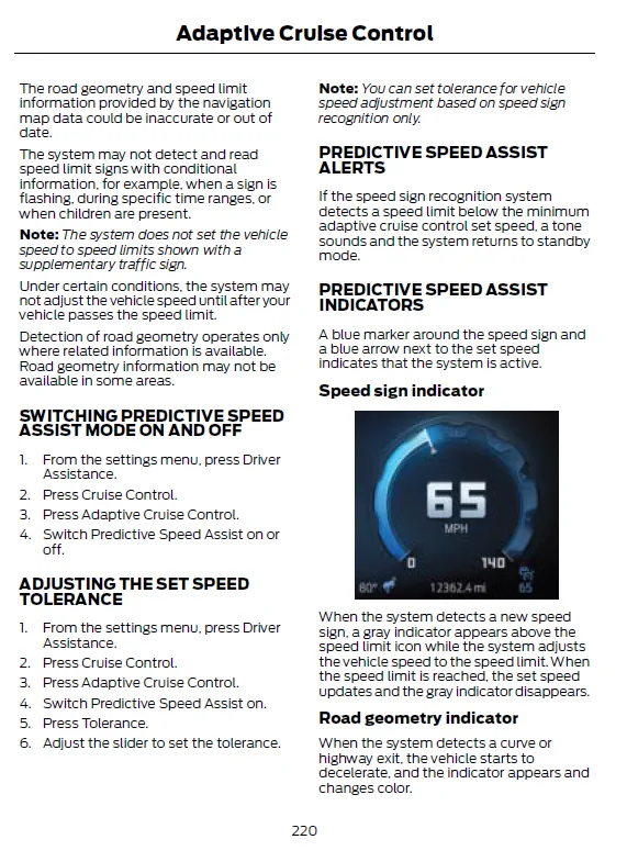

While we are on the subject, has anybody else noticed that when there are several posted speed limits, ie (65 min 45, trucks over 4 tons 60)that the system reads or thinks that the speed limit is 60 and automatically slows the car to 60 when ACC is activated. Is there a way to change that ? It’s annoying. You’re taveling at 65 and all of suddek it slows to 60 because the sigb says 60.

Haven't encountered any dual-speed zones yet. In addition to setting a tolerance (+/- speed limit), you can disable the Predictive Speed Assist entirely if you find it too bothersome:

Thanks, i‘ll look into that setting. All of the interstae in the chicagi area have dual zones, or seems to

I would strongly suggest that you deactivate the predictive speed functions. They can cause things to happen that you aren't ready for. It can also result in your vehicle doing things that are not proper for your vehicle depending on current traffic conditions.
Yup! I had to turn that off. I was on the highway cruising at 65 mph and it picked up the 45 mph sign on the feeder and slammed on the brakes. I got off and turned it off right then.
