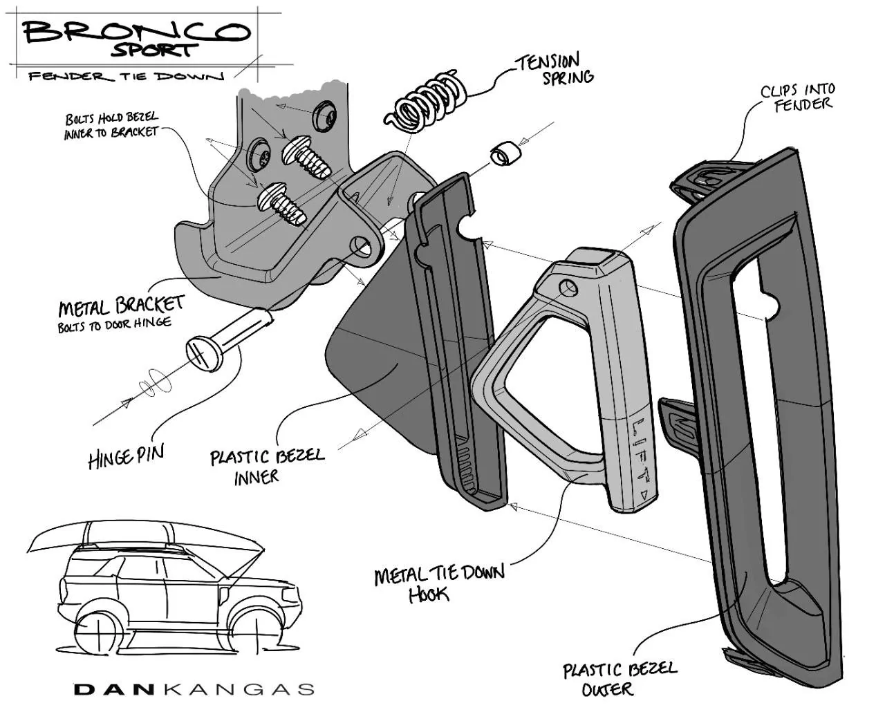

Eagerly looking forward to seeing if the 2025 side fender tie downs can be retrofit onto the first gen sports. Looking at the parts listing for the 2025’s, it looks like the tie down is a support braket that pokes through the fender, bolted through what looks like the door hinge? If anyone’s been able to see a 2025 in person, I’d love to get these suspicions confirmed.
Ford Bronco Sport 2025 Fender Tie Down Retrofit Diagrams IMG_4315
You can see in the assembly there’s the plain old fender badge that clips in, and one that has the support bolted to the body

All the parts are on backorder unfortunately. I also cant get anyone to get me a good picture of the assembly on the existing 2025's. Until someone rips one out of a crashed 2025, or someone gets a copy of the 2025 shop manual with the detailed diagrams, the answer is 'most likely possible'.

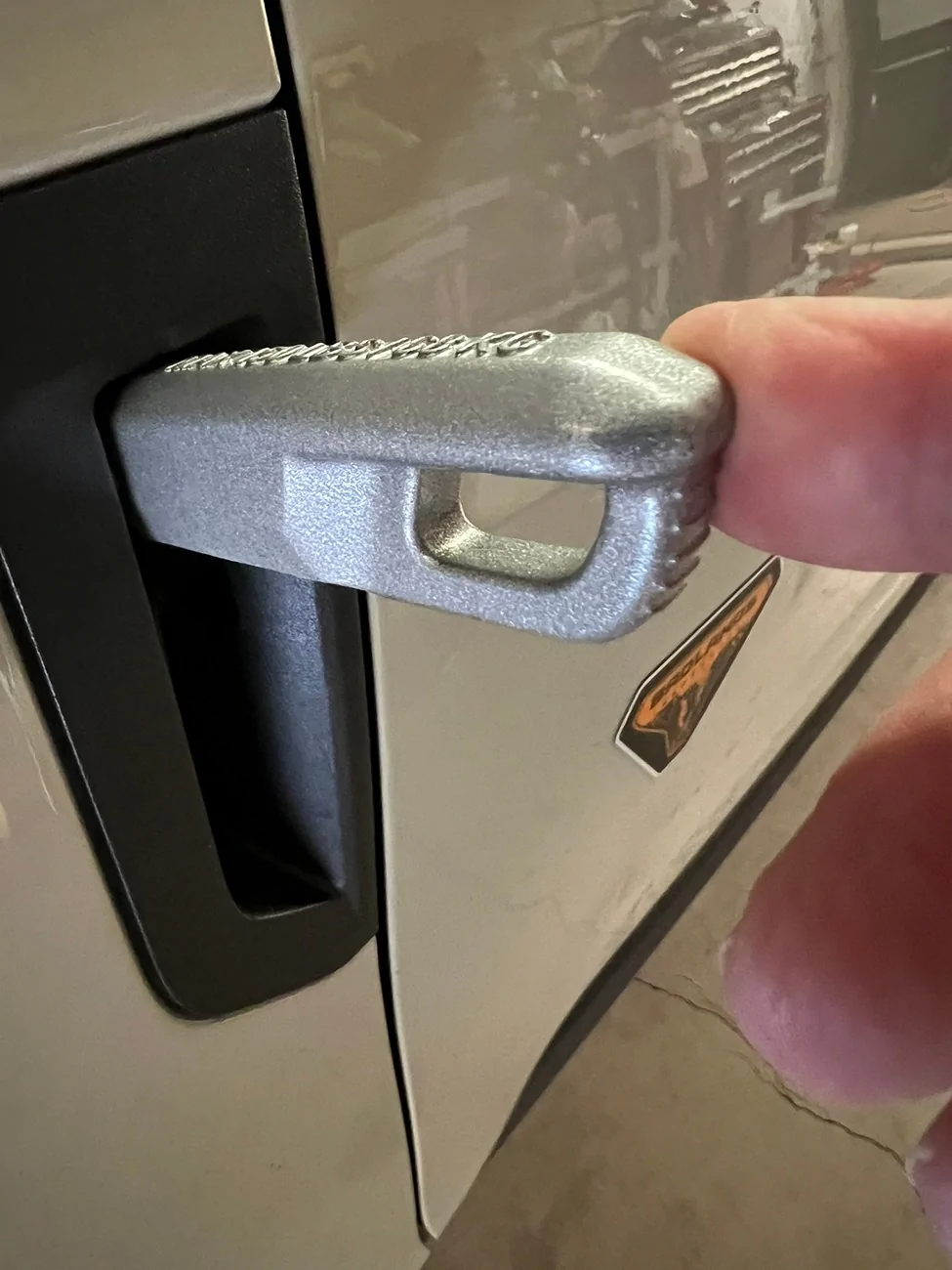

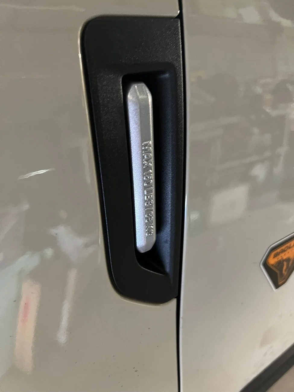

Not sure if you've seen one in person, but this isn't a DIY kind of thing, at least if you're trying to replicate it. It's a cast piece that pivots up from the top and is held in the stowed position by a magnet.
I can't show the actual mounting (I don't have the motivation to pull the wheel and fender well off as it's 110F/43C in my garage right now), but if you could get a look at a service manual you could see what additional bracket/brace materials are backing it (it's rated to 150lbs/68kg).
