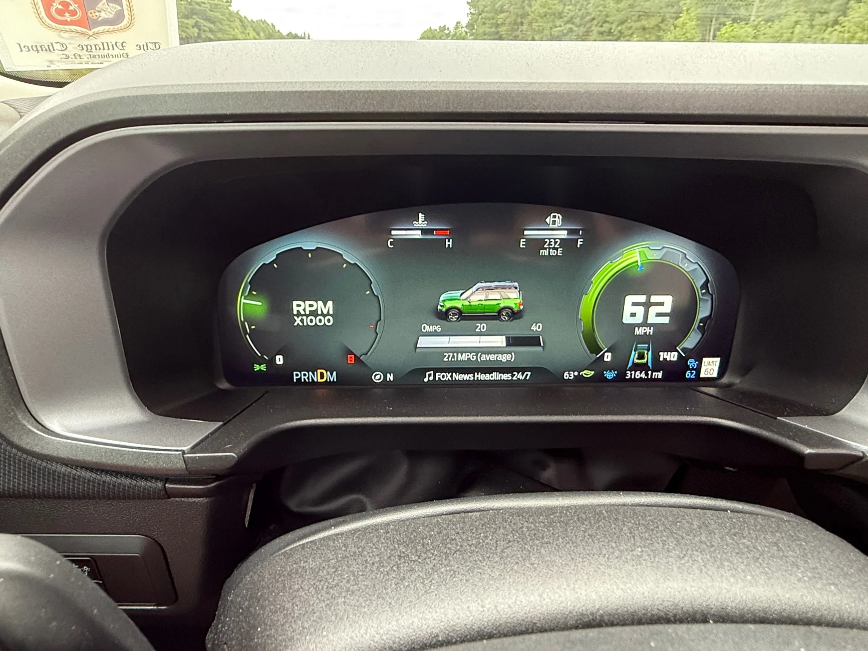

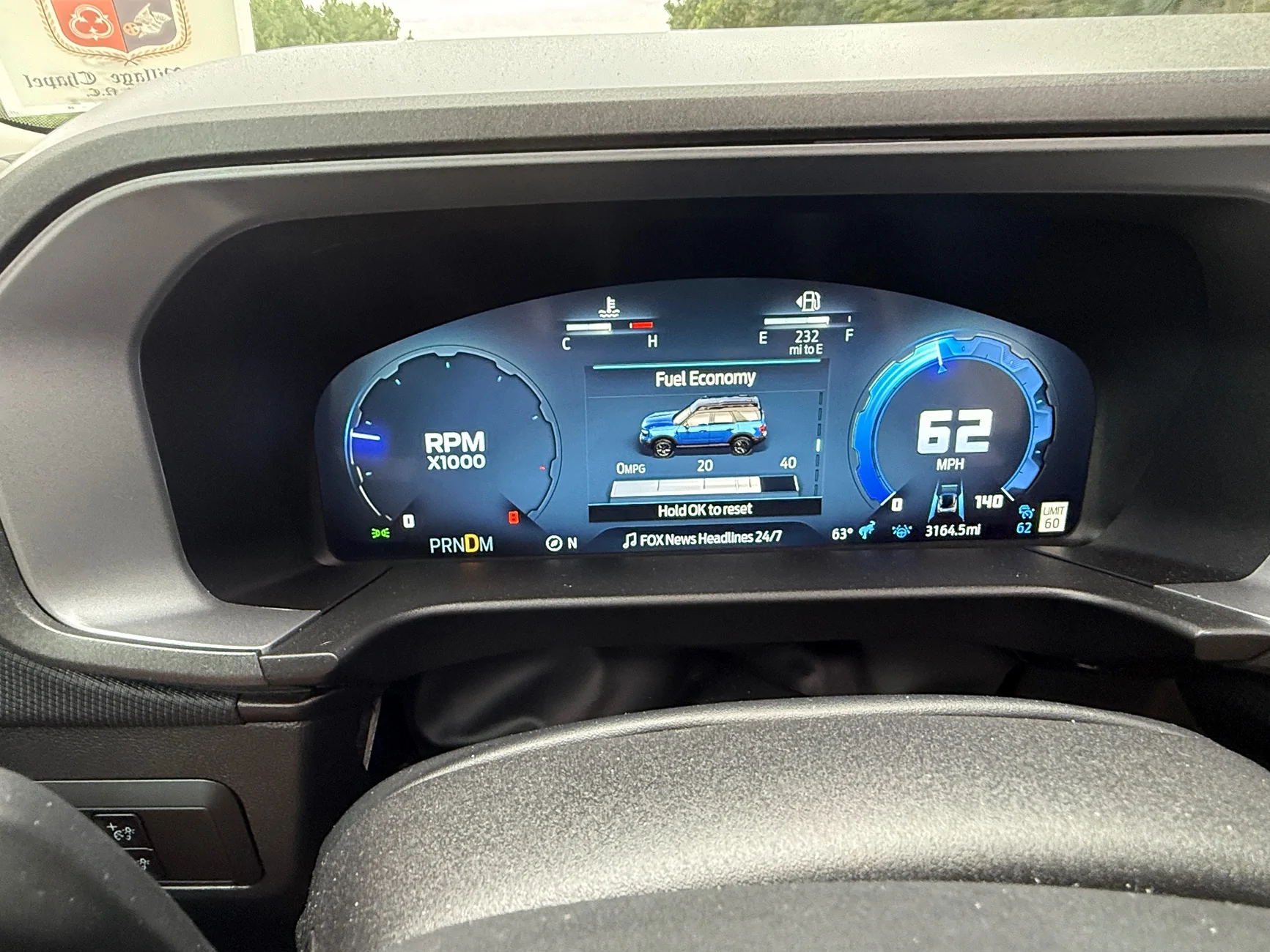

Today I started my 2025 BS BL Sq w/3,131 miles on it now and noticed the Tachometer and the MPH had no numbers on either display....I pulled over and turned off the Bronco got out and locked it. When I restarted it it was the same with no numbers. I drove 1.5 hours parked and was gone about 2 hours came back and they reappeared. While driving I tried three modes; Sport, Eco, and Normal all had the same issue. (see attached photos)
This is the first time I have seen this, has anyone else seen this anomaly yet? 🧙‍♂️

Yep, had this happen only once. Lost the numbers and color ring on the tach. Everything went back to normal the next day and haven’t had the problem since. I also thought it was in mid-update, and thankfully didn’t have to take it in to the dealer for a diagnostic. Other than that one glitch the BS has been flawless.

I must agree I love this Bronco very much, it is a gem. But when this happens you have to wonder what's next....I am sure it was an up-date but will never know.

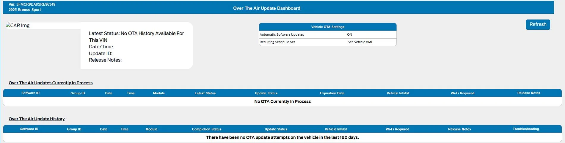

If the architecture on these is anything like the 2024/2025 Mustang, F150 and Mach E (which I am pretty sure it is), the IPC is now controlled by the APIM, so yes. On the F150, you hold down radio power button and forward seek button simultaneously to reset the APIM.
To the owners who had the odometer glitch: If you message me the VIN, I can pull up the OTA dashboard in PTS to check if the truck did indeed get an update or not. OTA history stays recorded in PTS for 60-90 days at a time.
Ford Bronco Sport 2025 BS BL SQ digital display missing its numbers on tachometer and m.p.h. Untitled
Let me know if you can find anything, that would very nice of you.
Vin# 3FMCR9DA8SRE96349

No OTA history recorded for you. It is also not reporting any codes.
Maybe it was just a glitch in the matrix.
Ford Bronco Sport 2025 BS BL SQ digital display missing its numbers on tachometer and m.p.h. 1756522757636-5
Well, Thank you very much for this data.
You are the few who make this forum a great place to be a member. Happy Labor Day to you and your family.
