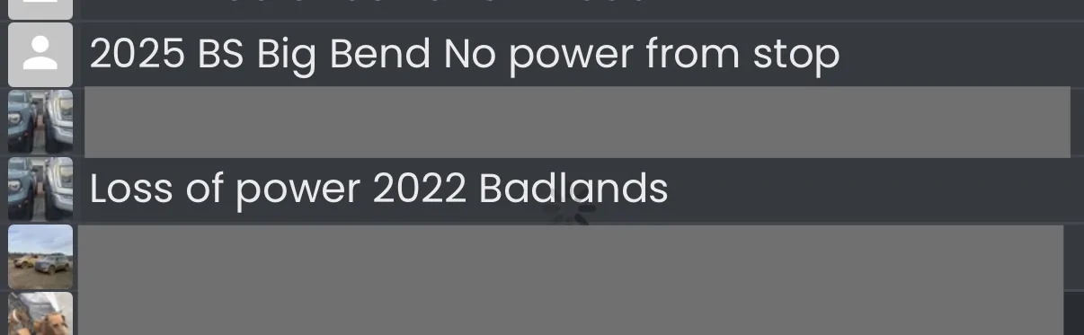

Check out this thread - is for the badlands so different engine, same transmission as yours
Ford Bronco Sport 2025 BS Big Bend No power from stop IMG_8874
