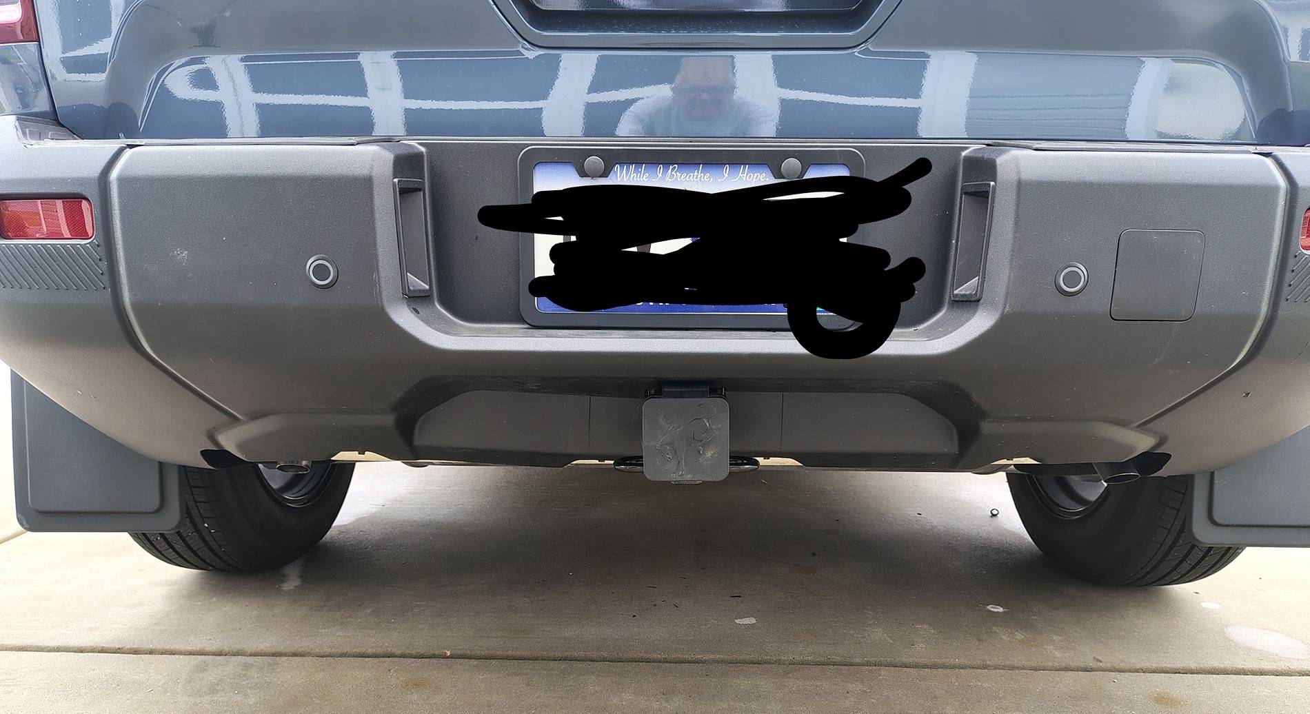

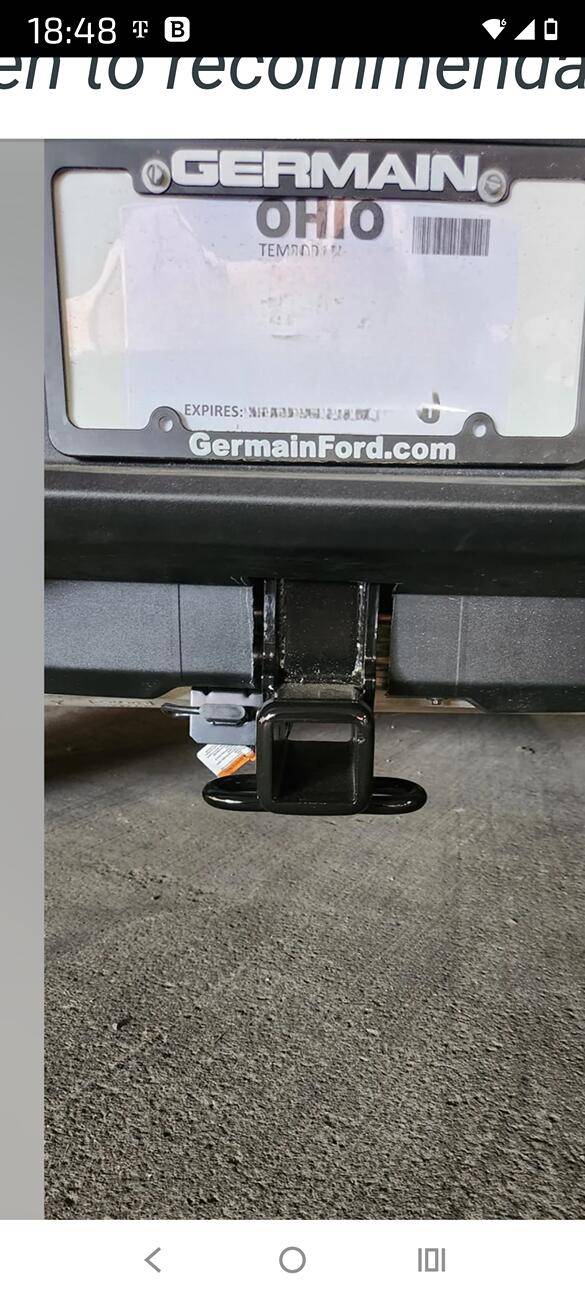

Here's a picture of the Drawtite 76436 installed on 25. You can see it's much too low.

Here picture from another member. Just doesn't look clean being this low. Probably going to hit ground first time on the trail.

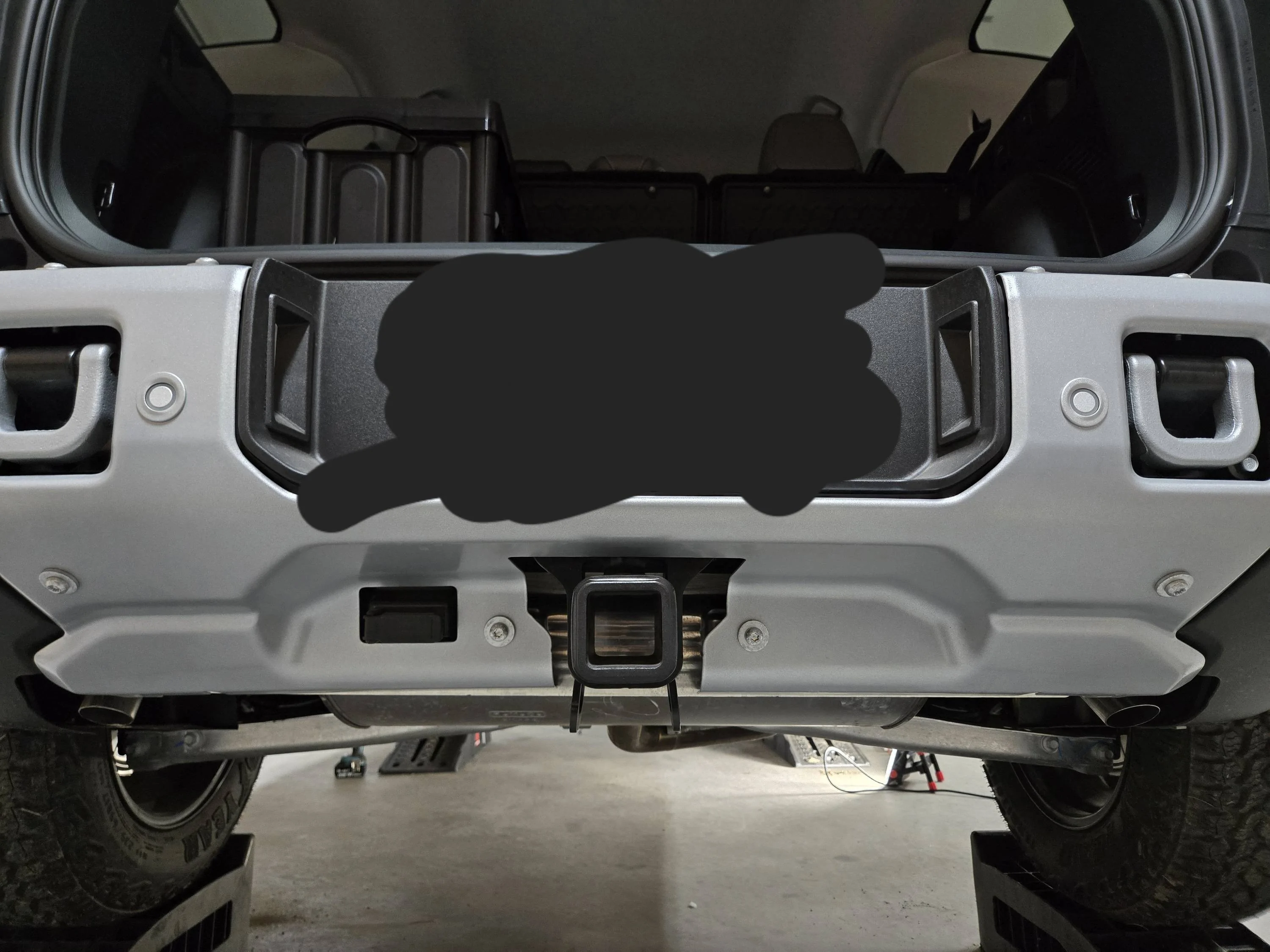

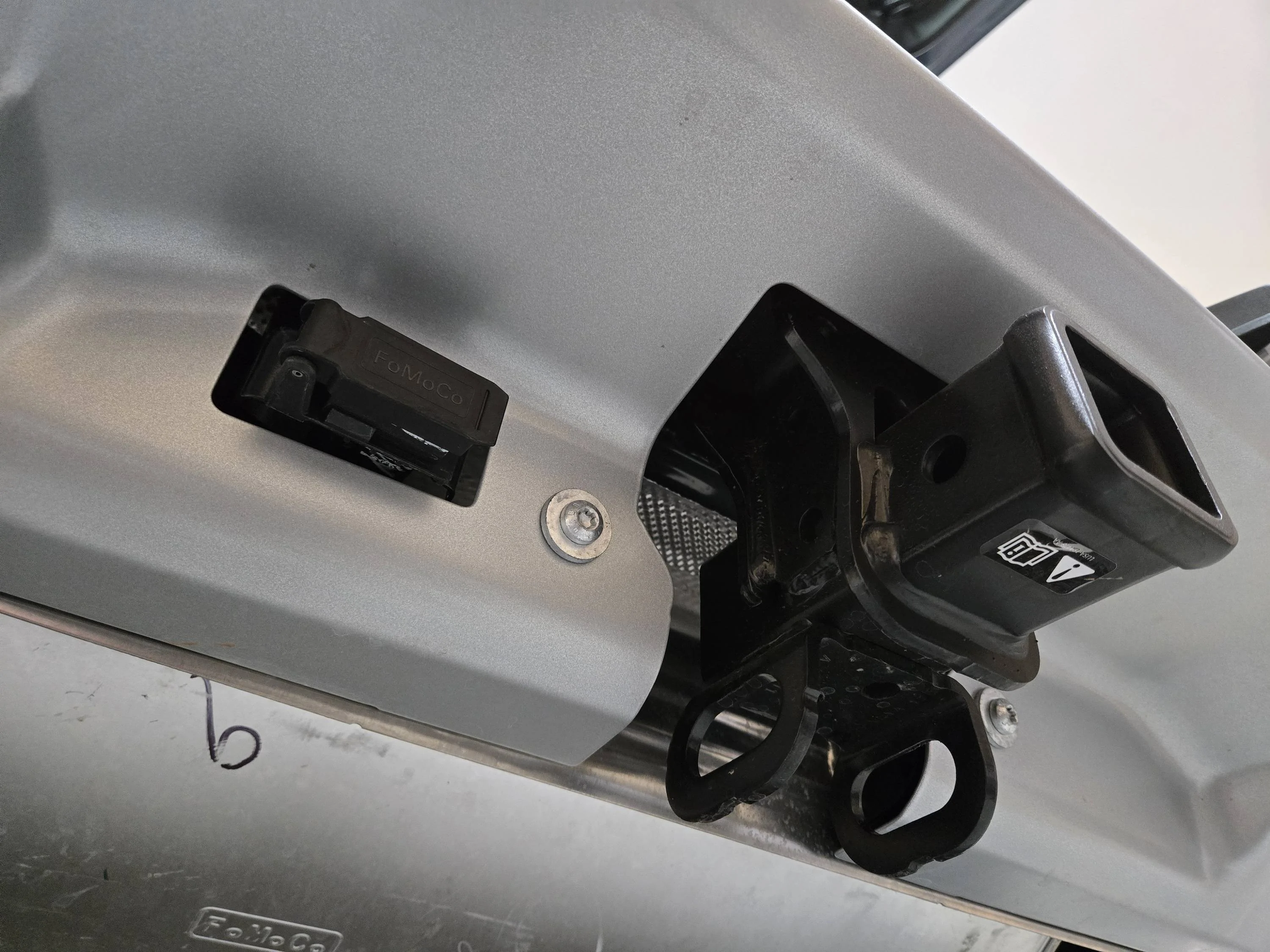

If that can give you an idea of the factory installed hitch height on 2025 BL.
Ford Bronco Sport 2025 Bronco Sport Trailer Hitch jpMtjhF
Ford Bronco Sport 2025 Bronco Sport Trailer Hitch jJlQ5Oa
Ford Bronco Sport 2025 Bronco Sport Trailer Hitch XfW9WCx
Thanks for pictures. Boom... nothing like factory OEM.
Of course that's with the Black Diamond or Sasquatch pkg?
25 BS Outer Banks bumper is slightly different size and certainly doesn't look that cool.
Thanks again ?

Sasquatch pkg.

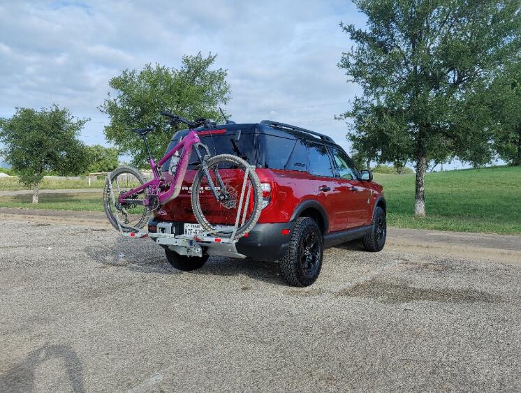

try uhaul i bought their hitch with install
preserved my ride height -2024 bb
that's who does all my hitches.
Ford Bronco Sport 2025 Bronco Sport Trailer Hitch 20250423_182114[1]
Nellie123
Gary
Apr 22, 2025
29526
2025 Bronco Sport
Thanks. That's a classic version of Drawtite 76436. Looks great on the 24 because your bumper skirt is at least 3" lower than 25. So....the 7.5" drop looks factory on the 24 but would be 2.5" lower than the bumper trim on the 25( like the picture of Germain Ford above that looks crappy).

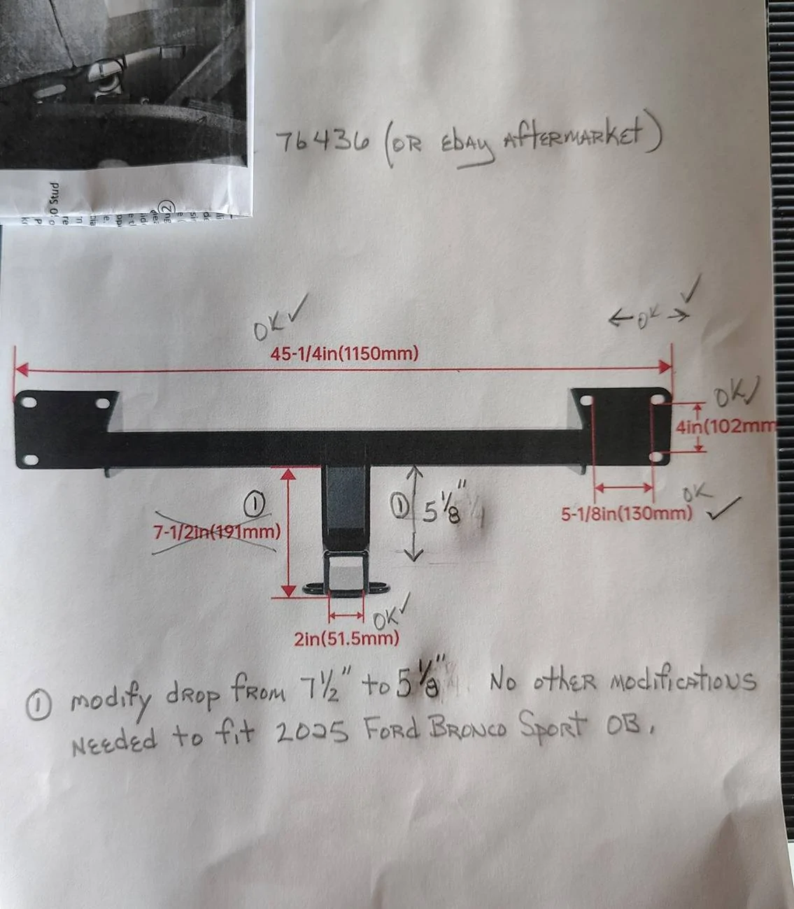

Ok folks. We're talking 2025. Not 2024. Only current hitch that is available with a OEM finished look for the 2025 Bronco Sport is Fords OEM hitch SZIZ19D520A at a cost over $400.
I however cut and modified a 76436 hitch to fit and look OEM for less than $150.
I've attached drawing and picture of finished look. Use it if you are handy and want to save a lot of money.
I'm done beating this subject. Happy Trails.
