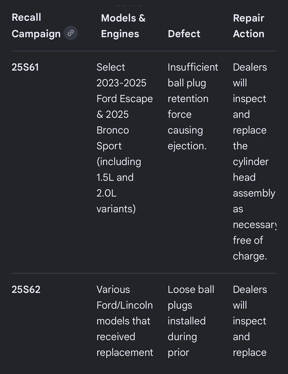

Do you have that recall # (.. cylinder head) for 2025 Bronco Sport 2.0L engine?
EDITED: never mind, found this:
… issued Safety Recall 25S61 (NHTSA Recall 25V343000) for select 2025 Bronco Sport vehicles equipped with 1.5L or 2.0L engines. The cylinder head may have been improperly manufactured, allowing ball plugs to fail and causing an oil leak. Ford's identifying recall number is 25S61.

Hi all, hope you are able to give me some advice on my situation. I bought this car about a month ago - currently it has about 15,000 miles on it … noticed the coolant was leaking into the cylinders. They say it needs the head gasket replaced.
For your 2025 Badlands 2L, check the Ford and NHTSA websites (not Ford App) to see if Recall 25S61/25S62 is applicable to your VIN
https://www.ford.com/support/recalls-details/
These links probably probably 1.5L related but appears some 2L vehicles are impacted
https://www.broncosportforum.com/forum/threads/25-bronco-sport-bb-recalls.18588/
https://www.broncosportforum.com/forum/threads/new-recall-for-1-5l-mpc-2025.16065/

I did check on there - no outstanding recalls for mine. I can’t tell if it’s ever had any recall related repairs however - there’s very limited service history listed in my account.

I did check for recalls - no outstanding ones listed for my VIN. But I can’t really say if it was previously repaired because of a recall. Very little service history listed on my account.
113
4,682
5,712
That recall listed a very small number of 2025 Bronco Sports so not surprising… unless as guessed in an earlier comment that more Sports are implicated
