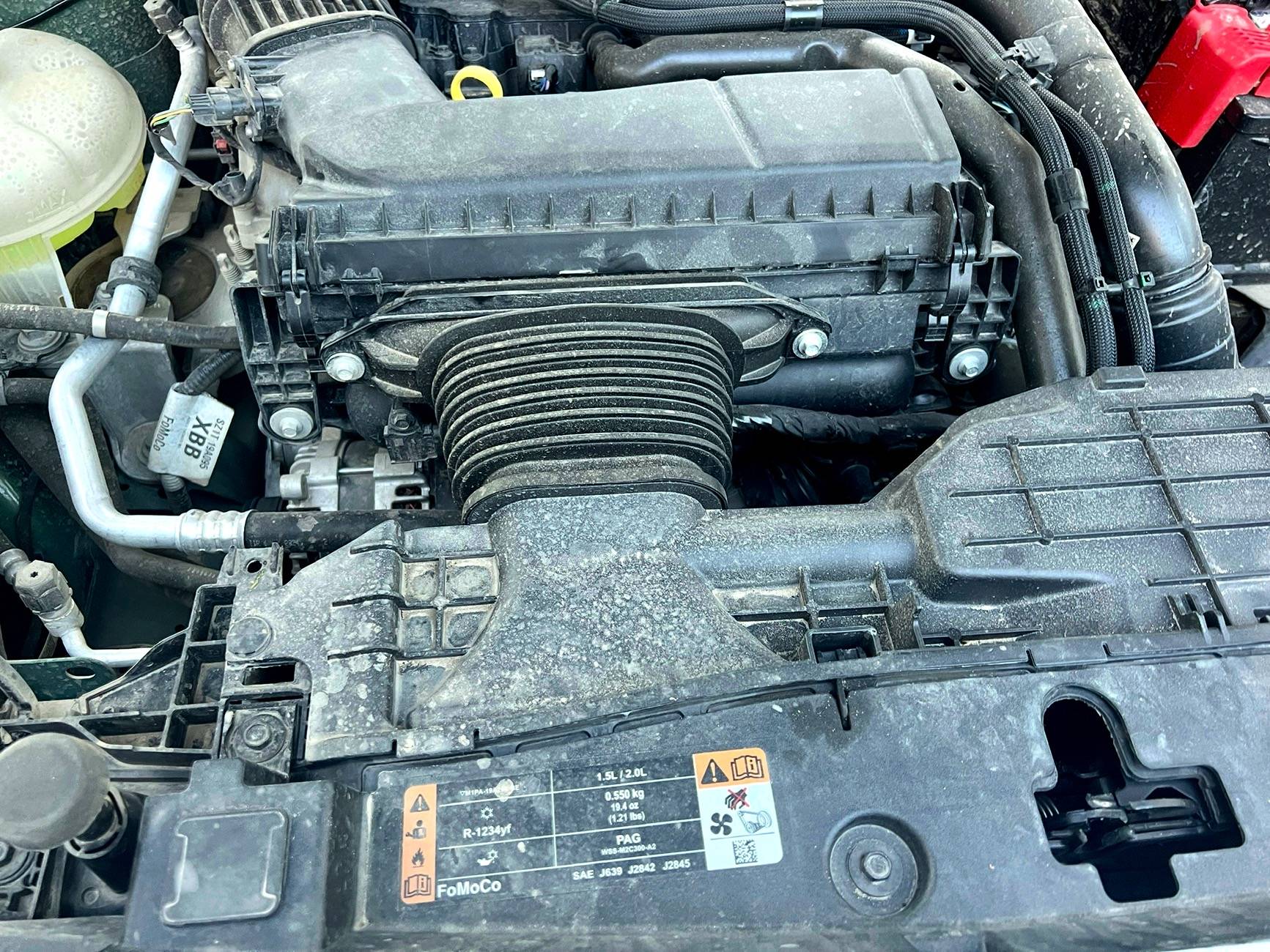

So after Saturday’s adventure with the water washing over the hood I decided to take a look at the air box to see how much water got in

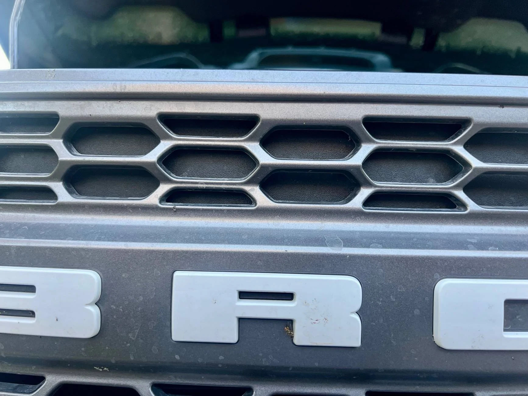

at first look the intake looks like it take air in straight through the grill
but that’s not the case. The grill is not open up top

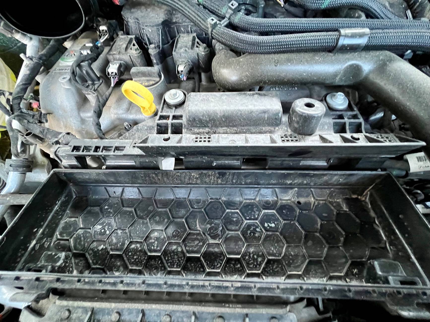

Next I opened the air box. The bottom does show signs of getting wet. Notice the drain hole top right.
the air filter showed no signs of water stains or damage so I don’t think it got all that wet if it got wet

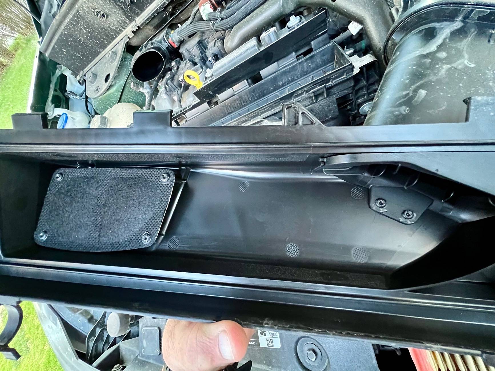

finally looking at the top and intake tube they were spotless.
Finally the top is much easier to open if you loosen the hose clamp!!!
