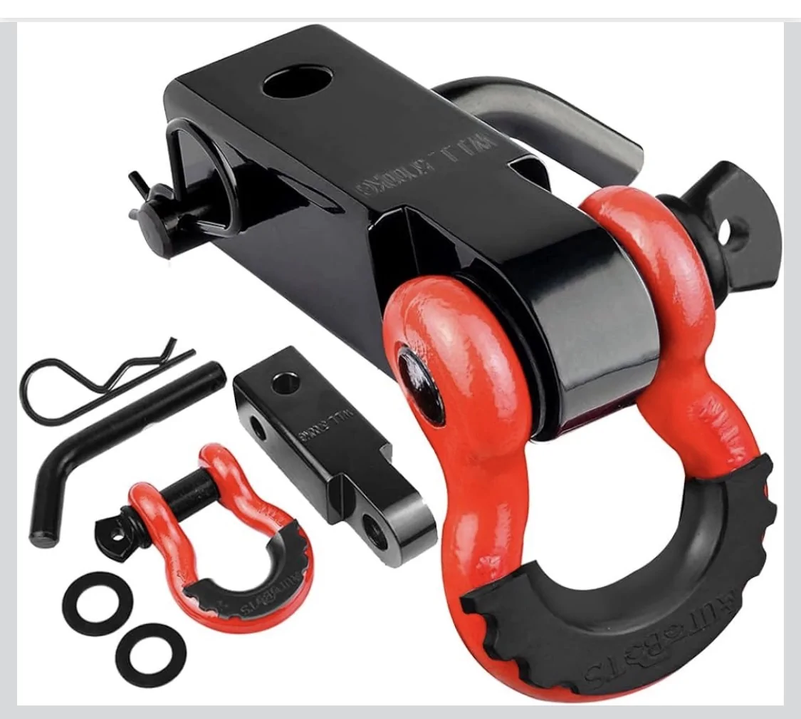

I think only the ā€˜25+ Sasquatch has dedicated recovery points in the rear. A rear trailer hitch with a D ring adapter is the easiest thing to add in back. You can add one of these to any trim with a trailer hitch. Never use the tow ball for recovery though. they’re not intended for that and have broken off and killed people. One of these will do the trick.

Be careful with a hitch
https://a.co/d/07RKl0Bb

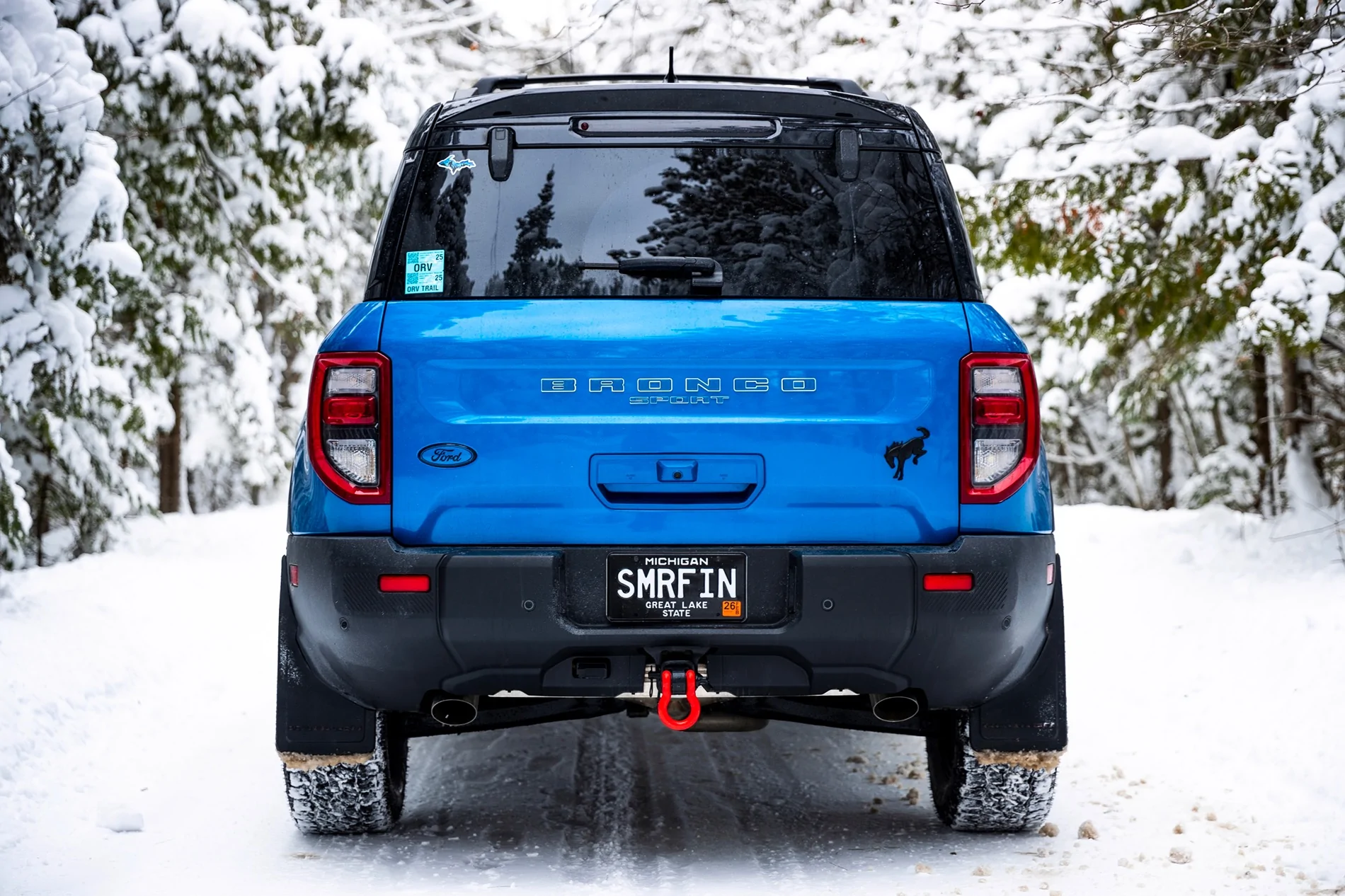

That’s what I’ve got.
