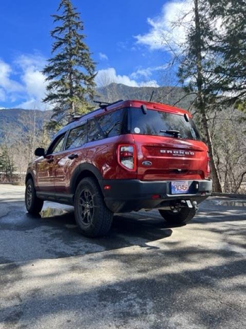

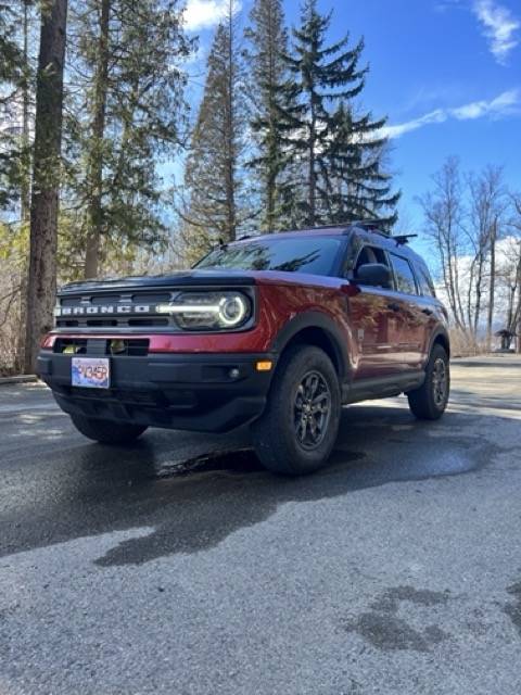

Hello,
This is my 2022 Big Bend.
After purchasing in August, I have added the Rough Country 1.5" lift and larger tires.
In the winter I ran the Conti Vancontact Ice (235/60R17) as I needed the 10ply per the roads that I regularly drive on.
The current tires are a 245/70R17 Goodyear Wrangler Kevlar. I have seen a thread stating that this size will not rub. Trust me, they do. It is fine for highway and around town, but once you turn the wheel more that 3/4 of a turn they start to rub. It isn't too bad, not enough force to pull out the liner or anything, but I am keeping an eye out on the wear and will update.
The build is not complete, just waiting on an appointment to have the mirror caps painted body colour and the grille black. Also have a spare tire carrier coming soon.
What do you think?
