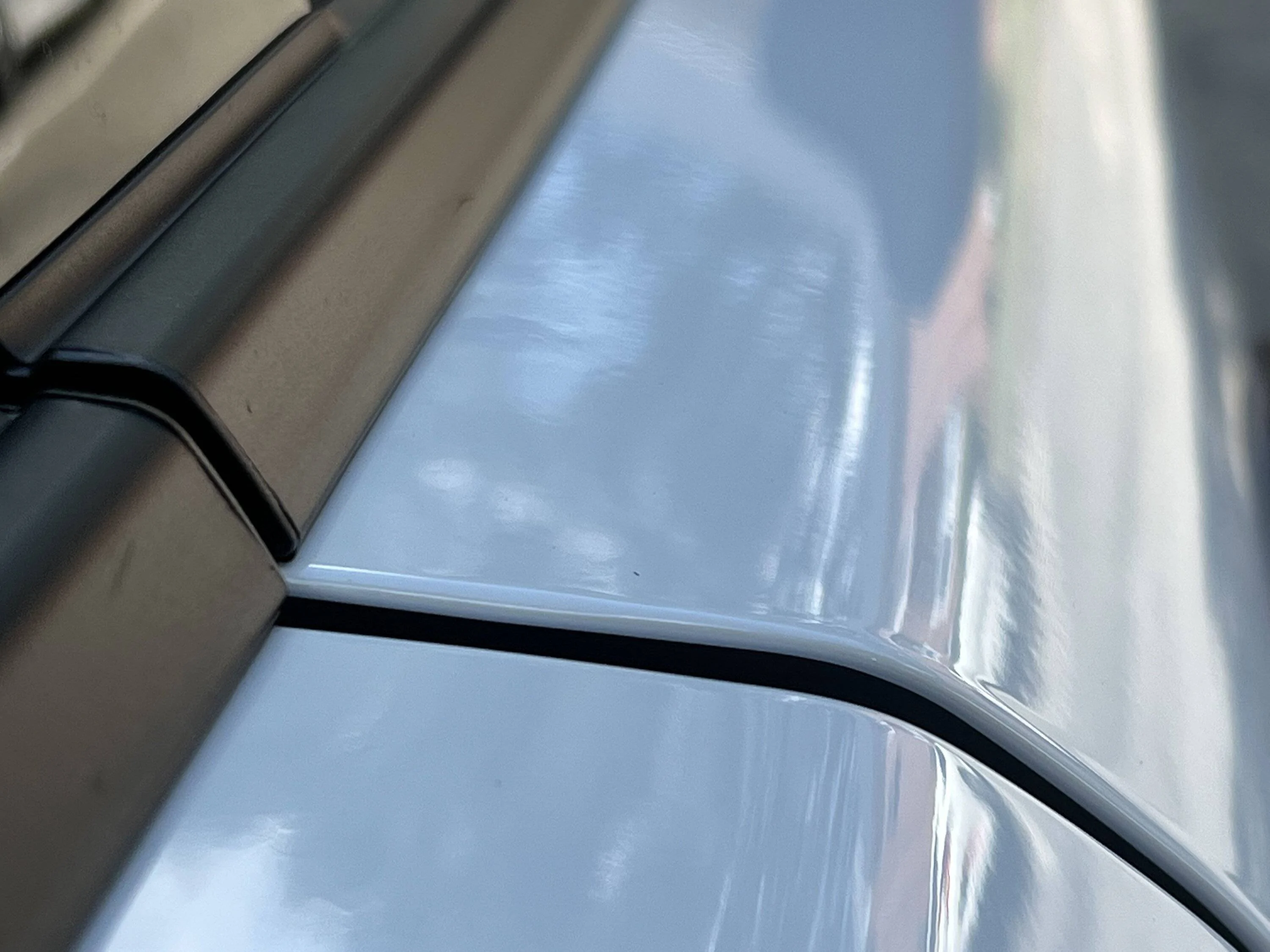

First-time poster here. Thought I would combine my observations/issues with the Bronco Sport after 10-months of ownership. Overall, I enjoy the vehicle but there are quality issues that cause one to scratch his/her head. Input is welcome!

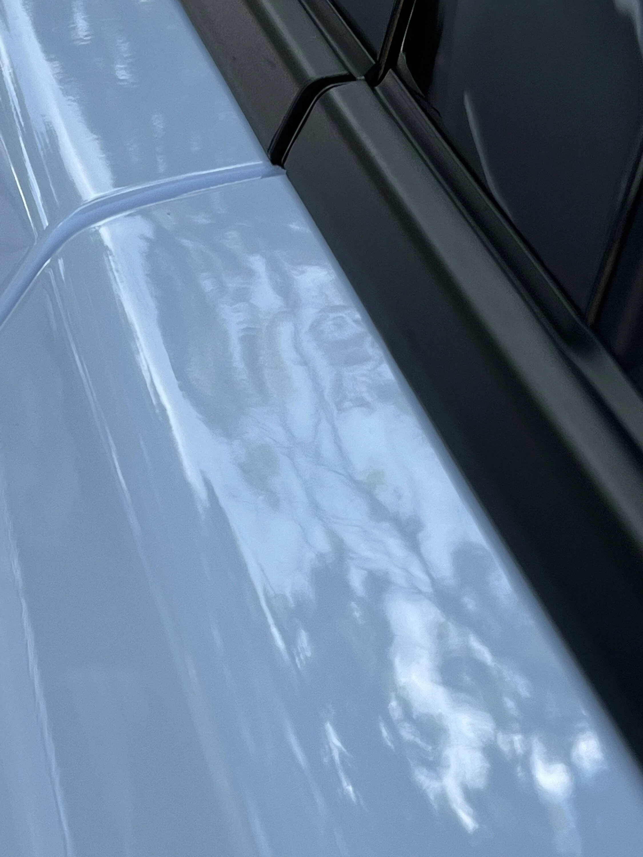

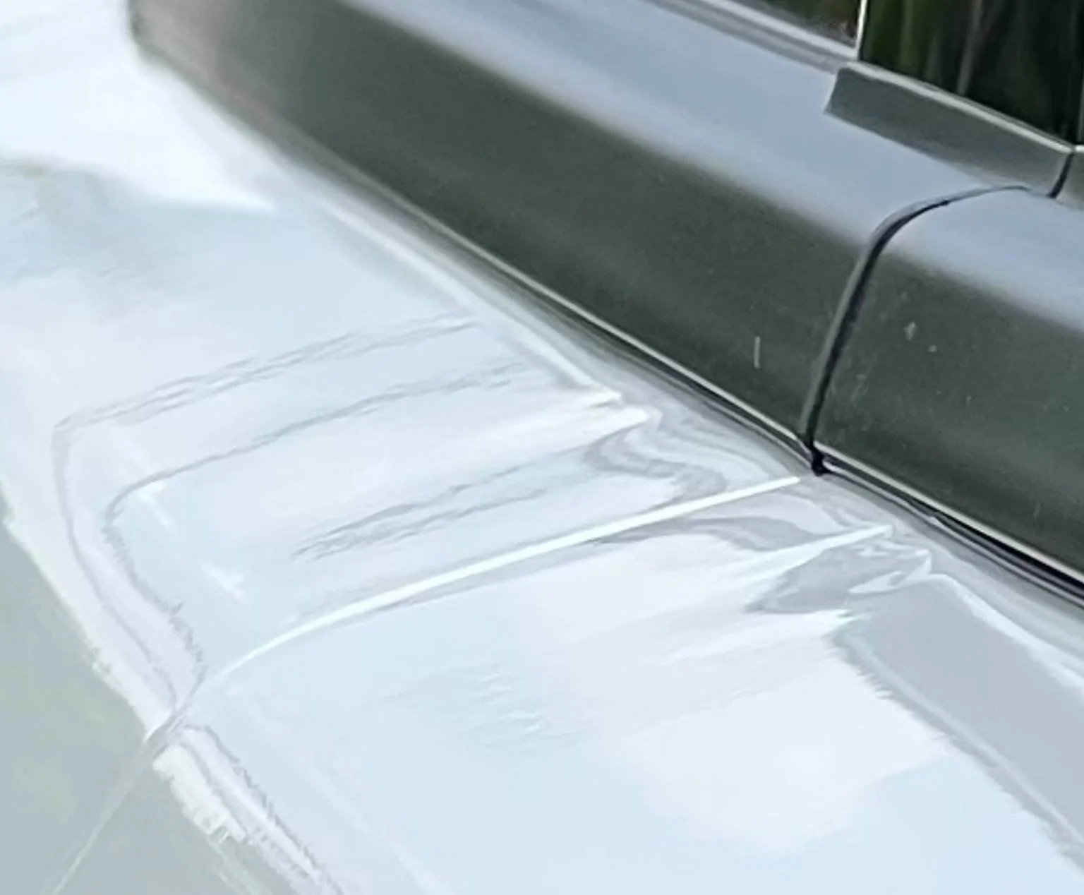

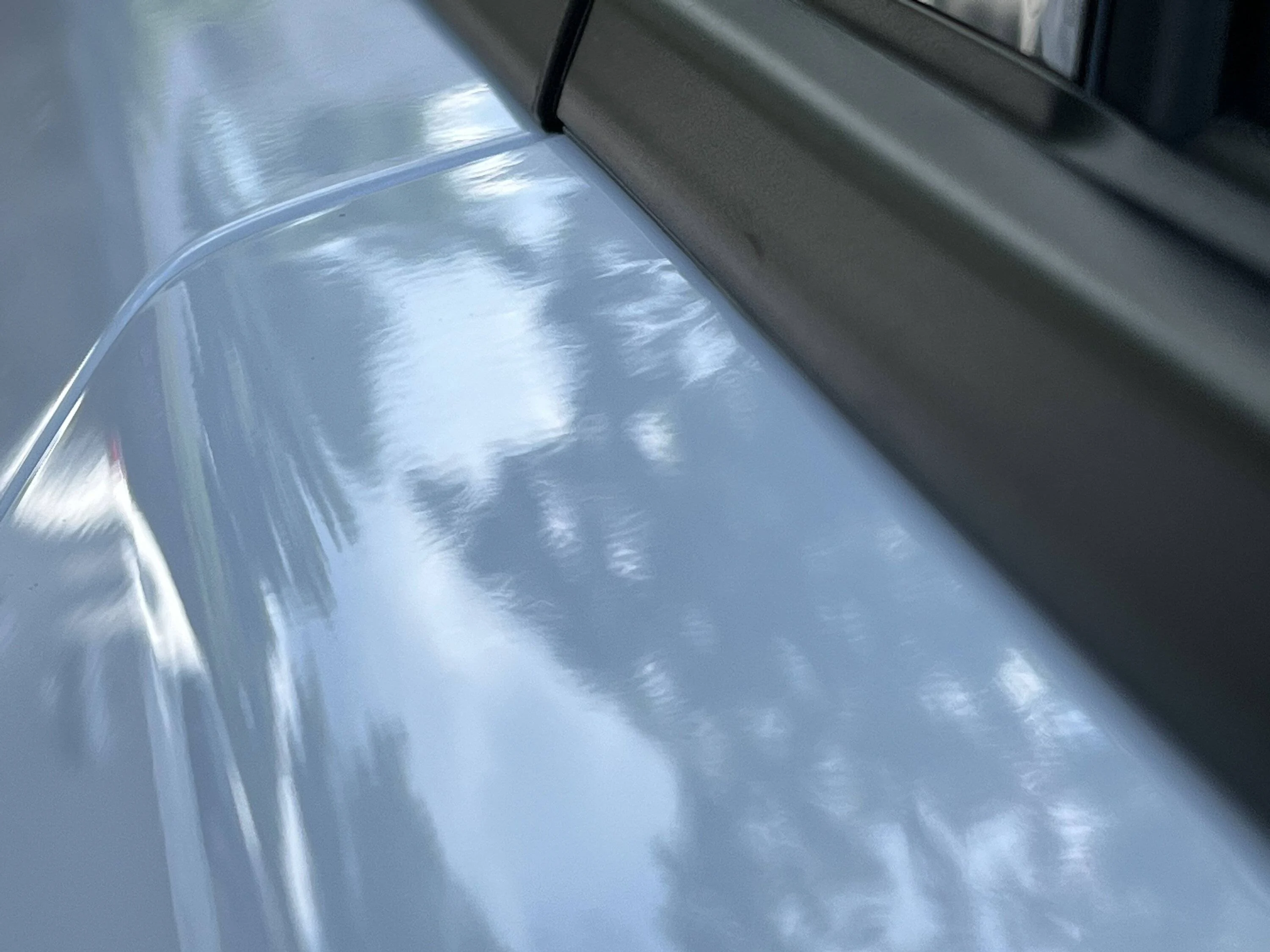

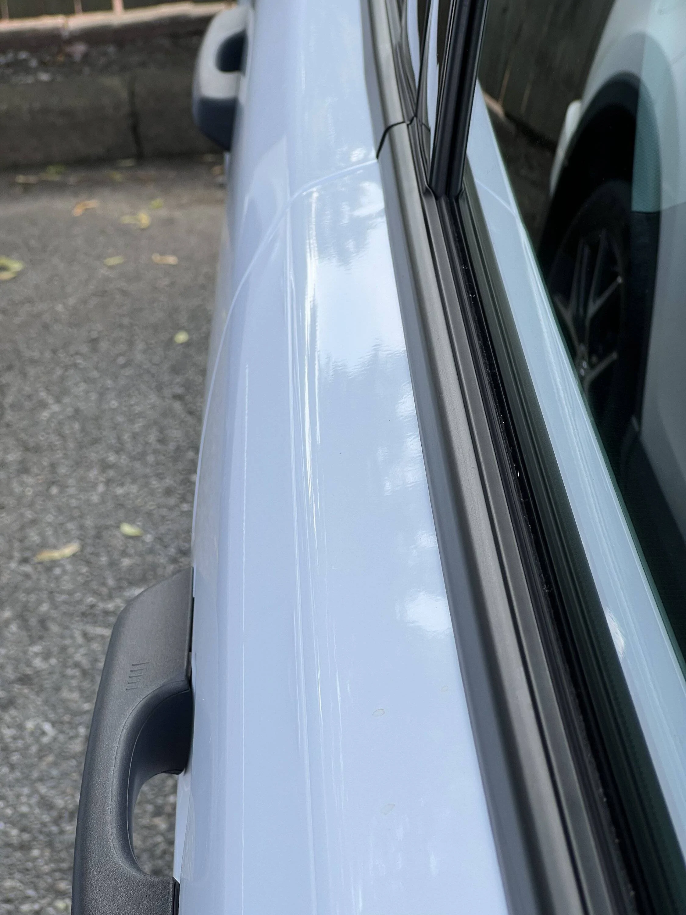

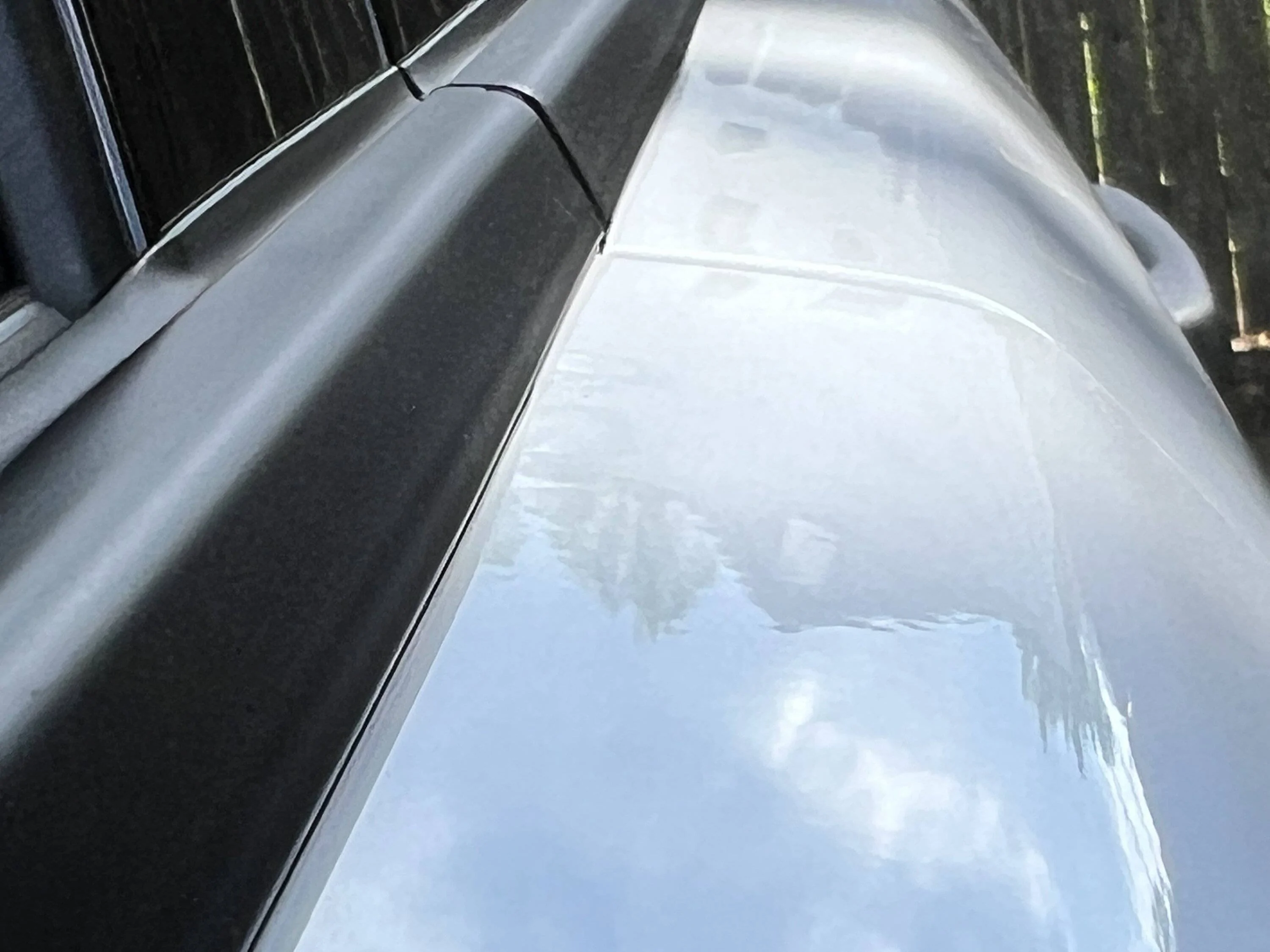

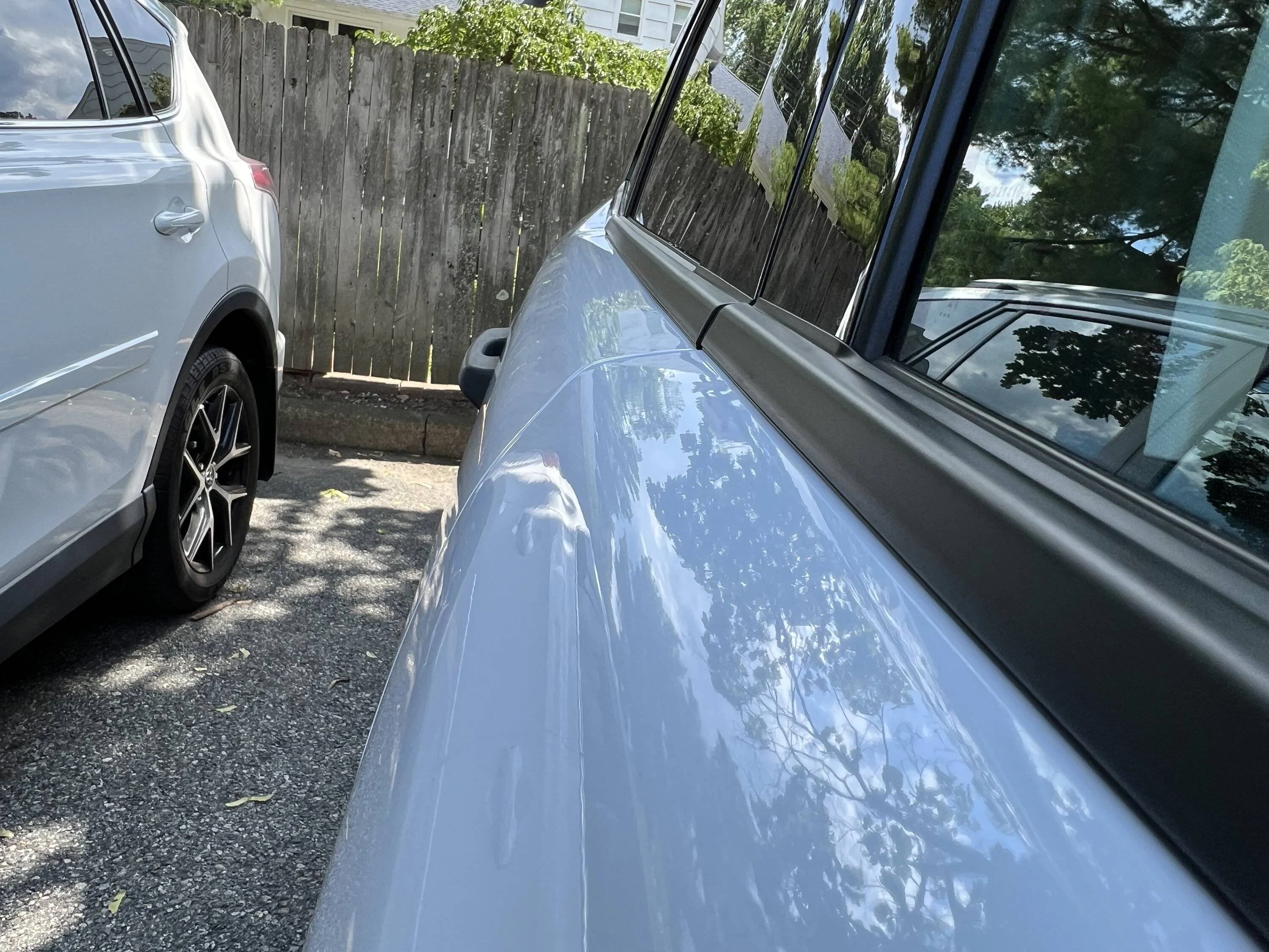

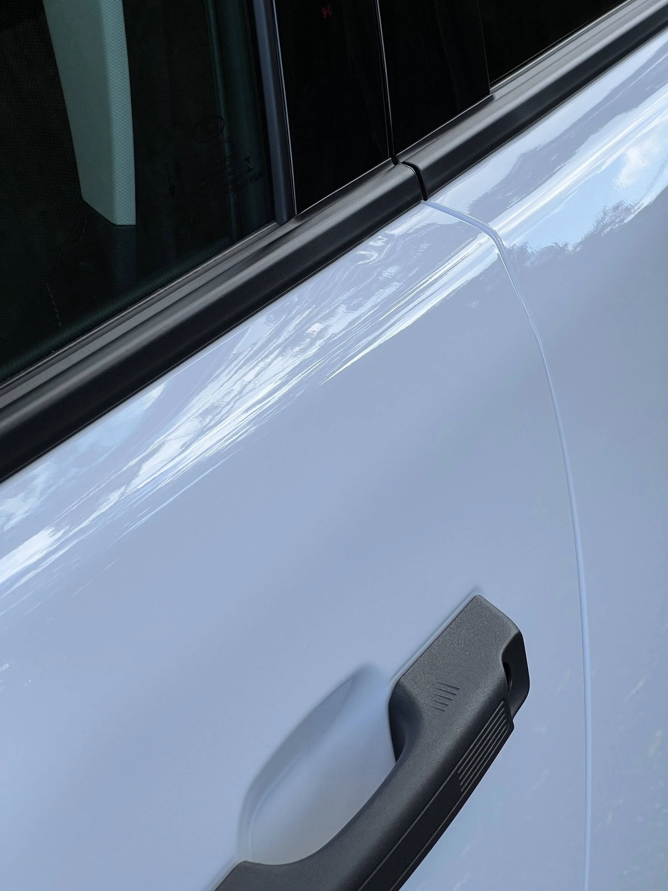

  • ‘Dimples’ running across door panel window ledges. Do not know how these doors were manufactured or assembled but looks similar to overtightening (see pic).

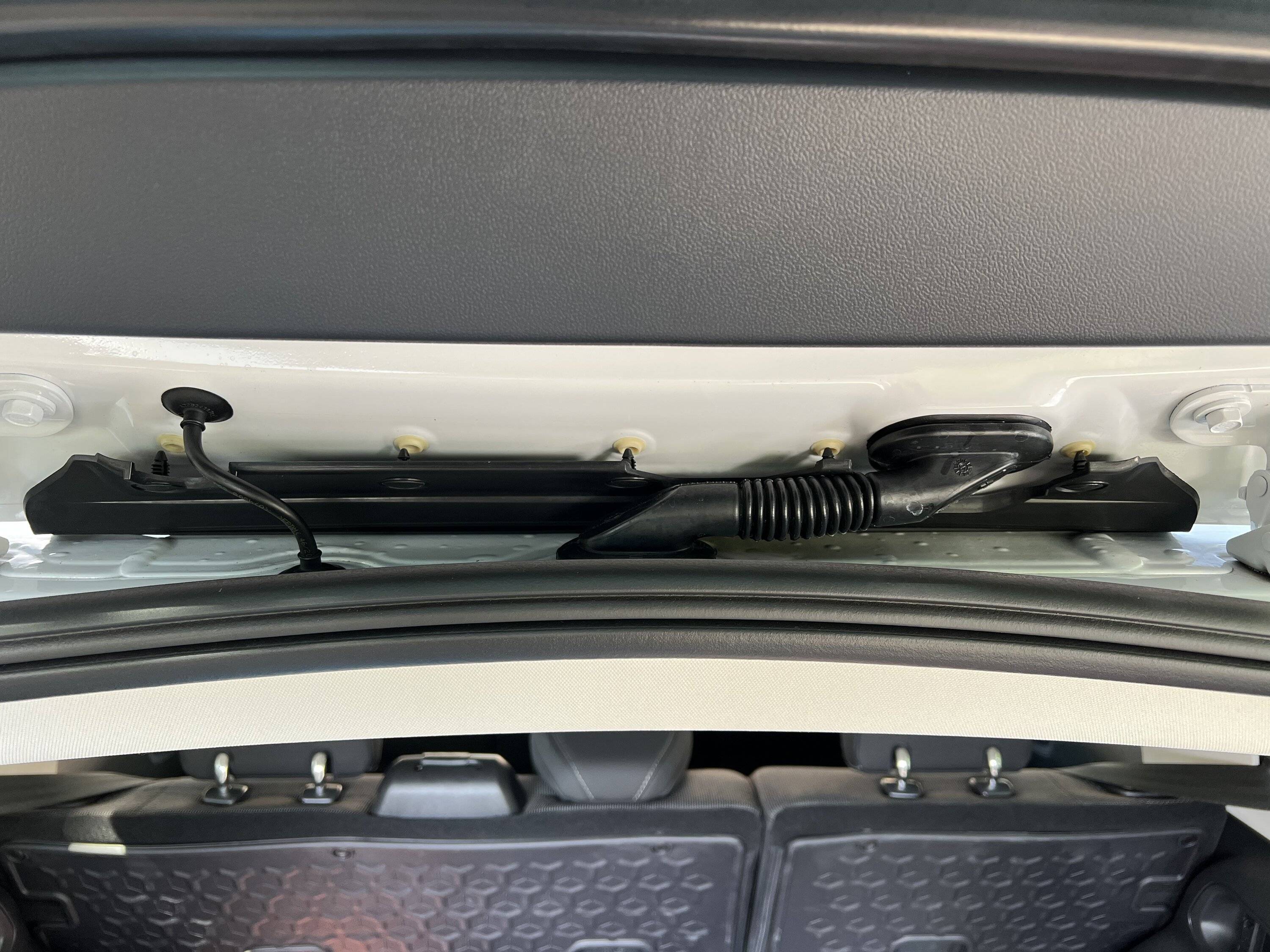

  • Rear liftgate wire harness “beauty plate” pops out every time liftgate is closed (see pic).

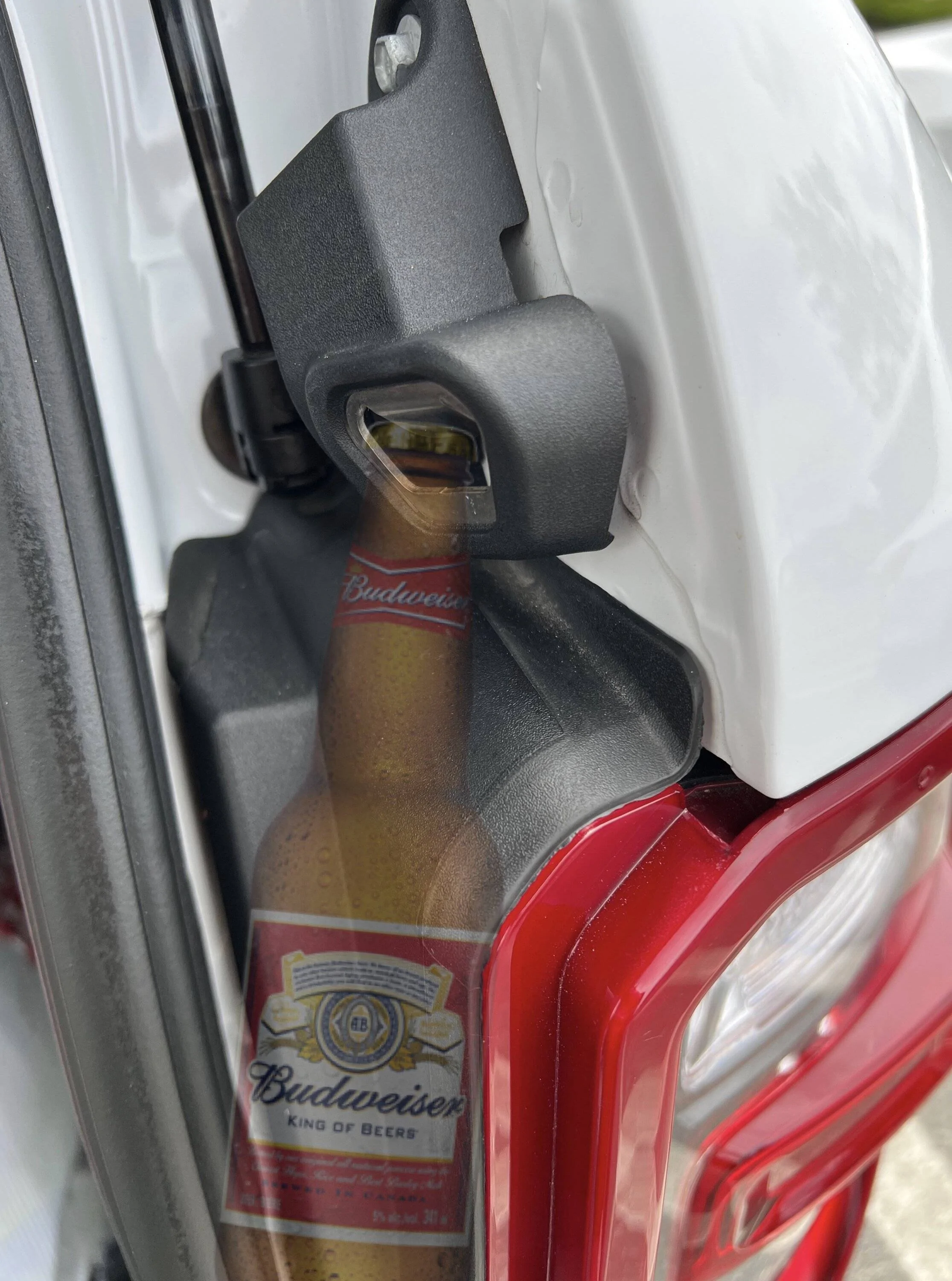

  • A minor gripe is that the integrated bottle opener has incorrect dimensions. Angle of bottle opener does not lineup with the angle of the bottle. Almost impossible to use when opening various 8oz bottles. Tailgaters simply used the seatbelt locking latch plate to remove the bottle caps (see pic).

Can you take a pic further back with the ripples in the door? Is it both sides? Eco mode is like that since it reduces throttle input. The bottle opener you tip the bottle up

Yes, its on both sides. I will take additional photos. If you zoom in, you can see the divots. Also, I am pretty sure we were using the opener correctly.

I believe the ripples on the top of the doors is from when the panel was stamped and quality control just waived it through. You are not the first to complain about that issue. One person on this forum tried to have dealer fix the ripples and dealer said they were normal and wouldn't do anything.

The ripples are crazy. Looks like it was dropped and then wrinkled the sheet metal. My opener looks the same. Had to go out and look. Your rear hatch latch probs needs to be adjusted to catch better.
Honestly, it looks to me like an installation issue. The sheet metal used for newer cars is far thinner than older cars, and it's really easy to make a dent. Given these ripples look different from car to car, my guess is the installation procedure for either the door panel or the window trim piece requires pressing on the sheet metal in that area, and the installer pushed hard enough to make a dent.
This is the reason I recommend not pushing down on the hood when closing to latch it. Let it drop from a foot or so and it will latch on its own. If you have installed gas struts then push very carefully on the bend in the metal where it curves down in the front. The bend will be more rigid than the flat part, making it more dent resistant.

I tried to take more pictures of the ripples. Sun and reflection make it difficult. If you zoom in, you can see the indents.
Replaced the front left splash guard. These front splash guards screws keep loosening. Also, the rear tailgate wire harness cover keeps popping out. On a different note, I took my vehicle to the Ford dealership in the body shop manager agreed that the ripples on the door panels are a defect in materials and or workmanship. I can’t imagine a Ford district manager, denying such a claim or request for repair. My concern is tearing the car apart, and having those panels repainted. I think I can live with the dimples, but it’s a matter of principal that Ford would let out this type of garbage to the public.
