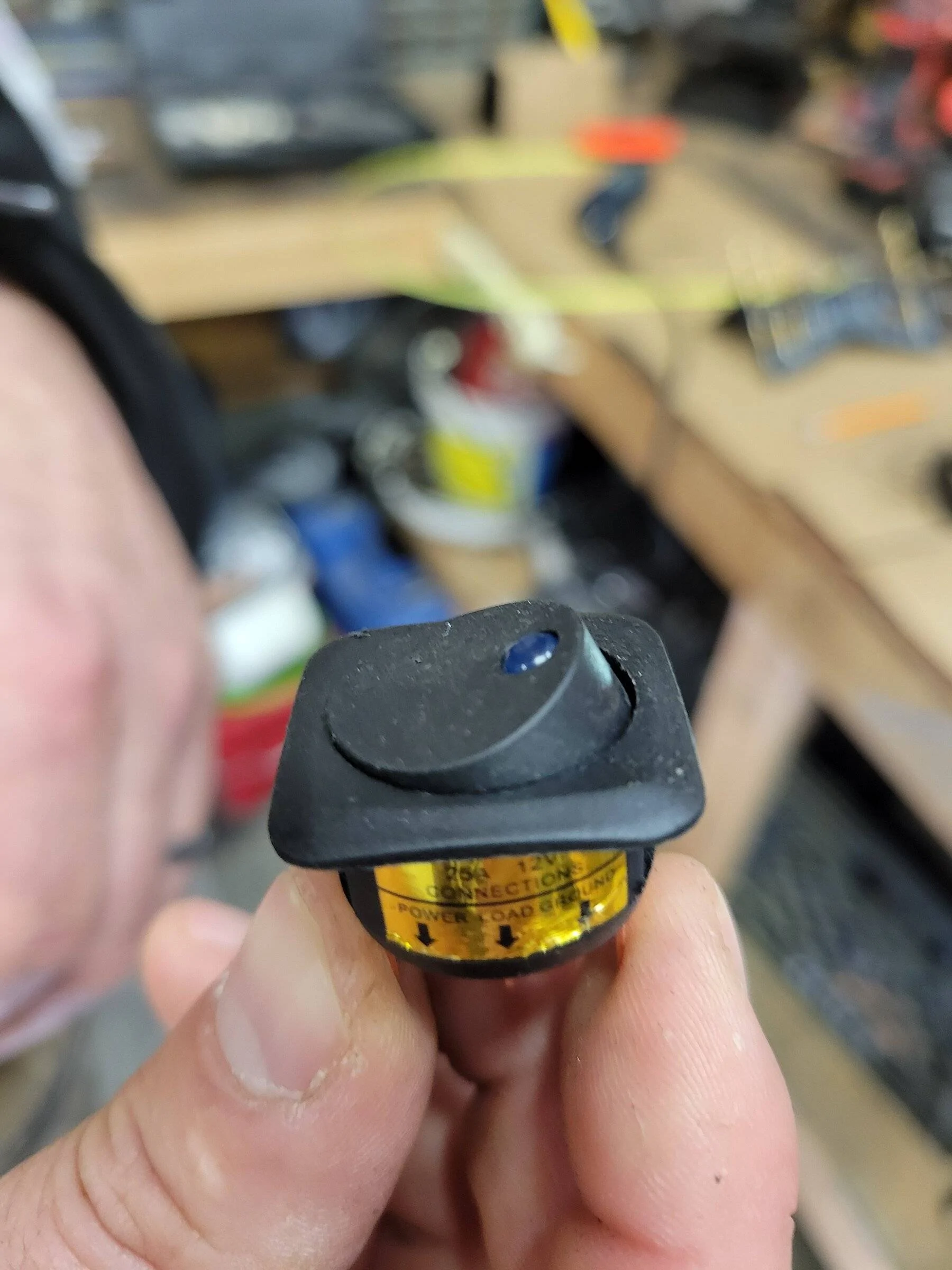

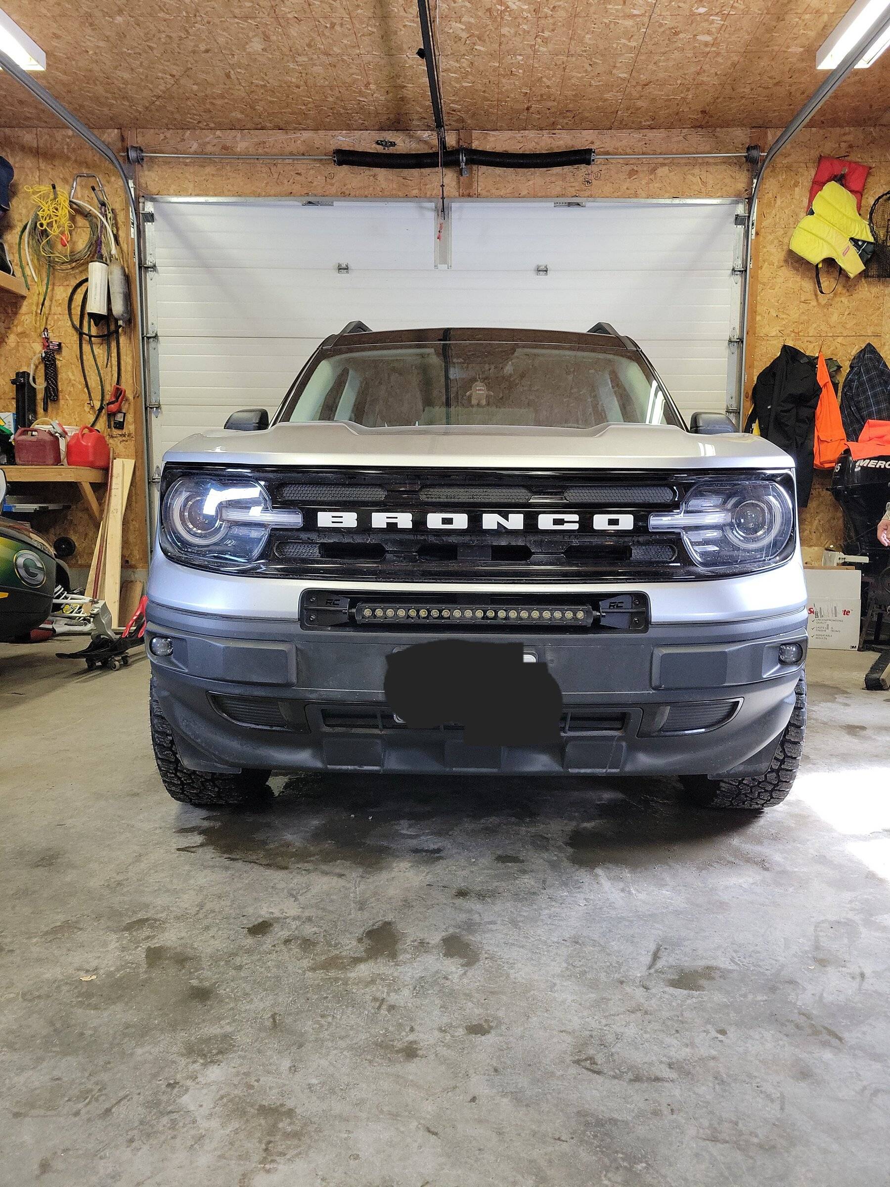

I installed Rough Country's 20" grill light bar and it turned out awesome, my only negative thing was the switch it came with, you're gonna wanna buy after market. Also rough country has the 40" light bar that goes on the roof rails, but it is rivited in and people dont like that part, but i am not paying $1100 for a light bar. Hope that helps.

This doesnt mess with the lane sensors/collision detection does it? I didn't get 360+ but not sure if the non upgrade safety features are sensed from the same position. I love the look of this light bar but don't want to impede safety features.
Also, which version of the lights did you get? The website is not clear on differences and the pics/videos all look the same no matter what option you choose.

Hey, no it does not mess with any of the vehicles safety, it comes with its own relay and inline fuse. As for the version... it's rough countries 20" grill light bar. Hope that helps.

Thank you I am definitely gonna get one of these. I was asking version wise about the type of lights. Mostly just don't understand the pros/cons of getting DRLs for an extra $30.
