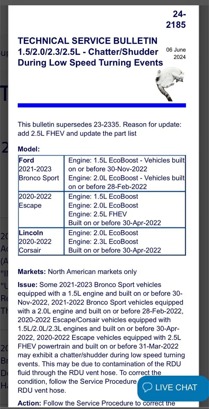

I had to pay ZERO for this TSB to be performed under warranty. Neither should you.
