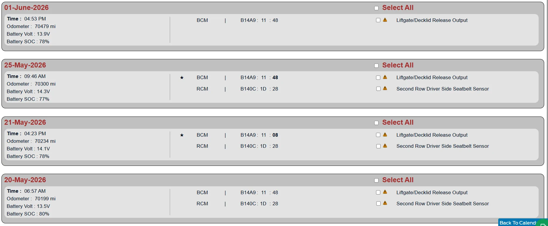

Do you have any kind of code scanner? If not and if the vehicle is connected to the Ford app, message me the VIN so I can pull the codes it is reporting. It could be a bad GSM (gear shift module).
rugedraw
Javier
Jul 13, 2025
536
1,028
Miami, FL
Got your message, but responding here for the sake of the info being out there. In your case, the vehicle has not reported any codes related to your concern. These are the only codes in the cloud, and all these are stored codes and not active faults that you need to be concerned about. Codes are stored for 90 days at a time, and I don't see anything related to the shifter, transmission or powertrain in the history that can be an contributing factor to the shifter not coming out of park.
Ford Bronco Sport 2021 Bronco Sport Badlands - will not shift out of park - intermittent 1780504759922-qm
Sorry, but in this case, I am not able to provide anything concrete, but it could be the GSM is about to take a crap.
