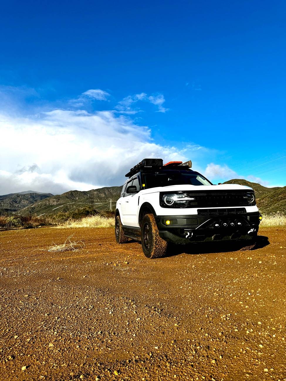

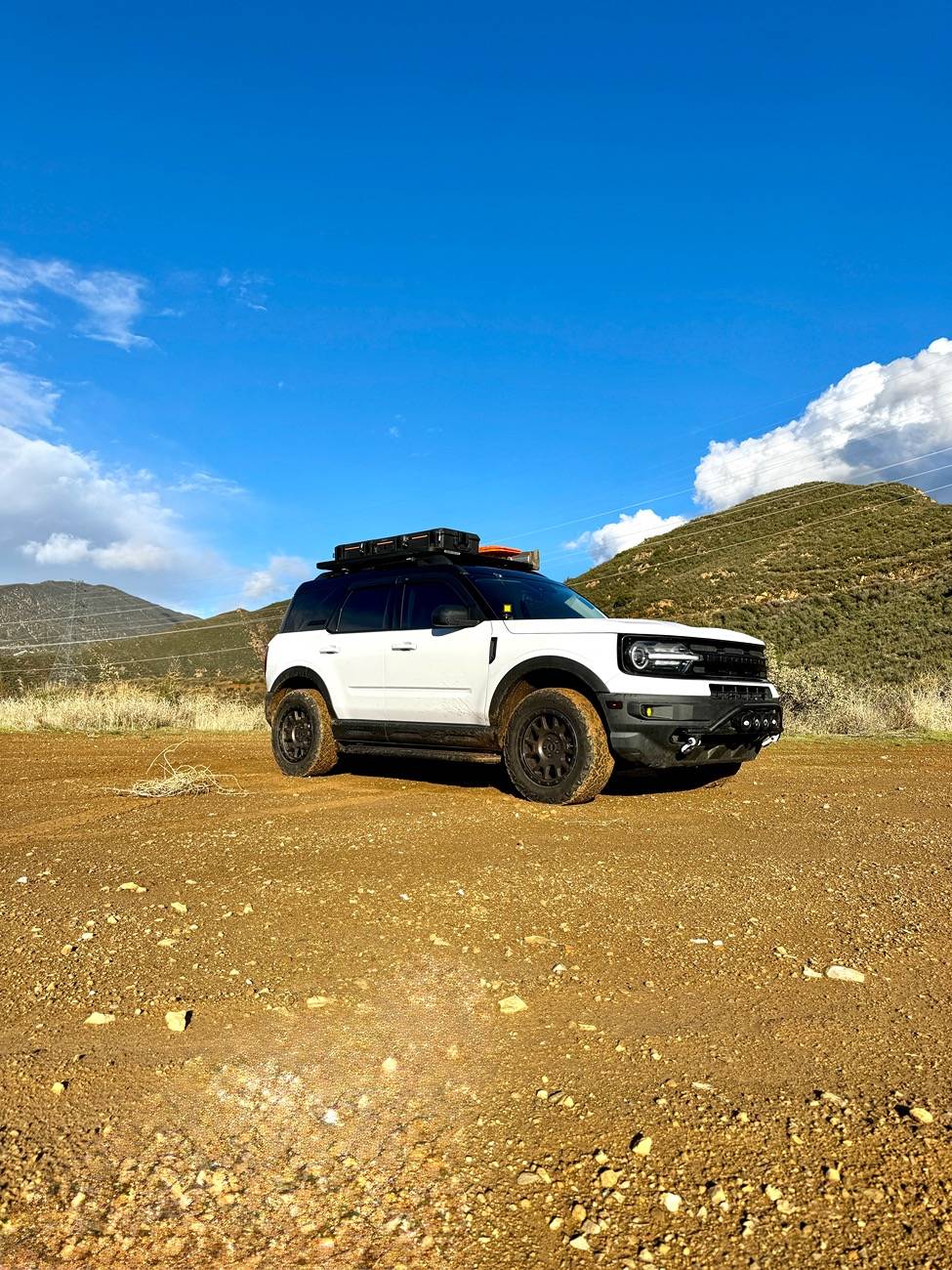

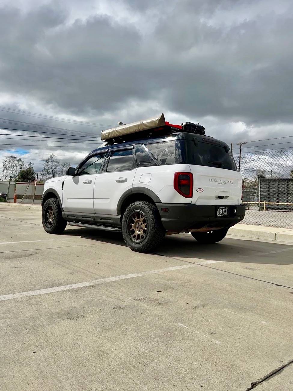

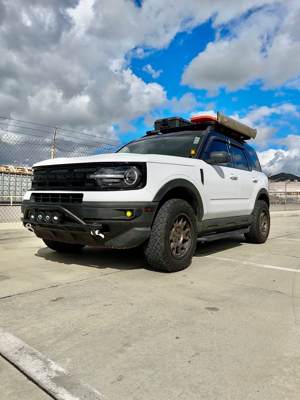

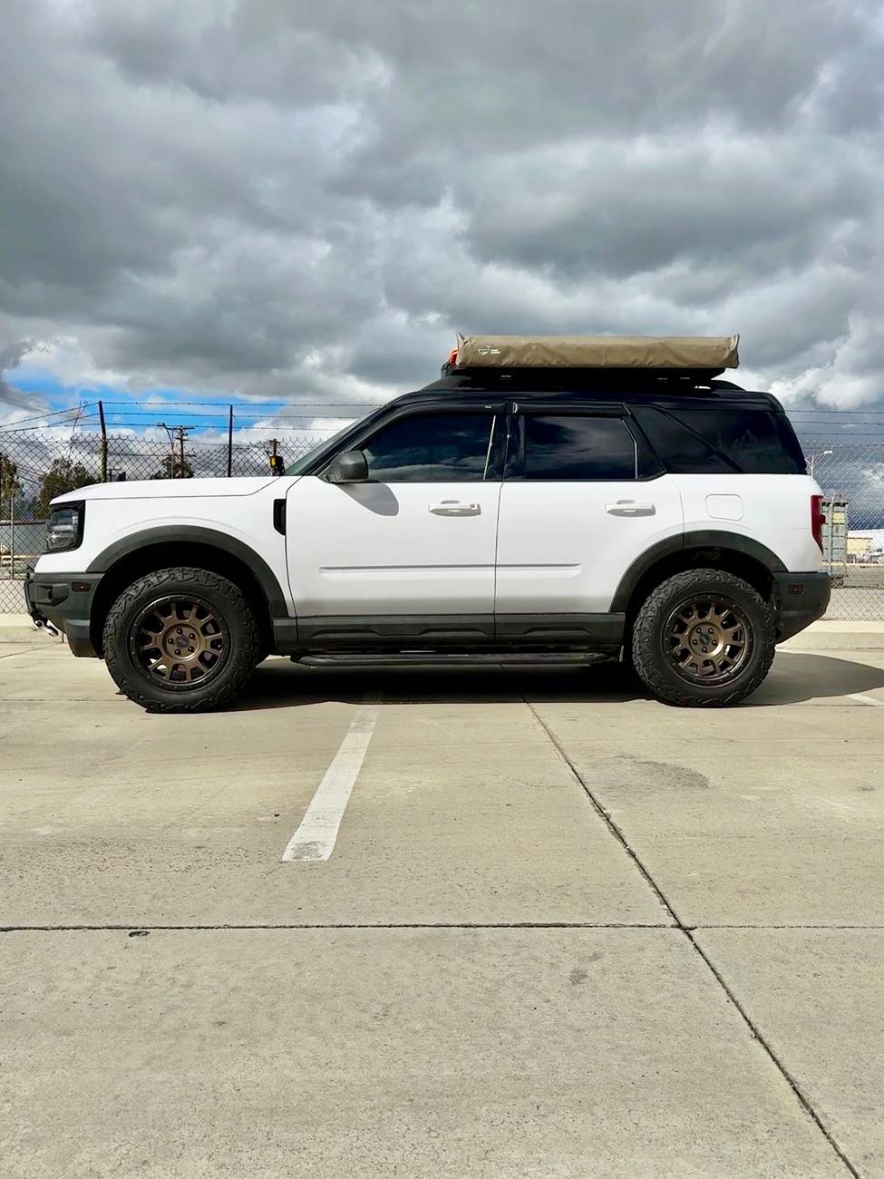

Installed the FordRangerLifts.com 2 1/4 lift kit. Very satisfied with the quality and overall look of this kit. Tire size is 245/65/17 which were installed prior to lift. I plan on upgrading to 255/75/17 with modifications down the line. But so far it drives great and performed well off-road. That little bit of extra clearance made a huge difference.

Looks nice! Seems like you lost a lot of breakover clearance with those sliders, is it possible to find a more integrated option?

With the lift installed, I would have had 11 inches of clearance under the door where the sliders are mounted. With them on, I get 9 inches—roughly back to stock height. Their main benefit is making roof access more convenient for loading my surfboard, kayak, and mounted accessories, plus I like the aesthetic. They’re not mounted in a way that I can see them protecting much if I really came down on them for ‘sliding’ purposes.
The downside is that they don’t provide extra clearance in that area and add weight, which contributes to my MPG loss. Right now, fuel efficiency is my biggest concern. Between the roof rack, steel light bar, cargo box, wheels and tires, lift, and sliders, the added weight is noticeable. I’m averaging 23 MPG on a good day, down from 28+.
Still undecided on whether I’ll keep the sliders, but so far, clearance hasn’t been an issue on the trails I run.

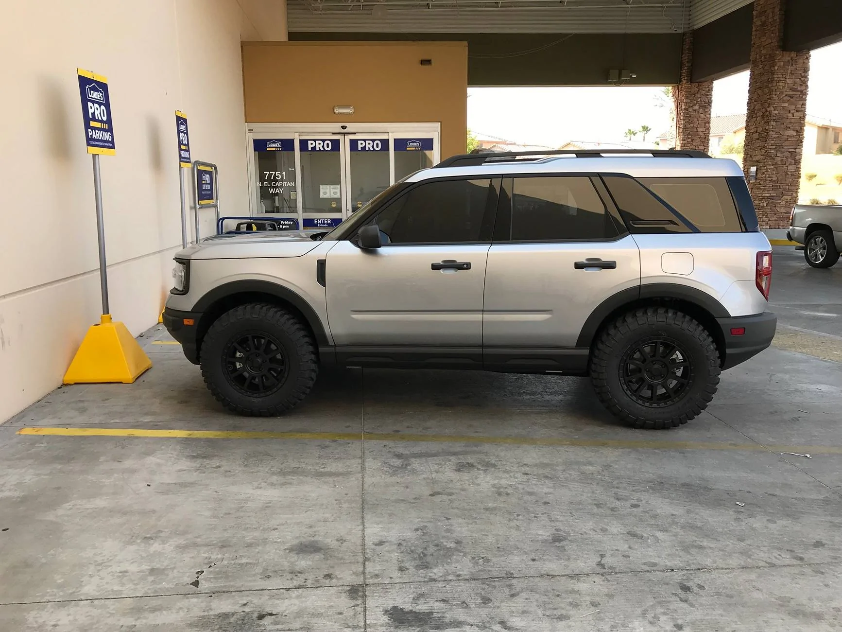

Realistically, the main purpose is for looks or holding lights. The original purpose of brushguards or bull bars was exactly as the name sounds. But the old school ones typically bolted directly to the frame of the vehicle. Given the fact these vehicles do not really have a frame per se, the main structural component is missing so they are best used for mounting off road lights.
This is from the Ranch Hands website.
