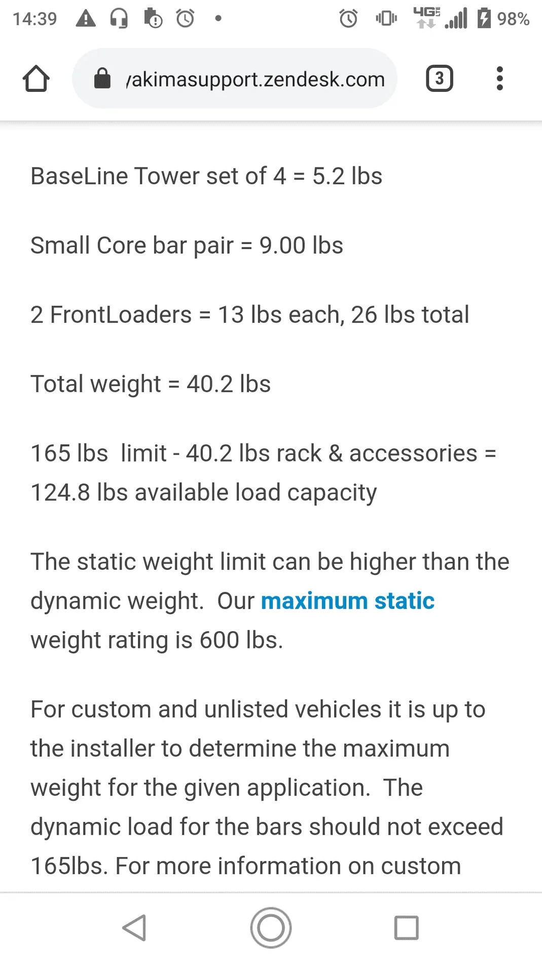

where do you think you're at into the 150# roof load limit?
The 150 limit is a joke there is three times that with the tent awning and two adults in the tent . I don't know where ford came up with that number

Dynamic load is the weight the vehicle can hold while moving. Static load is the weight the vehicle can hold when not moving.
