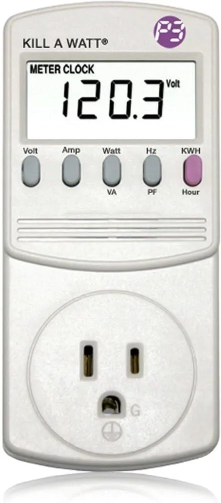

One way to determine actual usage is with a Kill-A-Watt meter. They're pretty cheap. There are a couple different models, the base model works fine. They were tested by CR a while back and found to be very accurate:
https://www.amazon.com/P3-P4400-Electricity-Usage-Monitor/dp/B00009MDBU?th=1

The Kill-A-Watt meter (above) can display Power Factor (PF) which will indicate how reactive a load is.
Owner's manual (just one page):
https://www.powermeterstore.ca/pdfs/cache/www.powermeterstore.ca/p3_international/power_meter/p3_kw_ez/manual/p3_international_p3_kw_ez_power_meter_manual.pdf
P4400 Kill A Watt TM Operation Manual (There's more at the link)
1. The LCD shows all meter readings: Volts, Current, Watts, Frequency, Power Factor, and VA.
4. The Watt/VA Key is a toggle function key. Press the Watt/VA key once to display Watt meter, then press key to display VA meter. The LCD will display Watts as the active power, where VA is the apparent Power. (VA=Vrms Arms)
5. The HZ/PF is a toggle function key. Press the HZ/PF key once to display the frequency (Hertz), then press key to display the Power Factor.
So with a ~$30 Kill-A-Watt meter, any device can be checked before plugging it into an outlet in the BS. They are great for checking items around the house. They track watts over time, so they can be used for intermittent loads like fridges and window A/C units.
The meter will display amps, watts, and PF (among other things).
Ideally, the PF=1. If a load is reactive (what the BS manual warns about) the PF will be less than 1. The more reactive, the lower the PF. The following (from the BS manual) are reactive:

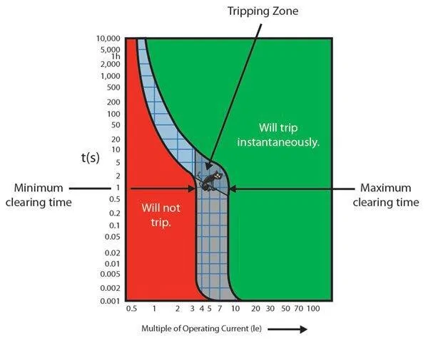

A quick initial surge of current might not be caught, but if it's that fast, it may not trip the breaker for the inverter. Breakers work by heat, so they typically handle more than their rating for a short time -- but often only ~80% of their rating indefinitely:
