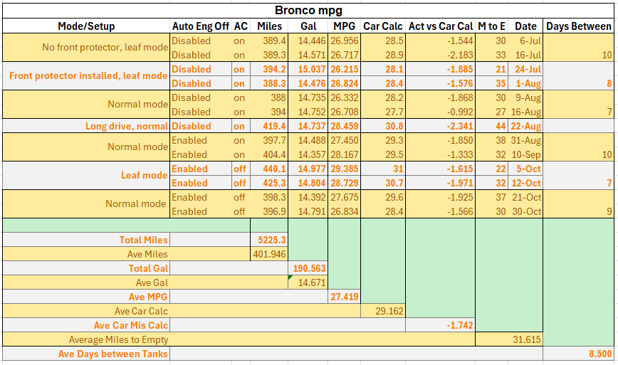

Good afternoon everyone,
I'm new here, so go easy on me, and wanted to share my BB 1.5L MPG that I have been logging for a bit.
One note worthy mention is the first two entries are without the aeroskin2 wing while rest of the listings include it. I read on here somewhere that after adding the aeroskin2 the users MPG went up which i thought was odd so I thought I would Log it.
Ford Bronco Sport 1.5L MPG data for a few weeks (2022 Bronco Sport Big Bend) 1762197774730-el
Enjoy the data it has been a fun ride. If you would like me to try out another combination just let me know.
If your interested in the data here is a copy and paste version.
Bronco mpg
Mode/SetupAuto Eng OffACMilesGalMPGCar CalcAct vs Car CalM to EDateDays Between
No front protector, leaf modeDisabledon
389.4​
14.446​
26.956​
28.5​
-1.544​
30​
6-Jul​
10​
Disabledon
389.3​
14.571​
26.717​
28.9​
-2.183​
33​
16-Jul​
Front protector installed, leaf modeDisabledon
394.2​
15.037​
26.215​
28.1​
-1.885​
21​
24-Jul​
8​
Disabledon
388.3​
14.476​
26.824​
28.4​
-1.576​
35​
1-Aug​
Normal modeDisabledon
388​
14.735​
26.332​
28.2​
-1.868​
30​
9-Aug​
7​
Disabledon
394​
14.752​
26.708​
27.7​
-0.992​
27​
16-Aug​
Long drive, normalDisabledon
419.4​
14.737​
28.459​
30.8​
-2.341​
44​
22-Aug​
Normal modeEnabledon
397.7​
14.488​
27.45​
29.3​
-1.85​
38​
31-Aug​
10​
Enabledon
404.4​
14.357​
28.167​
29.5​
-1.333​
32​
10-Sep​
Leaf modeEnabledoff
440.1​
14.977​
29.385​
31​
-1.615​
22​
5-Oct​
7​
Enabledoff
425.3​
14.804​
28.729​
30.7​
-1.971​
32​
12-Oct​
Normal mode Enabledoff
398.3​
14.392​
27.675​
29.6​
-1.925​
37​
21-Oct​
9​
Enabledoff
396.9​
14.791​
26.834​
28.4​
-1.566​
30​
30-Oct​
Total Miles
5225.3​
Ave Miles
401.946​
Total Gal
190.563​
Ave Gal
14.671​
Ave MPG
27.419​
Ave Car Calc
29.162​
Ave Car Mis Calc
-1.742​
Average Miles to Empty
31.615​
Ave Days between Tanks
8.5​

I never worry about mpg unless they are orders of magnitude different. There are so many variables that affect outcome - temperature, course, wind, traffic, lights, differences in quality of gas, etc. I remember years ago Mythbusters tried testing and they used a one gallon gas container with the same gas, over the same close circuit track, with the same driver and same weather conditions. Then they tried switching individual conditions. That is probably the closest accurate way of testing.

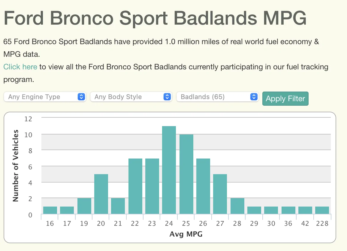

Tracking mpg is useful, as it can help you spot potential issues. However, I find it's easier to use something like fuelly vs a spreadsheet. You can enter notes and other info, plus see what mpg others have. And it's free :cool:

fully agree on that for sure!
I did however drive the same route each day (home to work)
I purchased the same gas from the same station
The outside temp was generally the same
I left the internal temp set at 72f steady until it cold lol
I always used cruise control set at the speed limit even in city, oh fun fact you can cruise at 20mph in a school zone lol.
ya but all and all it appears to really not matter a whole lot. But I'm a control engineer by trade so I had to write all this down and put it on paper to believe it lol.

fuelly, i will give it a shot many thanks for sharing.
if the graph is for my bronco i guess im one of the few who get 28/29 ish lol. i guess the 1.5L doesn't waste a lot and I don't drive overly crazy!
thanks nice find!
